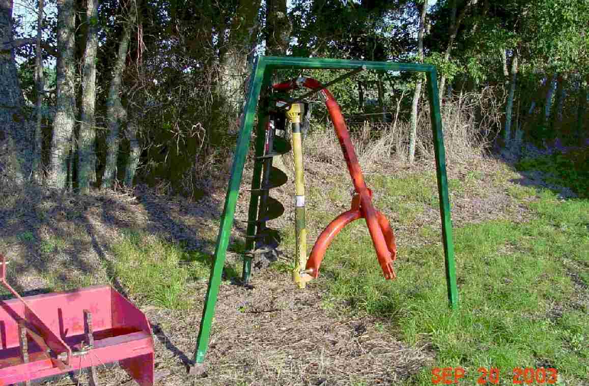

Mr Jimi, thanks for the complement, it is very simple, cost effective, and actually compact storage.
Tom Veatch, you are correct. Hitch up, raise phd, remove 4x4 and drive away.
73Jeep, that is the largest phd that Land Pride makes, rated at 75 pto hp, it has been hanging on that 4x4 for about 20 months now.
AndyMa, my 7520 hitches right up at that height. your TN75 should be about that height also.
Now all I need to do is find a way to store the 4 other sized bits.:)
   / Storing 3PH post-hole digger #12
Tom_Veatch said:
Doesn't look like there are any bolts holding the cross piece, so I'd guess it's back up, hook up, lift, pull the cross piece, drive away.
Tom I suppose that's a possibility, however none of my tractors including a Cat II TN 3pt hitches will go anywhere near that high. The only way I could get it down is with a loader.
BTW, mine is apart and I just manually hook up gear box and then attach auger. I suppose it I used it more I woulod build a nice rack, but it would have to hold it at "normal" 3pt hitch heights.
Andy
   / Storing 3PH post-hole digger #13
AndyMa, I guess that the picture is deceiving. The 3ph lower bars need to be about 24" at the ball ends to hitch up. Plus the phd is balanced as it hangs there and pushes down very easy. Hope that is clear now.:)

I think the perspective in the picture is misleading. Notice the point of the auger is not that far off the ground. My Cat 1 3pt will lift my PHD auger higher than that. True, when you pull the near end of the boom in the picture down to connect it, the auger ground clearance will increase but not all that much.
Also, notice the rear blade in the picture's foreground. If you project the top of the blade's boom back toward the PHD, it doesn't seem to be very much below the PHD's 3pt pins.
And they say "pictures don't lie". Maybe so, but they sure can obscure the truth.;)

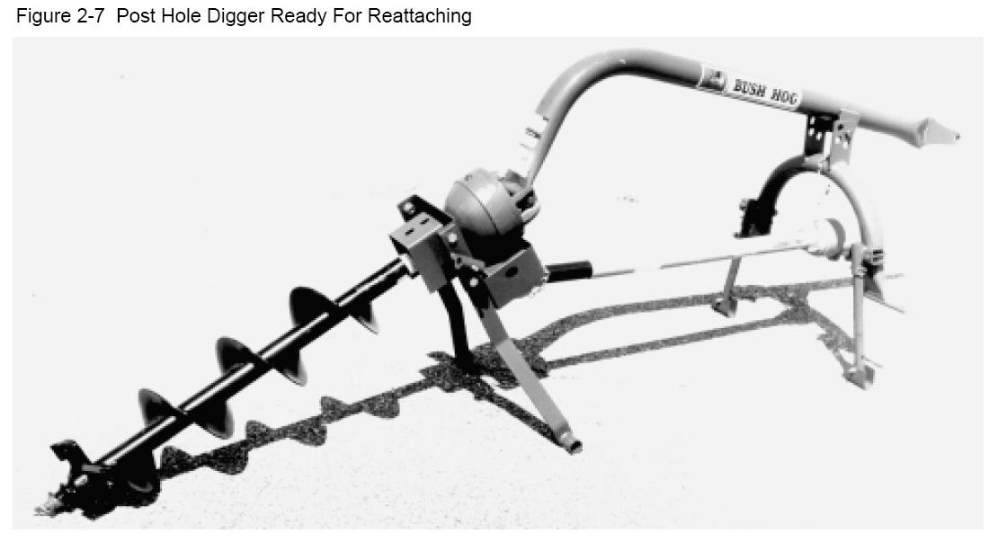

I have attached a few pictures of the optional Bush Hog stand from their manual. It seems like it would be easy to modify any PHD with a similar stand.
Here are a few other storage stands that I have seen around. These are basic yet functional. Very easy to make as well.
BEFCO PHD with Storage Stand
Howse PHD with Storage Stand

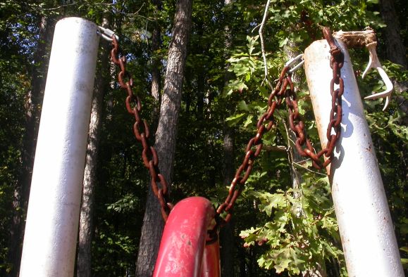

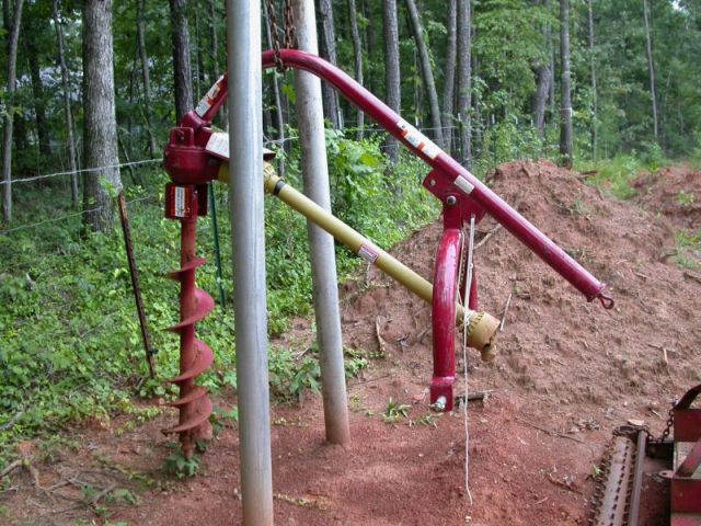

Here is one I made from 2" sq tubing. A little hard to see from tha angle, but it is a 3 legged stand with a tube running from the center of the front cross member to the rear leg. PHD is hanging with a piece of plastic coated chain.

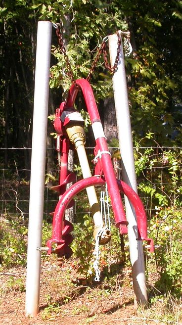

This is what I built. Makes the hook up fast, easy and NOT awkward. Sorry for the fuzzy picture quality...
