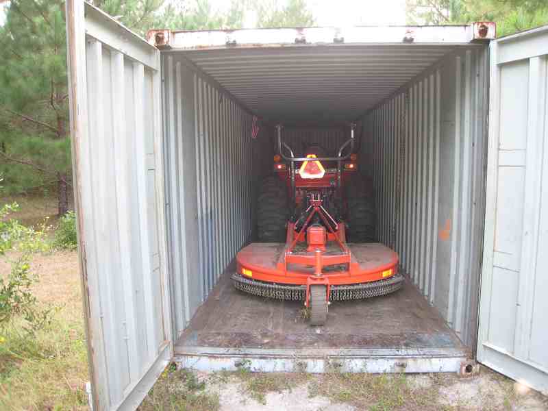

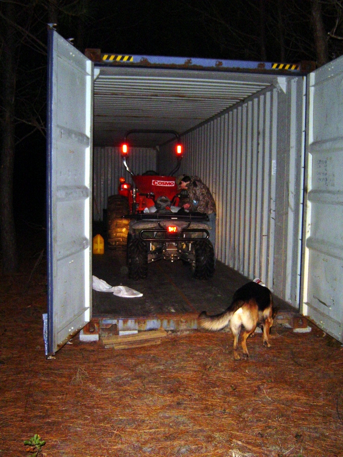

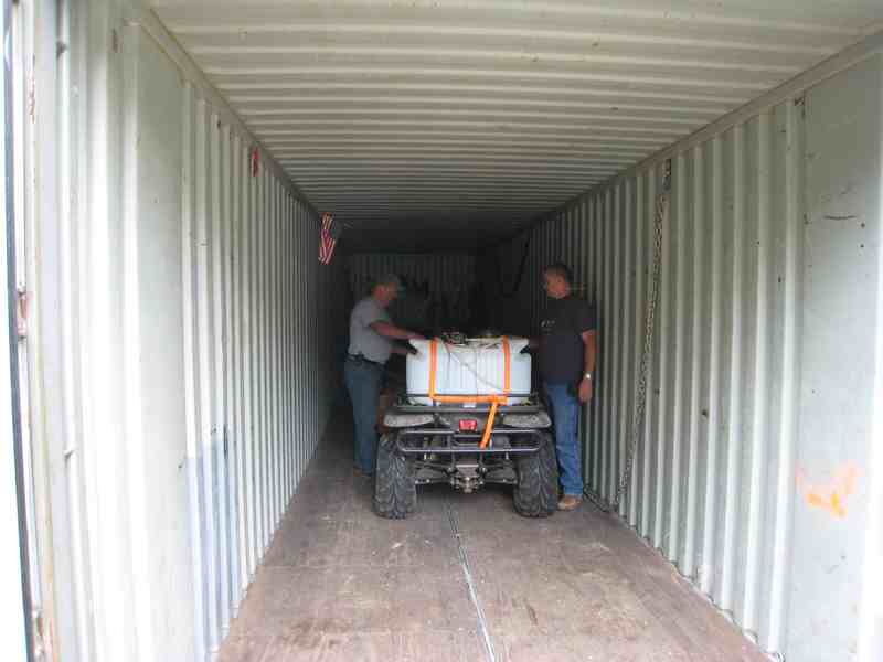

I have a 40' high cube sea container and the High Cube is a must to get the B26 inside. The standard height won't work.
   / Storing a B26 in a sea container #9
Wow, I thought it would have fit for sure, thanks for the pics.
   / Storing a B26 in a sea container #10
I bought the standard container and later bought another high cube. Pictures are of my tractor in old and high cube. Note ropes down in standard container
