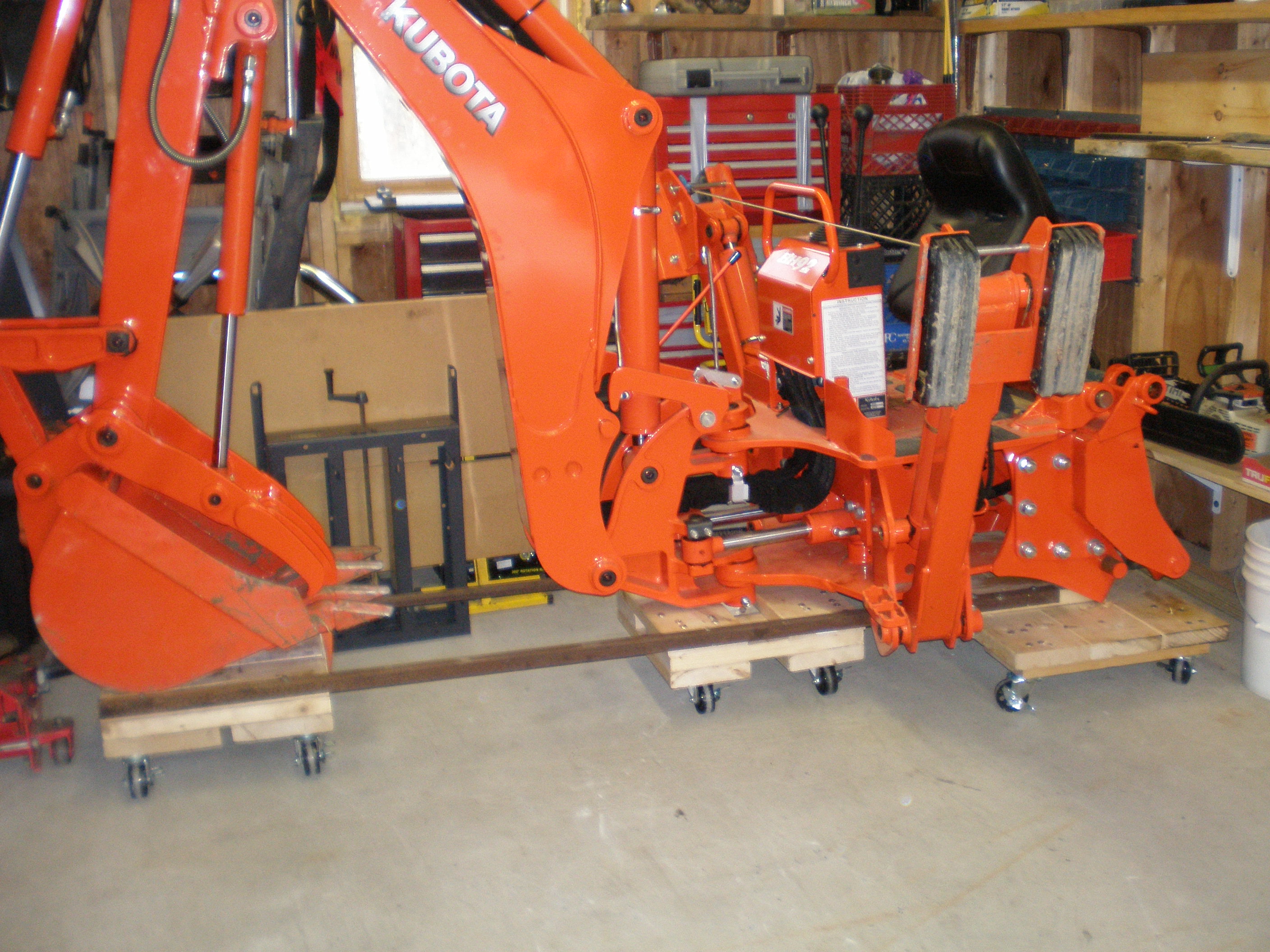

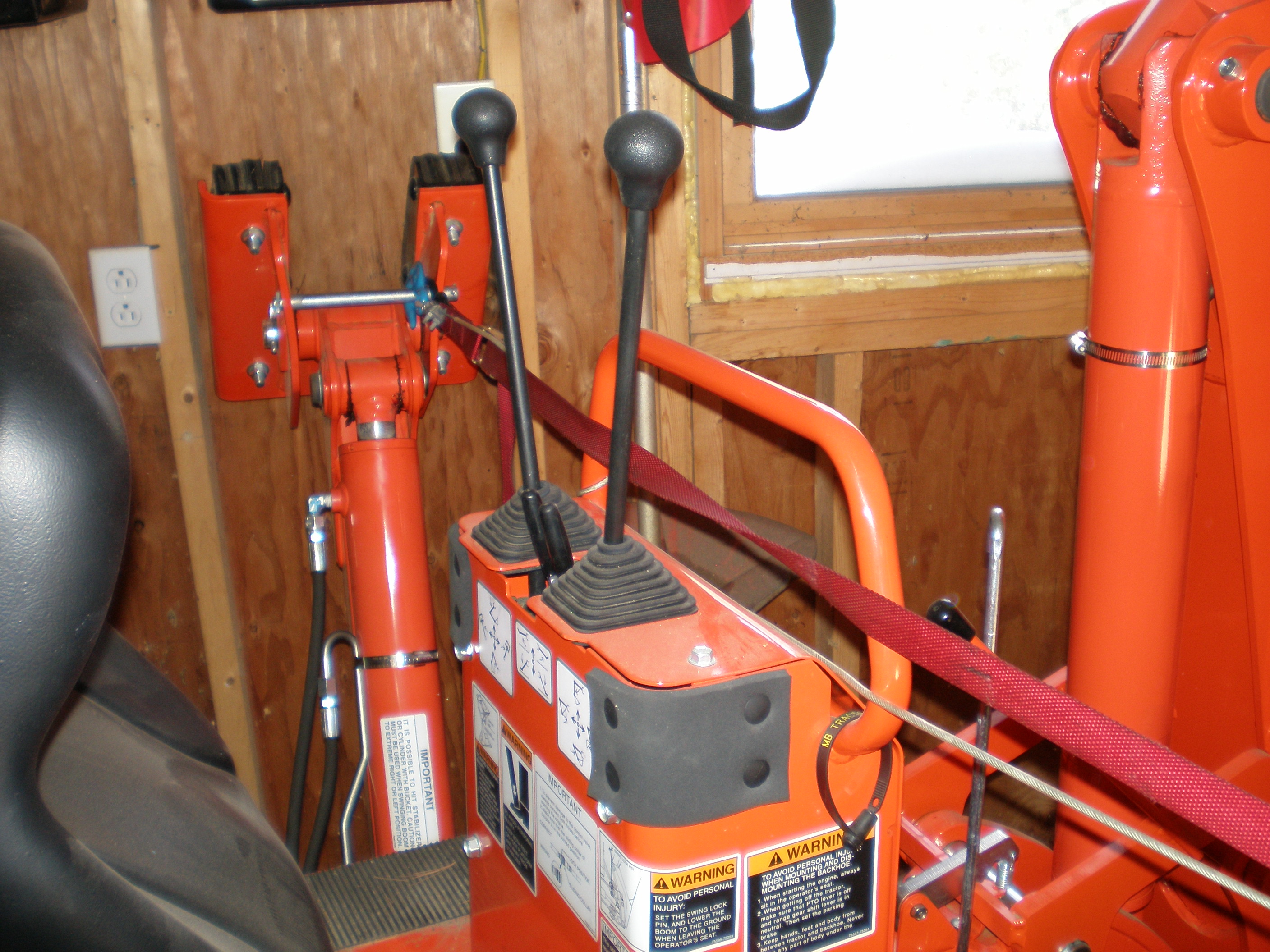

I have a Kubota L3560HSTC with a BH92 backhoe, I always store mine inside the barn on a dolly I made. I prevent "sag" of the out-riggers by hooking them together with a tie-down ratchet strap. P1050002.JPGPB260001.JPG

A dolly is wonderful. I have the BXpanded one but you could easily build one. Regardless, having flat ground to store and reinstall it will save you some real headaches. Being able to roll it around is the icing on the top.
