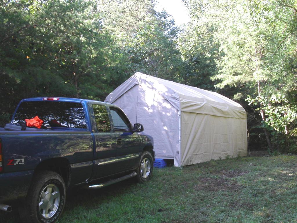

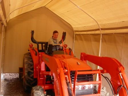

I use two of the tarp carports from Costco, one for a hay barn and one for the tractor. Paid about $180 each for em. The hay barn has been up for 5 years in full sun and we finally had to replace the top tarp this spring. Sides and ends are still fine. Replacement top was about $75. The tractor barn has been up for 3+ years. No problem except for a few little tree branch holes. Keeps the sun and rain/snow off. One end is a zippered door, and you do have to fold the ROPS to get it in. Two tips: 1) you absolutely MUST anchor them down well as others have mentioned; 2) Assembly is WAY easier if you start with a LEVEL spot! I used anchor kits from Lowes ($25) consisting of 4 ground augers, one for each corner, plus steel cable and turnbuckles from each anchor looped over the top of the frame for wind resistance. Cheap and effective.

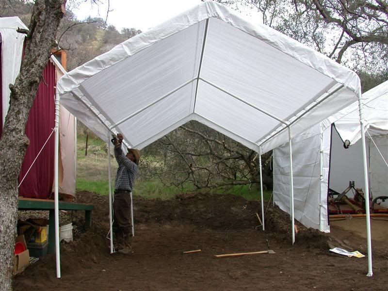

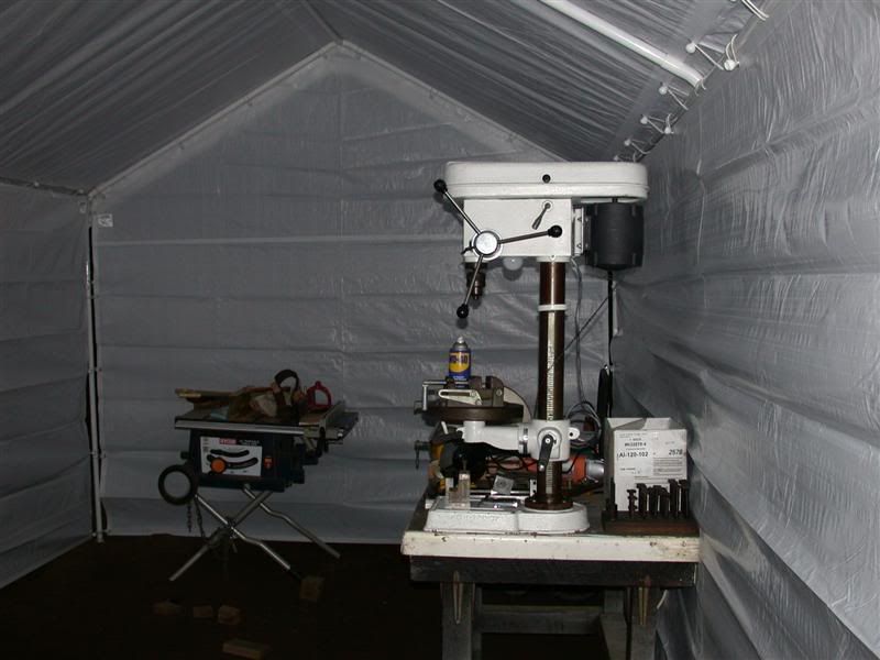

last year I got a 10X20 from SAM's club for about $200 - and it survived a Kansas summer fine - including a couple of "fun" storms. We used it for a tractor shed and also to set up power tools while building the house. That price included side walls with windows, ends, and doors. There was no sign of damage when we took it down in the fall.
In the most recent Harbor Freight flier I got they were advertising a 20X20 canopy without side walls for $150. No idea what their tarp quality is on that, but it's tempting.
