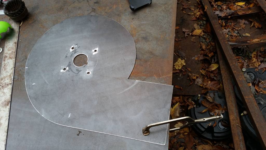

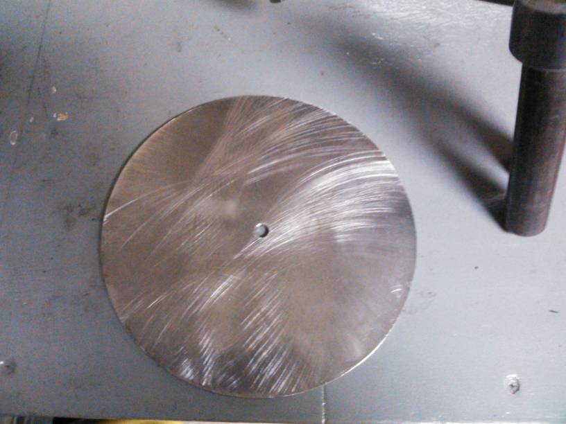

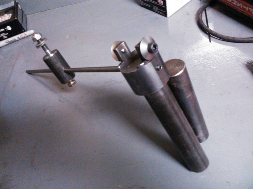

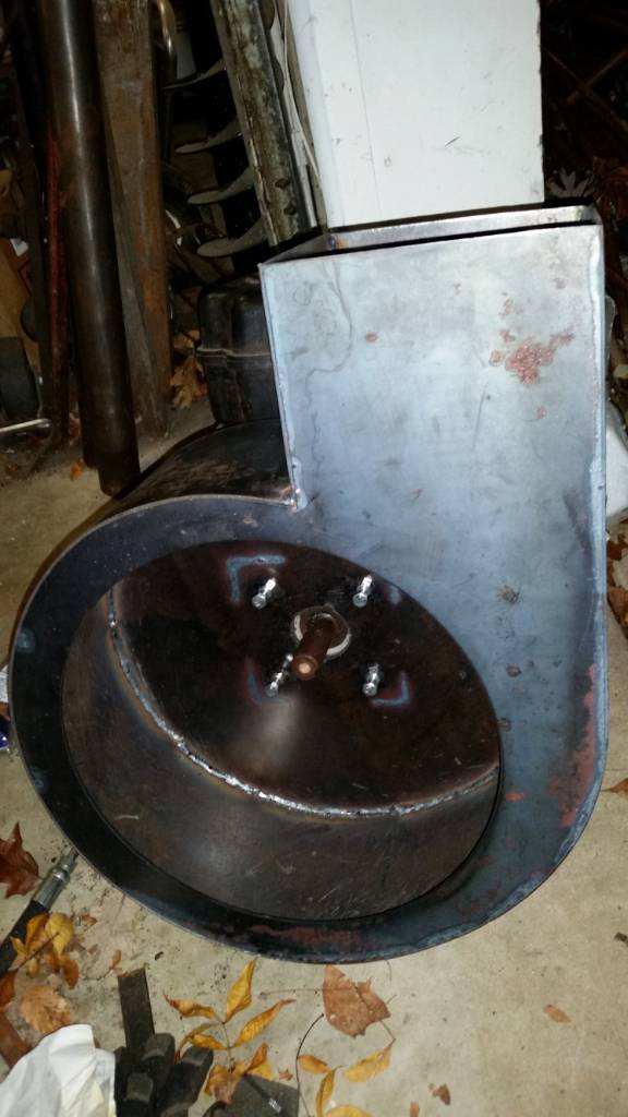

I made a circle cutting attachment about 7 years ago to cut out 16 disc to make my core aerator. 761114051.jpeg 968950337.jpeg Never thought of using the wheeled portion for a guide.
The circle cutter also helped make the blower housing for my leaf vac.470520122.jpeg It comes in pretty handy.601635588.jpeg

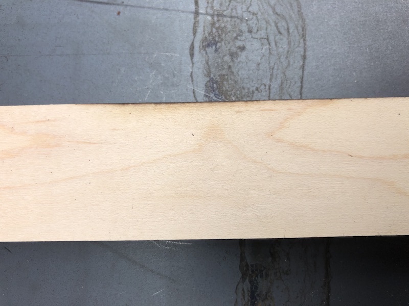

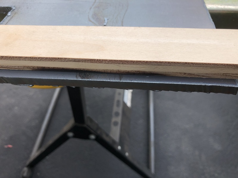

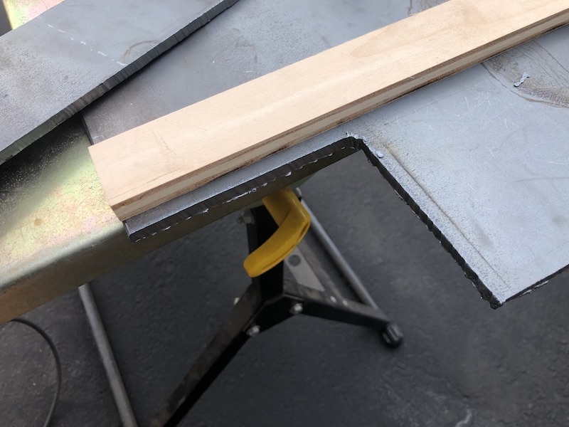

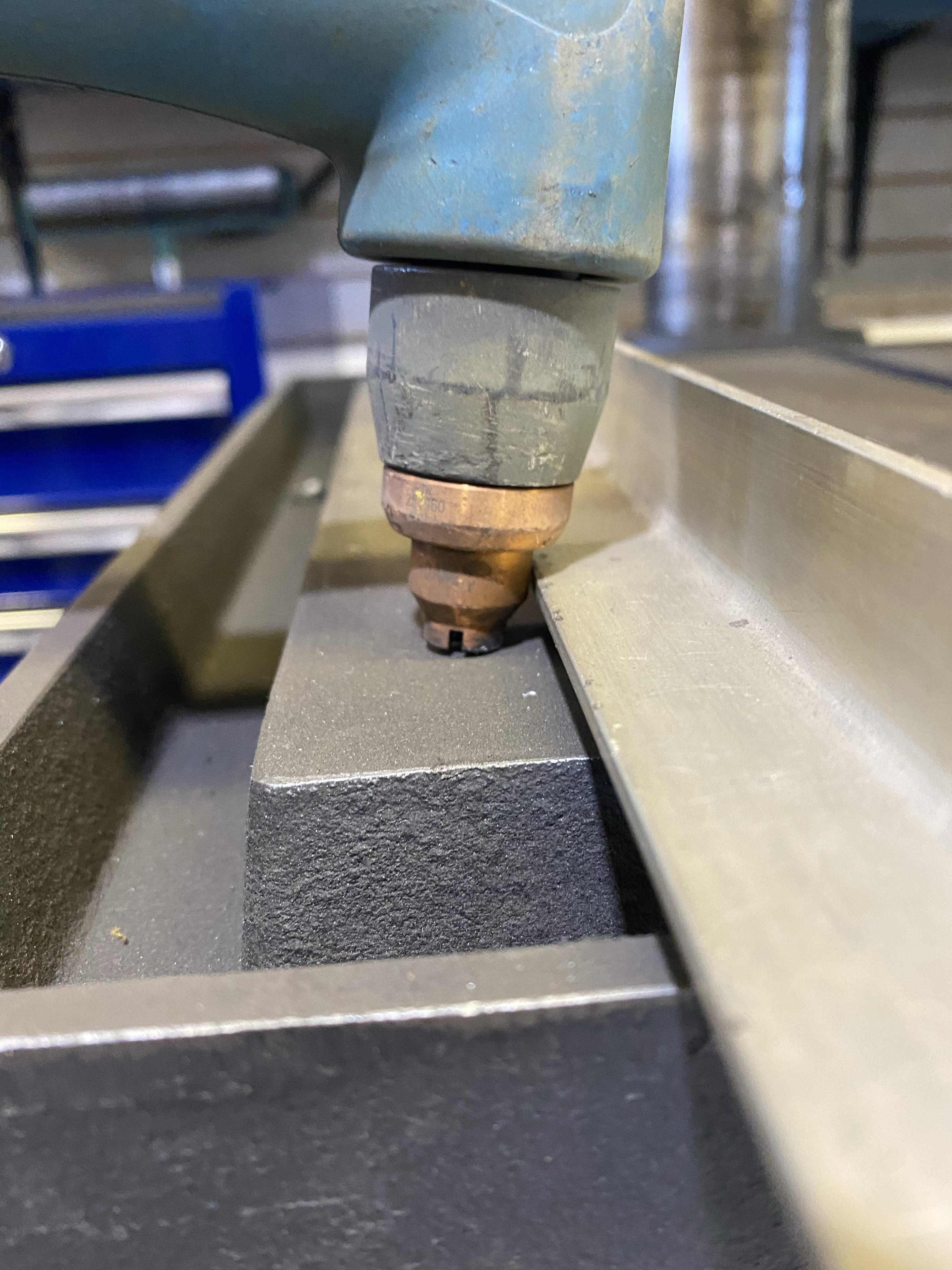

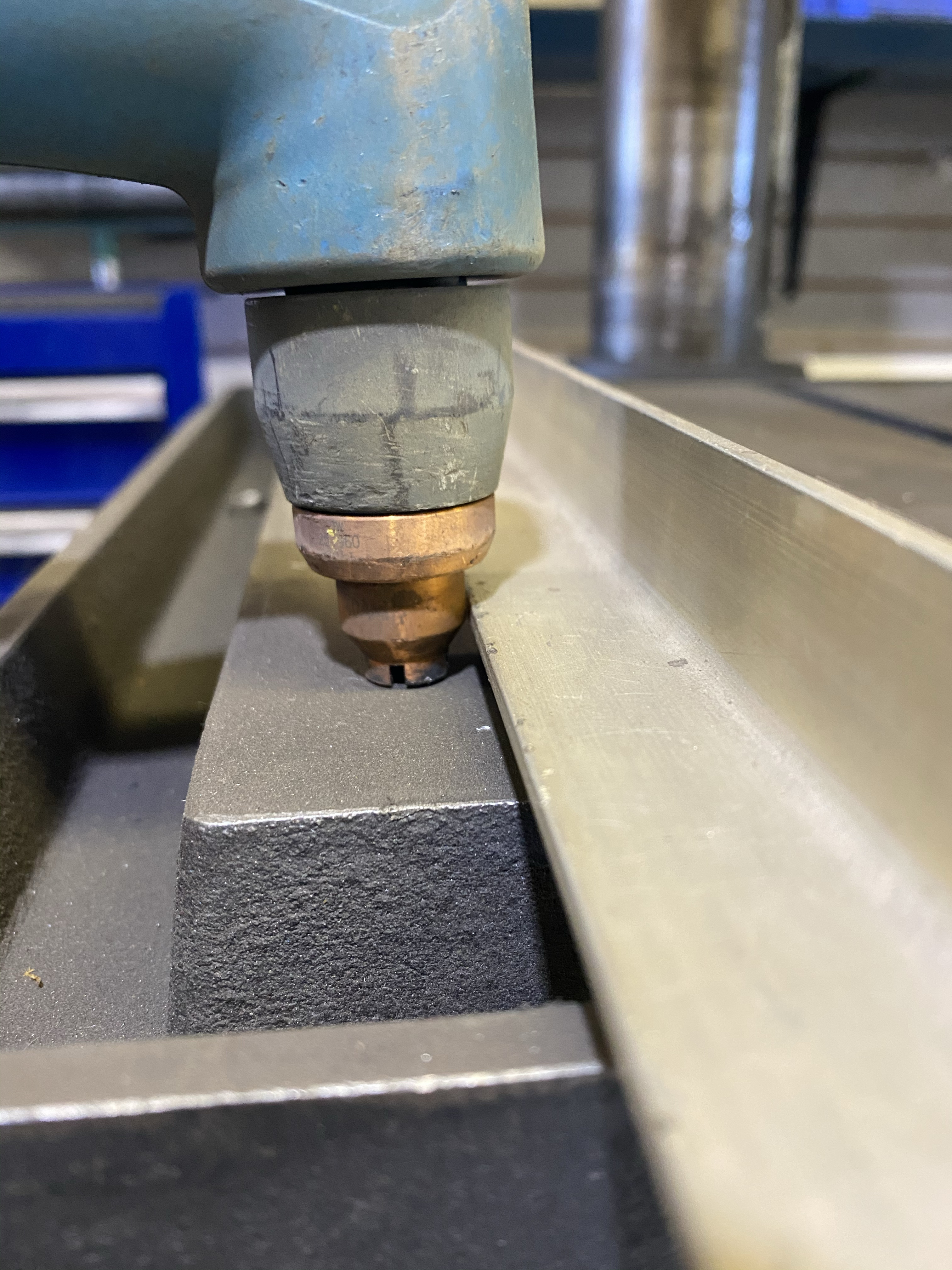

Just made a couple of short straight cuts with scrap 1/2in plywood hanging around instead of using a metal straight edge. Works fine... very little 'burnage' except where the wood is in contact with the hot steel. Doesn't affect the straight edge where the nozzle is traveling against.

You should use a guide THIN enough so that the tip itself can slide along it and not the nozzle cap otherwise if you don’t keep the torch perpendicular your cut width will vary.

yeah normally I use a thin piece of metal as BB says but for short quick cuts that I am not too worried about straightness, a piece of wood works fine. I like the idea of paint stir sticks but use new ones... :D

I did some experimentation today and the best thing I found was to use a wooden Home Depot ruler. The wood is 1/4" thick and, on my Thermal Dynamics torch, it fits just like Big Barn recommended/showed.
