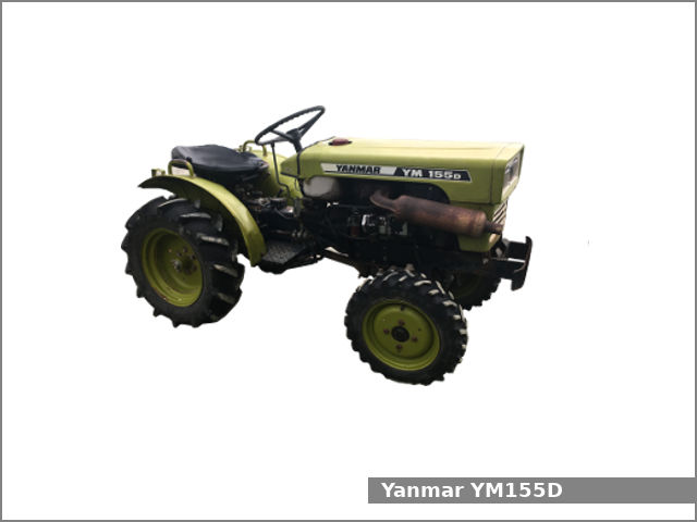

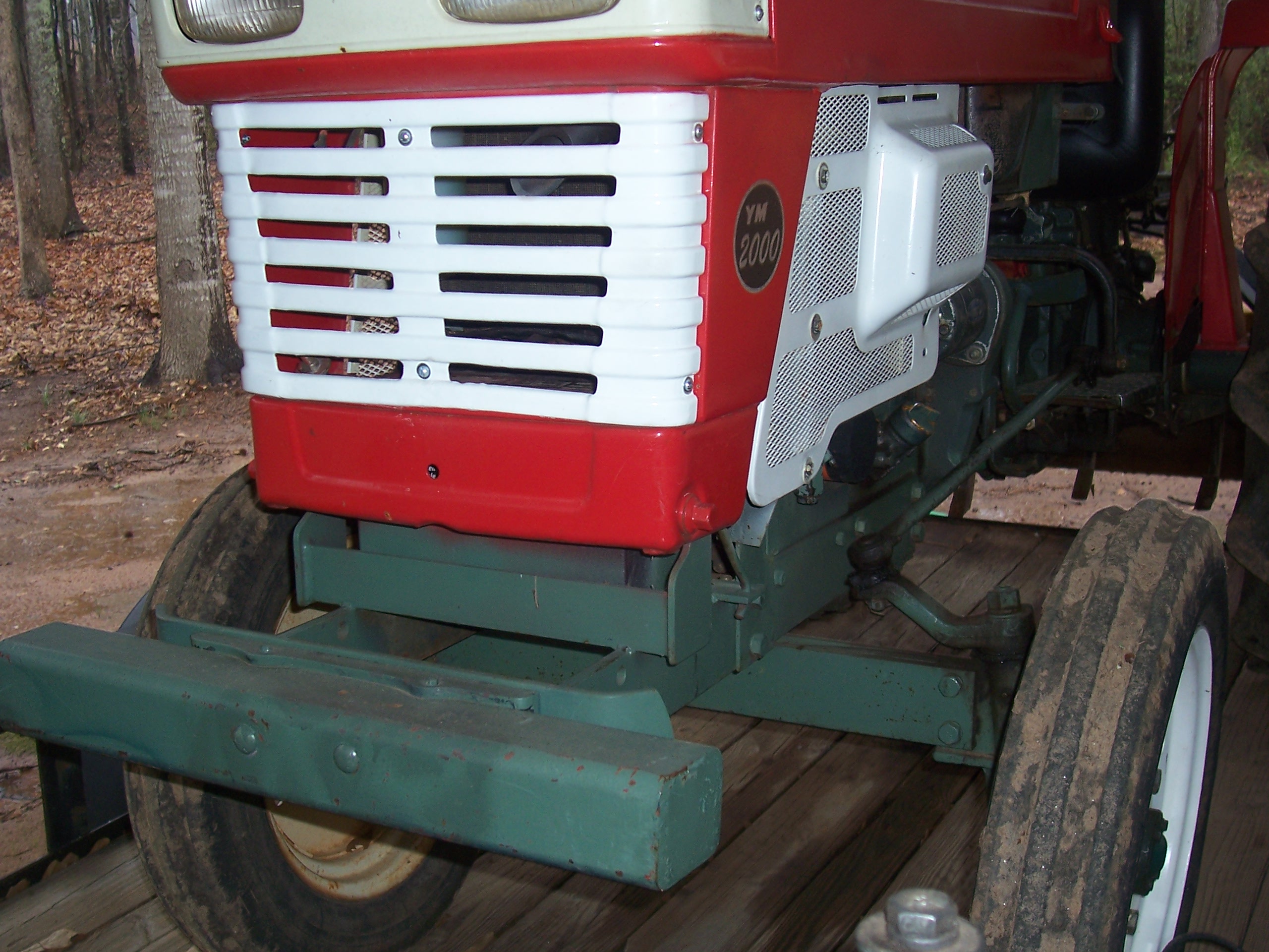

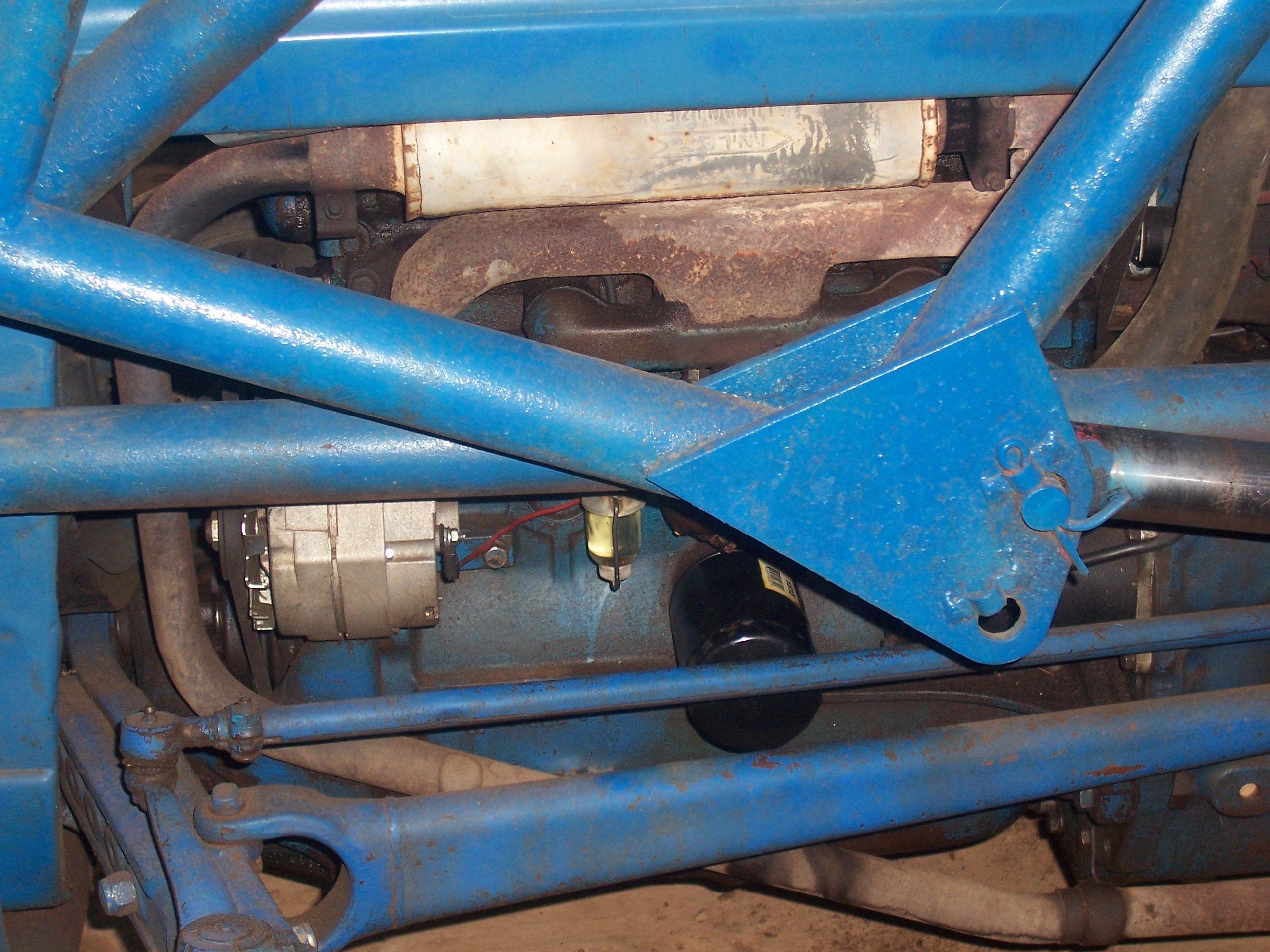

My YM2000 muffler 24Hp. is much bigger than my Ford 2000 muffler. Heard people turn the Yanmar forwards and then the Exhaust pipe under the Tractor to the rear axel. No Harm that I can recall. My ford is done that way 48HP. it's gas but is really quiet! No exhaust Fumes Esp. from Diesel smoke in your face either. Tractor Data 165 is turned forwards here is a Pic. of it also.;) TractorData.com Yanmar YM165 tractor photos information

165 in the Pic. Factory and a 155 turned forwards.

Org. pointed upwards. Prev. owner changed it. Your 15Hp. can't be very noisy compared to 48Hp.. Super small muffler and Tail pipe. 4Cyl.. Just a straight pipe! kids do that to make the auto exhuast super loud. Been doing that forever!!

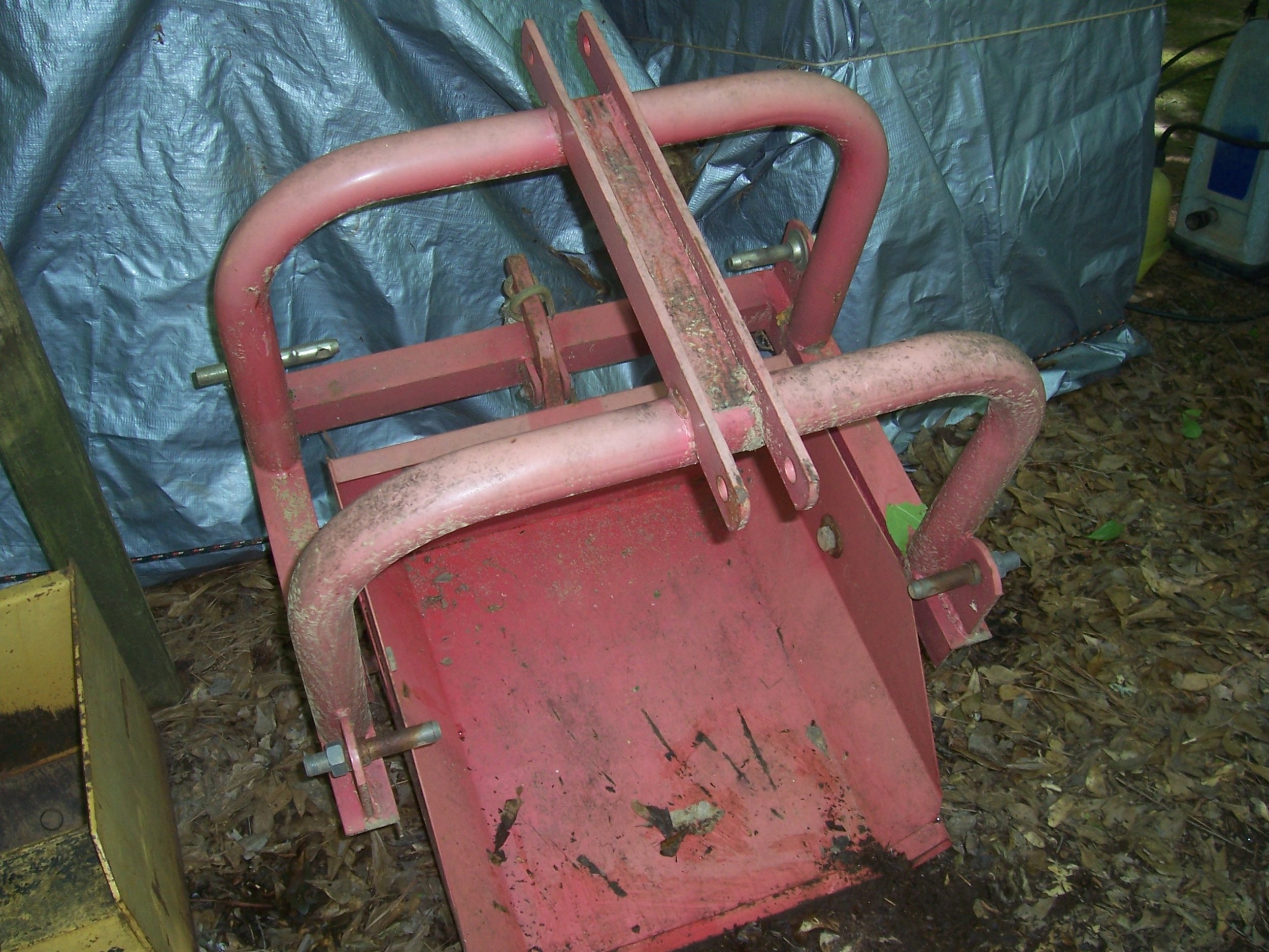

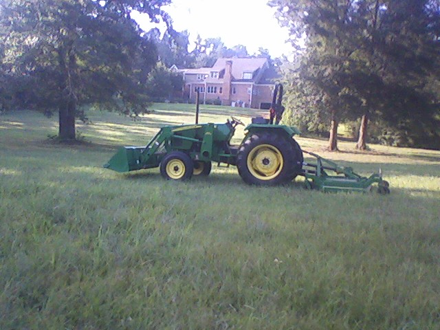

When I bought the Org.YM2000 I would get Oily Carbon Bombed!! Learned quick not to wipe them off because they would smear! Gas soaked shop rag was about the only way to get them off the Tractor. Thought about turning the exhaust forwards then but after removing the muffler a couple times and cleaning it I finally made it Quit! No oil use or excessive smoke. I plugged the Inlet/outlet filling the muffler with gas to loosened up and removed the build up. Worked great so I solved that problem. The Yanmar is basically my lawn mower so I'm Always moving on it. No FEL. used a 3Pt. rear scoop and really never considered it. 2wd and the Front End and Axle Assembly just wasn't made for one IMO.. 4wd which is no need for in Ga. I would of considered it but still the lack of Hp.. I knew it wasn't going to do much. Light lifting! Yrs. Ago a FEL on the 5103 so I knew it's capability. I ended up with the 1963 Ford 2000 with a FEL. which just The Eng. ran and that was about it! Had to split it! I'm glad I had to now. 2 stage clutch and it's nice having that option! Pretty much same size and Hp. but the JD. was Diesel and the exhaust fumes was apparent on it! It was only literally a couple Yrs. old.. Exhaust was factory Horizontal. I see no problem Extending the Exhaust on the 165. My guess you will like it and the reduced noise level. No Diesel smoke blowing back on you either. JMO.... Using the FM. on the YM2000 I weighted the front down with a lead. Lift the FM. would your doing wheelies!!
