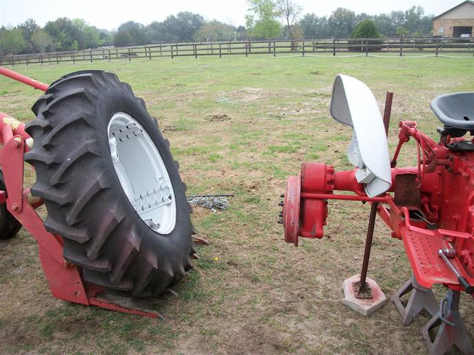

since the bulk of the time of filling a tire is jus tletting the hose run and hitting hte burk button now and then, loading a set of tires, for me, is easy.
jack stand underthe axle, remove stem core, hookup drill pump and ballast jug, let drill do it's think while I walk away and get the next jug ready, and drag the water hose out and burp adapter.. usually after a minute or two the jug is ready to be changed over..in florida I only mix 2g or so of af into a tire..and call it good.. from ther eit's garden hose and yer well pump or water service doiung the work... burpin every few minutes.. a 16.9-24 hold another 59g of water.. so.. that tells you how long it takes to fill, based on your water service.
after that.. stuff a core in, and hit it with air till it lifts off the jack stand like it had been before deflated, and it's good.
while one sid eis filling with water.. do the toehr side with the drill pump.
only about 5 minutes of actual work involved in the whole deal.. rest is just keeping an eye on it while the water hose fills the tire. can actually do some other good usefull stuff in that time..
by the end of this.. I think it took me 30m to do both tires. the heaviese thing I lifted was a gallong of af and a jack stand.
During that 30m, I got about 20m of other work in my shop done, as it only took about 5m of real work to set this up.. and another 5m lost going back and forth pressing a burp button.
I'll take 10# lifting and 30m job with 20m back as 'change' ballasting a tire -ANY- day vs manhanding a tire casing that weighs 3x my weight.. plus the rims and or center possibly... not to mention if you take the tire off.. then you hav ethe safety risk of it falling over.. on somebody.. etc.. or the tractor falling off a jack to it's side.
hmm.. hard choice. I think I'll take A and not break a swet or strain anything I may still need, vs the brute force / proove/ I'm a man and strong as a bull method ;)
soundguy

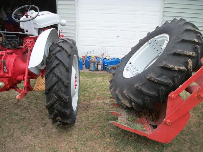

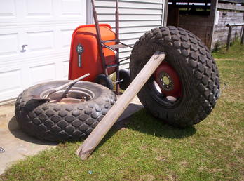

ps.. if that's a 14.9-30 you refer to.. it's a 57g ballast + fill, vs the 61g ballast + fill on a 16.9-24 thus yeilding the same basic weight of water.. 475# vs 509#.. plus the tire casing and rim and center, if you are taking them off or not.
I'll take 30m and no heavy lifting vs 'under 2hrs' and not touching a 800# loaded black rubber mancrusher.. any day. :) if I was younder.. or 6'8 and 300# might be different. at 5'5" and 130# i go for EZ when possible. I have no good paved surface to work on either.. meaning no tire dolley, except for front end loader :)
them 14.9-28's i did a while back are 'small' at only 53g fill each and 442# water.. but the near 1/2" thick sprial PA center and heaqvy rim adds quite a bit...
I added a pic for those interested showing the difference of a 11.2-28 tire vs a 14.9-28 tire.. for reference.. a 11.2 is what you see normally on a ford N or ferguson TX-20 style tractor.. or similar.. mf 35.. etc.. , next pic is my tire dolley.. :) after that is them 16.9-24's
