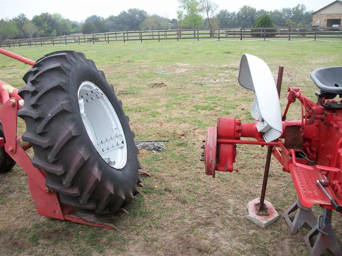

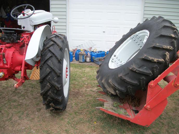

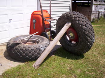

ps.. if that's a 14.9-30 you refer to.. it's a 57g ballast + fill, vs the 61g ballast + fill on a 16.9-24 thus yeilding the same basic weight of water.. 475# vs 509#.. plus the tire casing and rim and center, if you are taking them off or not.
I'll take 30m and no heavy lifting vs 'under 2hrs' and not touching a 800# loaded black rubber mancrusher.. any day. :) if I was younder.. or 6'8 and 300# might be different. at 5'5" and 130# i go for EZ when possible. I have no good paved surface to work on either.. meaning no tire dolley, except for front end loader :)
them 14.9-28's i did a while back are 'small' at only 53g fill each and 442# water.. but the near 1/2" thick sprial PA center and heaqvy rim adds quite a bit...
I added a pic for those interested showing the difference of a 11.2-28 tire vs a 14.9-28 tire.. for reference.. a 11.2 is what you see normally on a ford N or ferguson TX-20 style tractor.. or similar.. mf 35.. etc.. , next pic is my tire dolley.. :) after that is them 16.9-24's
