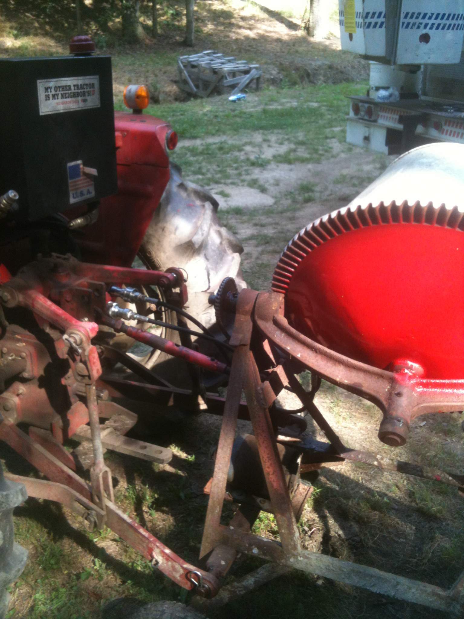

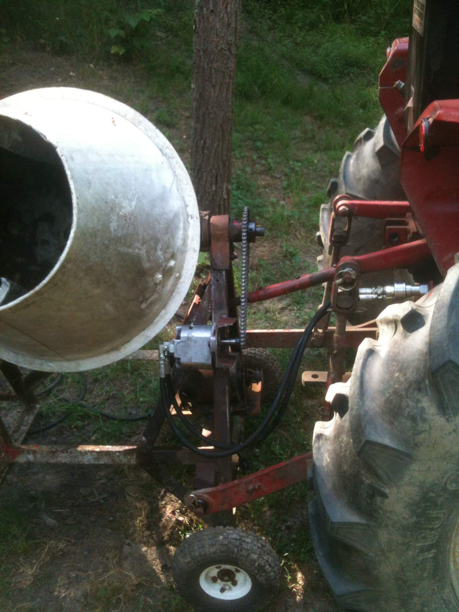

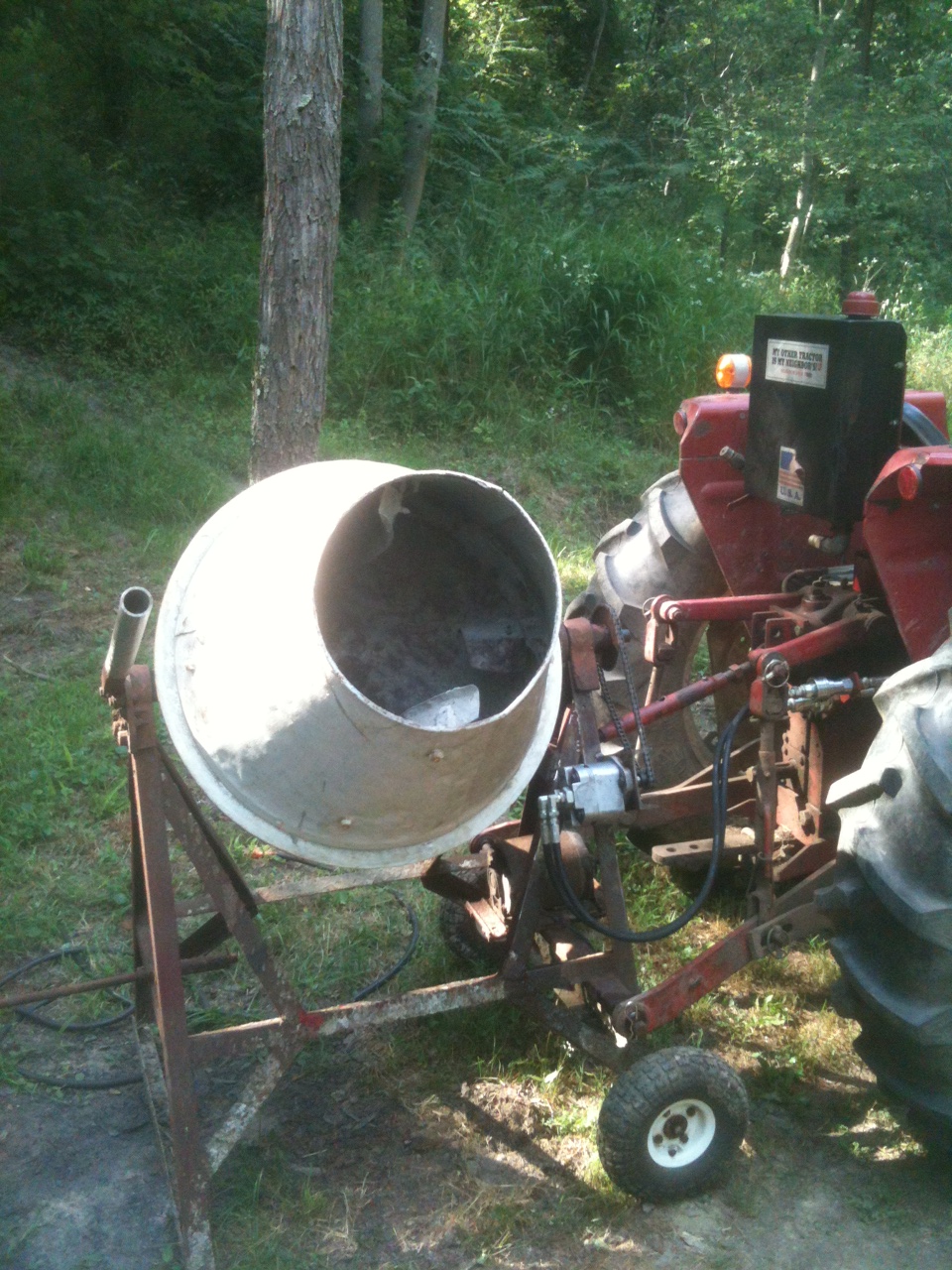

I modified an old Sears mixer to mount via 3-point hitch, and just last w/end modified it to run with a hydraulic motor off of my newly installed rear hydraulics Q/c's. Now I can run the drum by changing position of my selector valve. I left the electric motor on it in case I ever want to run it with 120vac, by removing the sprocket and putting the pulley and belt back on it.
Now I want to add a cylinder for dumping from the tractor seat.

hey that is pretty cool. How much did the hydraulic motor set you back moneywise?
73
James K0UA
   / Strange, cheap, concrete mixer #33
Not to hi-jack this guys thread, but the motor cost me about $35. The sprockets and chain I had laying around. The motor is a 1.0cu.in Rexroth. The chain ratio is 4:1.... 10 into 40.
If will turn a loaded drum @ idle, (540 PTO) and revving-up when first mixing is about the same drum speed as when using the 1725 rpm electric motor. My tractors have 1000rpm PTO capability too, but I see no need to run that speed, but I could if I wanted to? The pinion RPM of the stock electric powered setup was 246 (no load on 1/4hp electric motor). The 1000rpm pto setting would make it 250, but even with the 540 setting, I think it'll be fine.

We mixed about 50, 80 lb sacks a couple weeks ago. Still beats a wheel barrow all to pieces.

Did you ever try to silicone seal the rim of the lid or just let it drip a bit?
James K0UA
Yes, we did run a bead of silicone on the lid. It is still there. Only did it once. It still will drip a little, but not enough to matter. We don't leave it in the down position any longer than necessary. Actually, after putting in the ingredients & closing the barrel, we lift it high enough to turn upside down, speed up the engine to get faster hydraulic movement, then flip the barrel as fast as possible, until we think it is ready.
