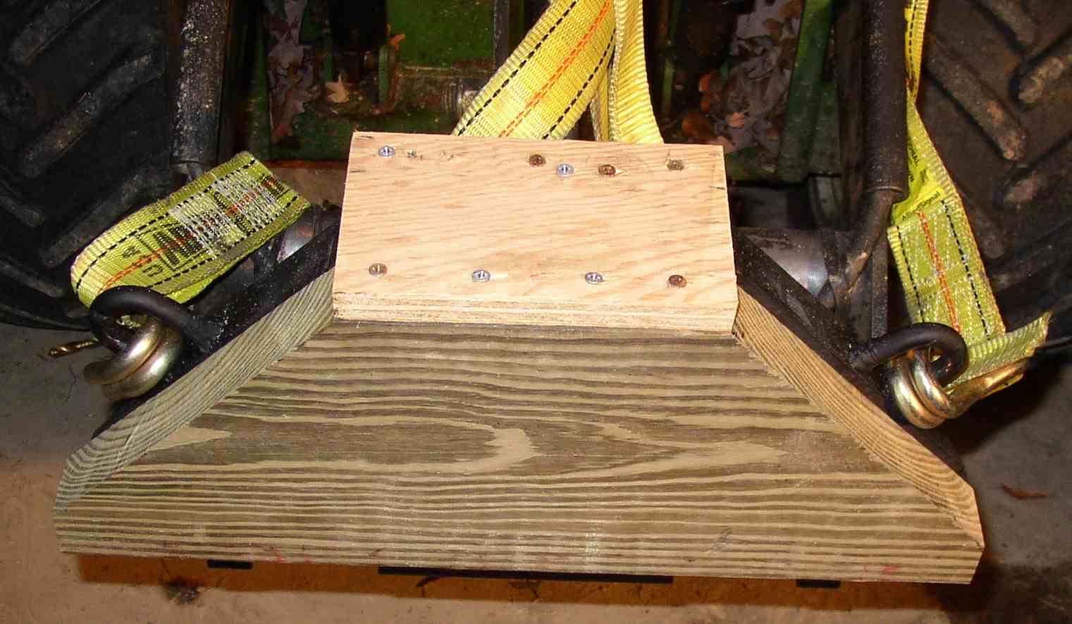

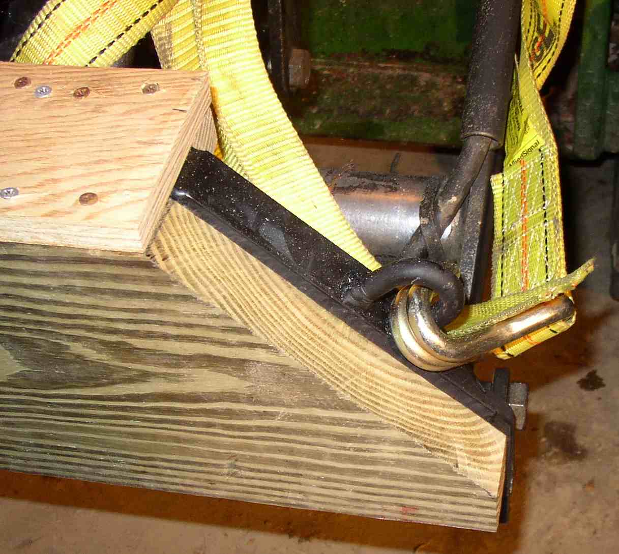

I have a 30 gallon gas container that I find difficult to move. I figure it weights over 200 pounds. I considered welding a quick attach plate to it, but I was reluctant to weld to a gasoline container and did not want to use up my last quick attach plate for a single use purpose. I figured if I could attach a strap with a ratchet to a quick attach plate, it would be easy to move.
I bought two steel cable clamps and welded the u-bolts to the quick attach plate. I cut the bolts short with about a 45 degree angle on the cut, so I would have a lot of welding area. I had to grind a little metal out of the center of the u-bolts to have room to put the cable hook in. I put a board over the end of the quick attack plate to allow the tank to clear the hooks. I hope this is strong enough. I picked up the tank and it worked fine, but it was only half full.

Another picture

Last picture, unless there are additional request.

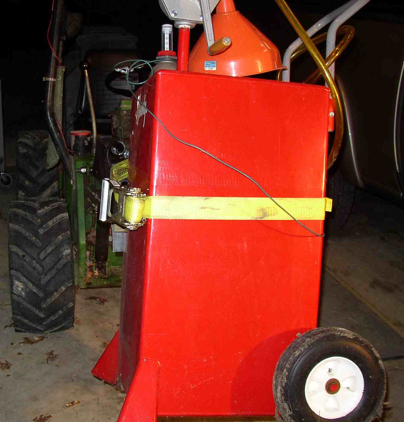

A picture lifting the 30 gallon gas container would help me to understand how it worked. /forums/images/graemlins/confused.gif
   / Strap Lifter Attachment
I knew that was coming. I need to mount a camera on the PT. I will try to take one tomorrow. It's kida dark right now.

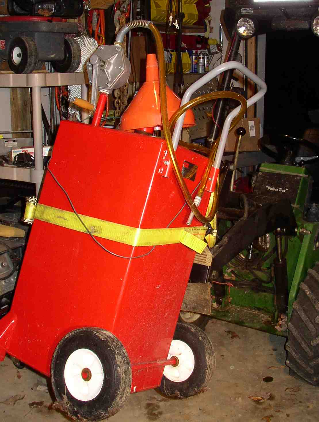

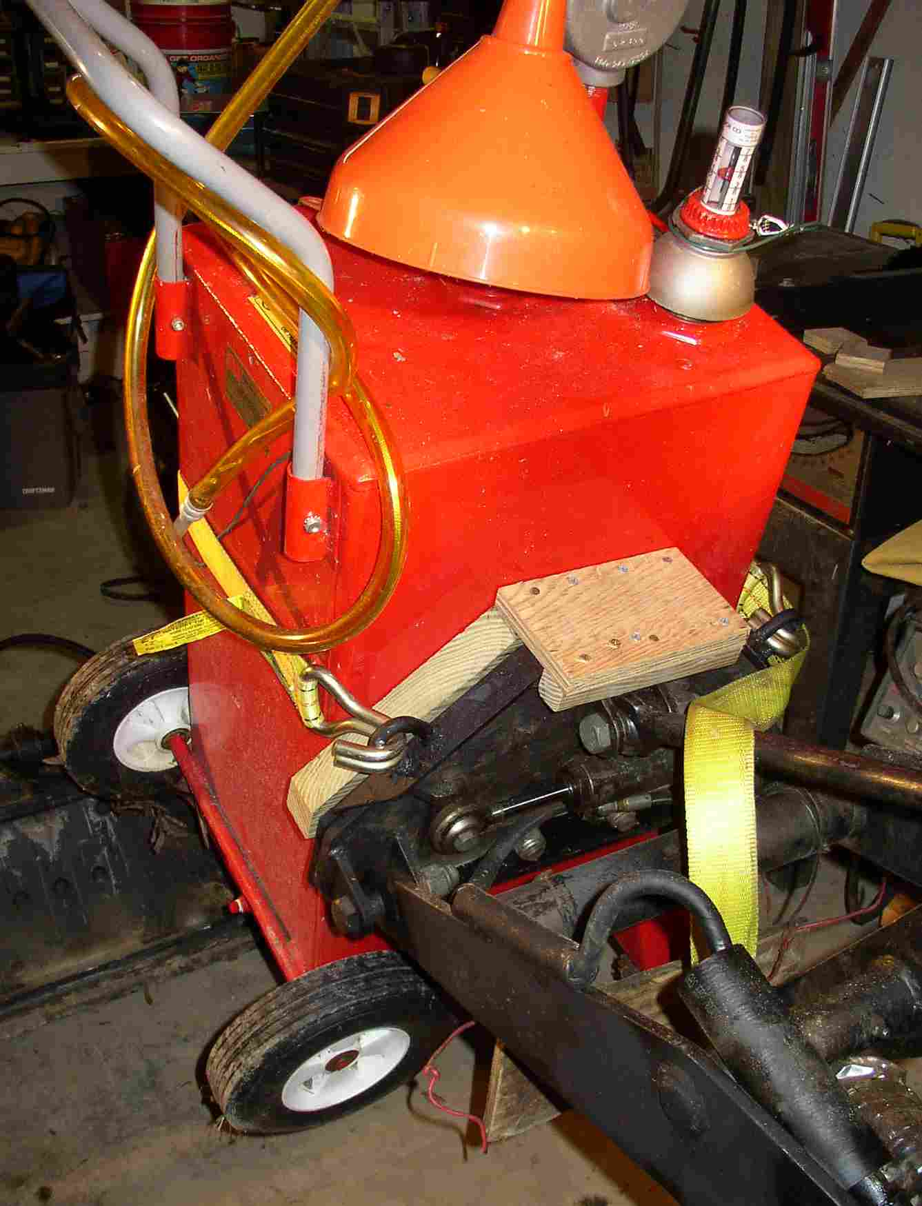

OK I got the pictures. It was really easy to attach this time, although I need to add a couple of pieces of wood so the wood cannot fall off and then paint it.
I hope these pictures make it clearer. That 100K limit really makes me crop the picture.

Another picture with the 30 gallon tank.

Last picture with this tank.
I have a few comments on the tank. It's got it's own pump which can load and unload the tank. It also fills through the cap. What I don't like about it is it's too heavy to move when loaded unless its on a smooth pavement. I think it was designed for use in a garage to unload gas tanks that have to be dropped. It does not really seem to be designed to be left outside. I generally keep a plastic bag over the top to keep moisture out. It also cannot be hauled in a vehicle when loaded since it has a vent which will let gasoline splash out. I buy gas in 5 gallon cans and it from them. Not the most convenient method. I got if from Northern.
