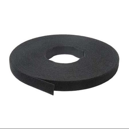

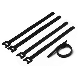

Look Velcro straps.
Or bulk roll and cut to needed length. k2-_d7800fe3-751a-4e1f-8cfd-4d925a7c7bd4.v1.jpg
