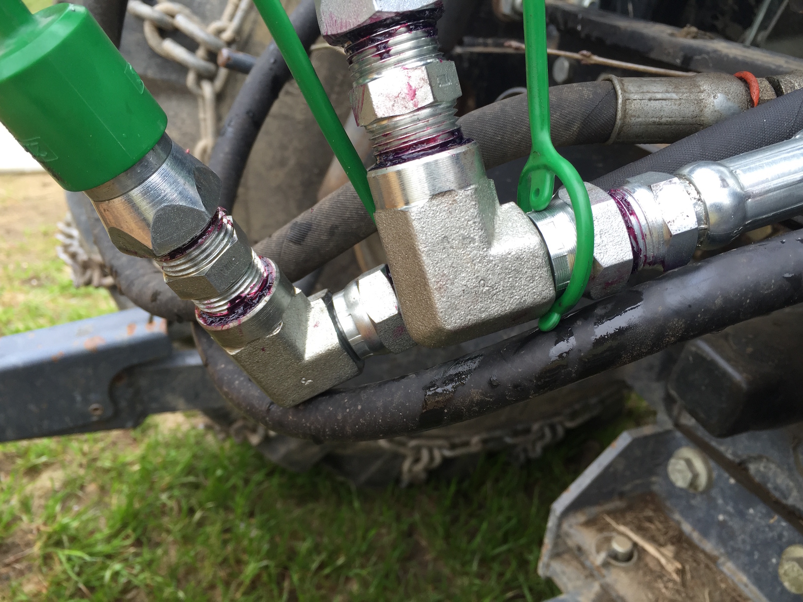

Thanks, Ron, and everyone. I've been poking around some more, now that I know the search terms to use. I can find some rated at 300 PSI, and thought I saw one at 500, but can't find it again, so maybe I was looking at something else. A service guy is stopping by Tuesday afternoon to make repairs. I just sent a message to the Service Department person who set up the appointment with a picture of the parts in question and asked her to make sure he brings appropriately rated hydraulic fittings with him.
A more in-depth discussion will take place when I am at the dealership in person.
BTW - what are the chances that screwing the quick disconnects and other fittings on to these malleable iron parts has damaged the threads?
The link I posted with the picture has the right ones that are rated for tractor hydraulic system pressures. See also Brennan 552-24-24-FG Forged Steel Pipe Fitting, 9 Degree Street Elbow, 1-1/2-11-1/2 NPTF Male x 1-1/2-11-1/2 NPTF Female: Industrial Pipe Fitting: Amazon.com: Industrial & Scientific for another one.

Current plumbing codes specify that female pipe fittings not be re-used due to potential stress fractures from repeated tightening. Hydro pressure vs typical gas/water pressure is scary when you consider that.

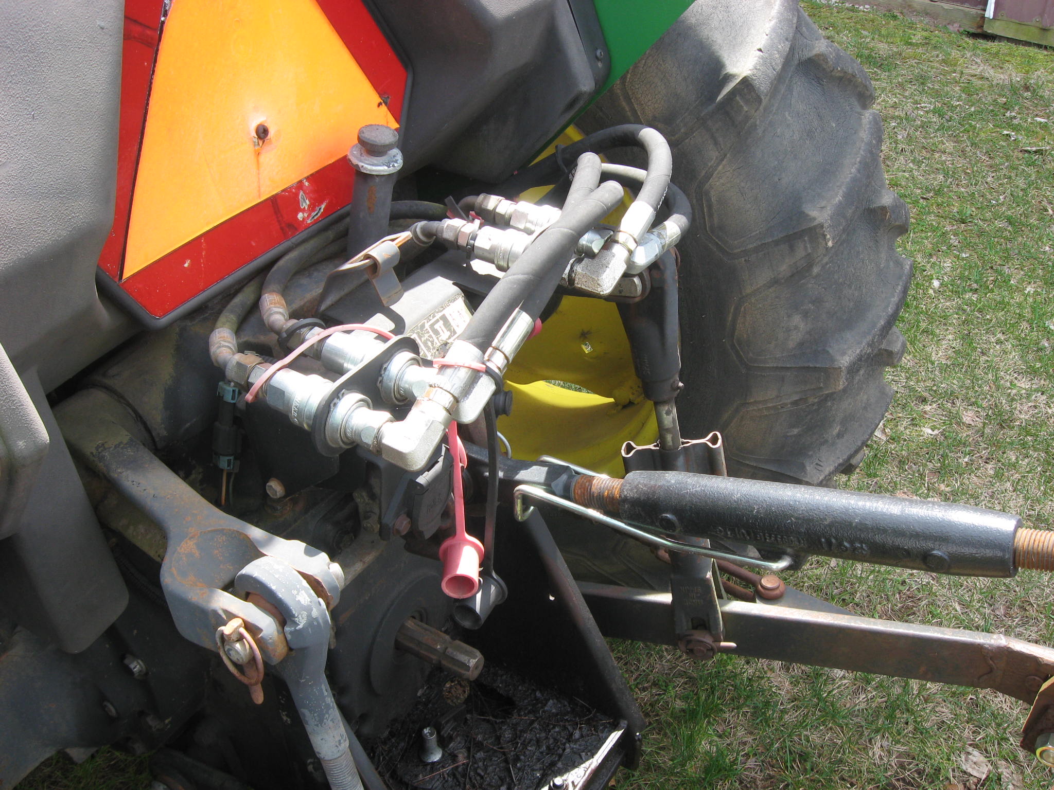

I got ORFS adapters for the new outlets & some JICs from Parker but all the rest here from TSC when I hung the big Allied FEL on the JD. (Five 'streets' altogether, 1/2" NPT)

The picture below is what they replaced the original street elbow with when I complained about the leak and the low pressure rating. Still not like the pictures posted earlier. Does this look like the right fitting for this application? (apparently, they did not have the male-female fitting, so used a double male adapter).
Now I just need to figure a way to stash this end of the hose out of the way when not in use.

Rule of thumb is if there is no rating stamped/cast into it, treat it as 150psi fitting.
Schedule 80 pipe fittings (300psi) are marked with a pressure rating.
A105 forged fittings which look similar to black pipe, are always marked as such.
But You need steel fittings made for hydraulics as other said. And I too would not trust that shop
   / Street Elbow ok in Hydraulic application? #17
Yes those are fine, just not quite as "clean".

Agree with finding a different shop - and if the newest "cobble job" gets too cumbersome for you, here's some options (assuming you stay with NPTF hoses and QD's)
Female Pipe Swivel Fittings (NPSM) > Discount Hydraulic Hose.com
I would have used either a 1501 or 1501L in your case, depending on which length worked better... Steve
