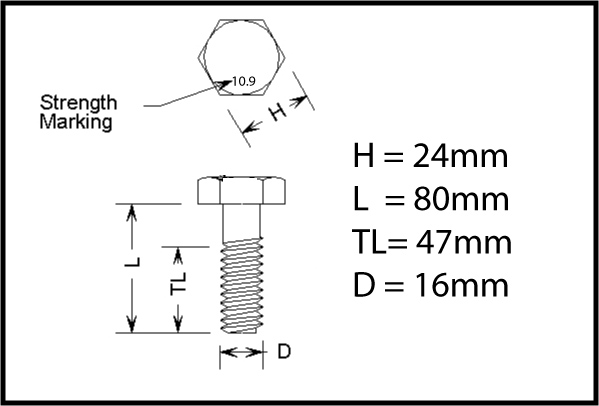

I'm interested in a bolt extractor set. Problem is I'm confused by sizing of extractors. Are given extractor sizes in reference to the hex size (flat to flat of bolt head - dimension H in diagram below) or the normal dimension of the bolt shaft (dimension D in diagram below)? I assume its in reference to the hex size (dimension H) but I'm not sure. I am trying to remove a M16 x 1.5 wheel stud not a bolt (doesn't have a hexagon head). I need a stud or bolt extractor that will fit the shaft of the stud which has a normal dimension of 16 mm (dimension D in diagram below). A 16 mm bolt would normally have a bolt head that fit a 24 mm socket/wrench (dimension H). When trying to remove the lug nut from the stud I stripped the threads from the shaft of the stud. One would normally put two nuts on the stud and tighten one against the other then turn with a 24 mm socket/wrench to remove the stud but I cant do that because I stripped the threads. I could try to clean up the threads and try to get two nuts onto the stud but doubt the damaged threads would stand up to the torque that would be required to remove the stud. I hope the bolt extractor will have enough bite to take the required torque to break the stud loose so I can replace it with a new one. My question is what size extractor would I need to fit the shaft (16 mm normal dimension - dimension H below) of the stud for removal? Might just weld a nut to the stud but would be nice to have a set of extractors for future.

No. They are saying that is the size of bolt/stud this kit will fit with no head. Shaft only
You hammer the extractor onto the stud. The extractor bites onto the stud shaft and you screw the stud out.
   / Stripped Stud and Stud Extractors #7
Usually there is no bolt head at all. That's why you need the extractor. Use the nominal bolt size. It is common to find the same size bolts with different size heads, especially when you get to 1/2 inch and above. But a 1/2 inch bolt is always a 1/2 inch bolt, even if one has a 3/4 head and another has a 13/16 head.

Most descriptions I've read reference use on rounded off nuts and bolts and/or studs. Big difference between diameters of the two. When the corners of a hex head get rounded off a wrench will just slip off thus the use of an extractor. Don't think you can say "usually there is no head" because I think the socket type extractors I'm talking about are frequently use on rounded off hex heads. While it may be common for a given bolt to have multiple hex sizes there is a "standard" size associated with bolts (see link to chart in previous post). There are exceptions to just about everything. While its true a 1/2 inch bolt is a 1/2 inch bolt the wrench size used on it is larger than the shaft size and that's my point. If an extractor is sized in reference to the nominal shaft size then it seems to me a 1/2" extractor would/could be to small to fit a 1/2" bolt with hex head intact. That just doesn't seem very logical. I don't mean to be a smarty pants but am still not convinced that socket type bolt extractors are sized in reference to the nominal dimensions of the bolt or stud shaft. Heck I don't know. I'm still confused by the descriptions I've read. I assume you are speaking from experience are right but would like to be sure before I pick up a set.
