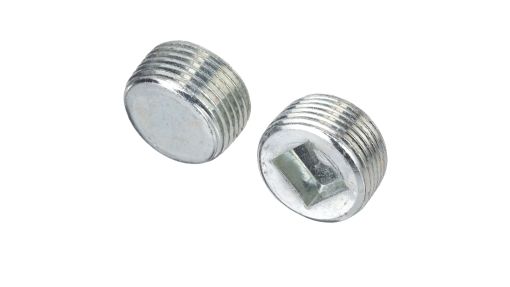

If you post a photo of YOUR drain plug we might be better able to make suggestions.
When I search for a drain plug for a Ford 4100 they all come up showing straight threads and a external hex. I hope someone didn't replace a straight thread drain plug with a pipe plug.

A pipe plug explains a lot, the biggie is dissimilar metals and thus corrosion. A big possibility of galvanized if it is a pipe plug, be careful welding as galvanized metal can and does give off toxic fumes.

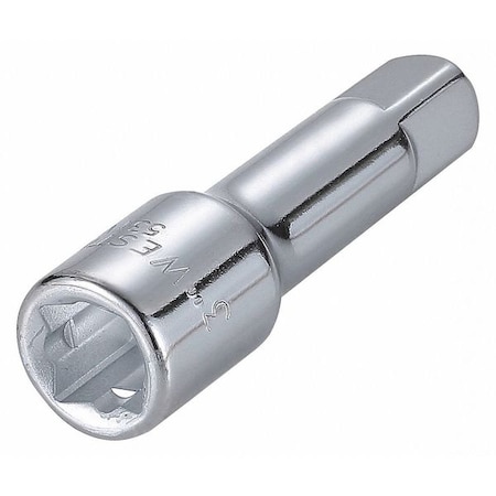

You may have some luck with a hammer and chisel, the jarring action may loosen the the corrosion as well as turn the plug. I would go to a NH dealer and get the correct plug before going very much further.
   / Stripped transmission drain plug - Ford 4100 #15
Take hardened square key stock the next size bigger and grind the end to a slight taper. Keep the corners sharp. Tap the hardened key stock into the messed up square hole. Fit should be tight. Custom fit extractor that we've used many times.

Too late on using something square, I tried a male 5/8 bolt extractor and it's pretty much eating at the metal and the hole is pretty round at this point.
The old one looks like this drain_plug_old.jpg just found it on a parts site for the ford 4100. I'd already bought a new one last year and then put off changing it when I found the old one stripped. Just went out to the shop to dig it out and it's almost the opposite of what's in there. drain_plug_new.jpeg
Don't remember where I purchased it from, one of the online tractor parts places. Both are listed as 3/4 - 14 NPT.
I guess the good thing is if it's the correct plug it's probably not galvinized and therefore might be able to weld a rod or old lug wrench to it. I don't think the welding would hurt the cast housing as long as I just weld a little at a time so that I don't heat it too much.

You can try the weld trick, might try sacrificial socket wrench extension...But get a wrench on it while steel is hot and metal is relaxed....

Heating the plug causes it to expand. Might make the fit tighter. Maybe letting cool down after welding better. Just the expansion and contraction of the metal might break bond.
Hammer and small sharp chisel sometimes work. The impact action often breaks things loose. The internal expanding extractors work great on broken off pipe. Don't know the condition or depth of the hole if reasonable.
