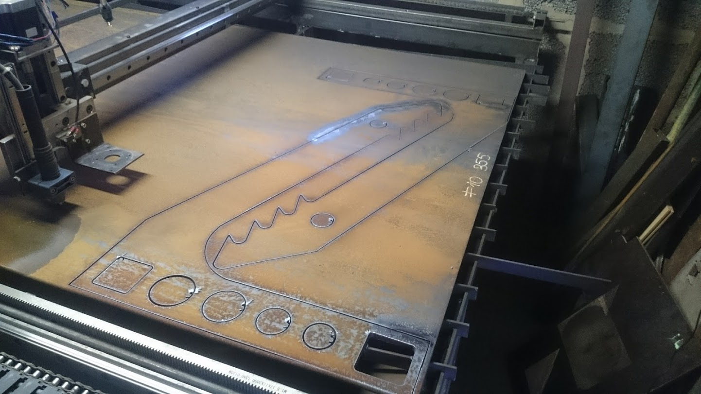

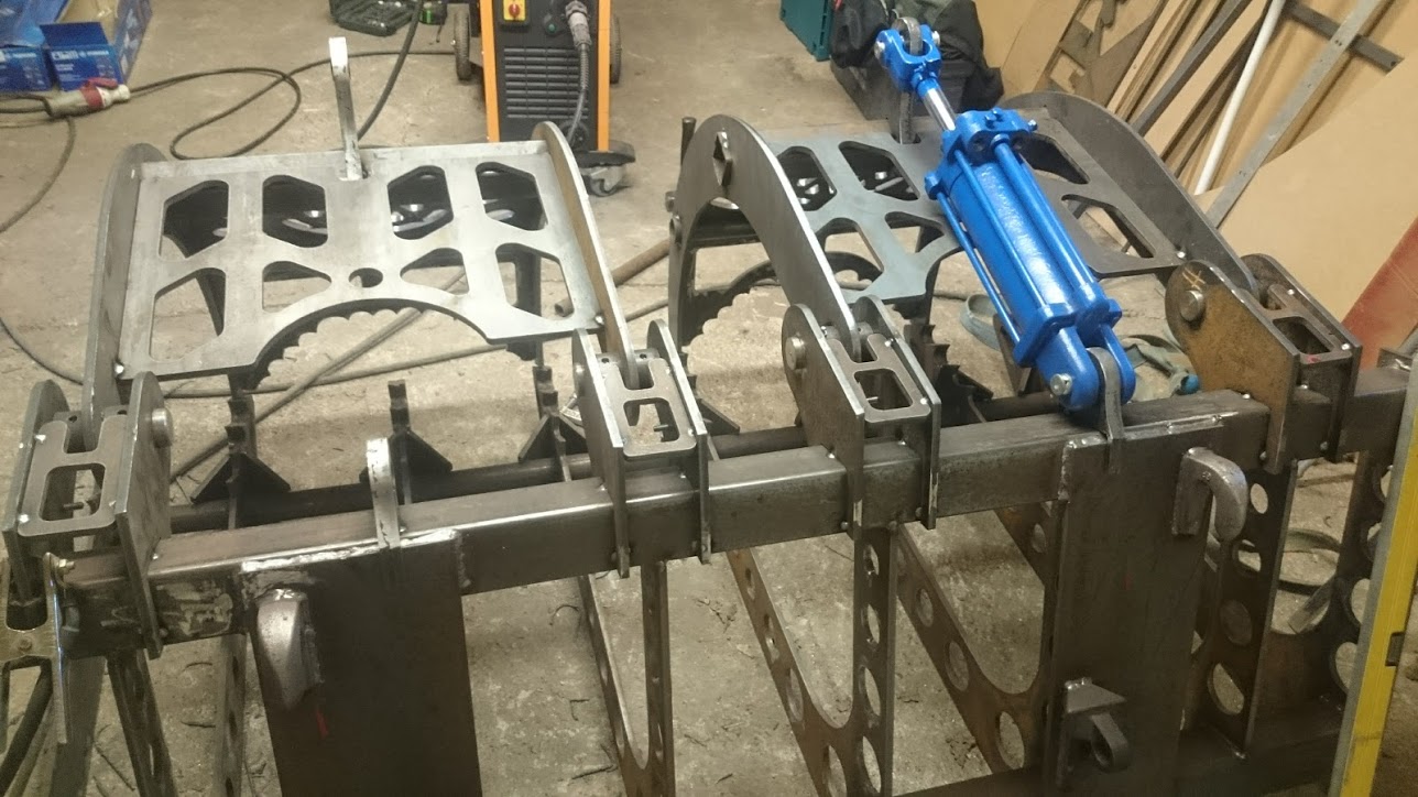

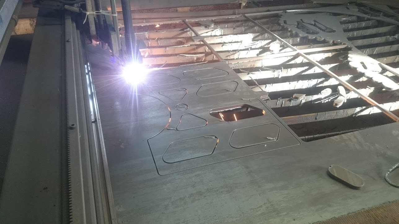

Since we have a metric dimension, then I used 10mm material. 10mm Slightly More Than 3/8 inch 0.393.
I have one mistake. if I build things for myself than thicker material than thinner.
After all, you still want yourself a better tool than mass production. Be the thicker and harder before it gets broken. It all depends on what you want him to do. Everything can be broken :)

I agree. Thanks for posting your material thickness. Awesome pictures!!!

I did 1800mm because I wanted to be as wide as a tractor.
