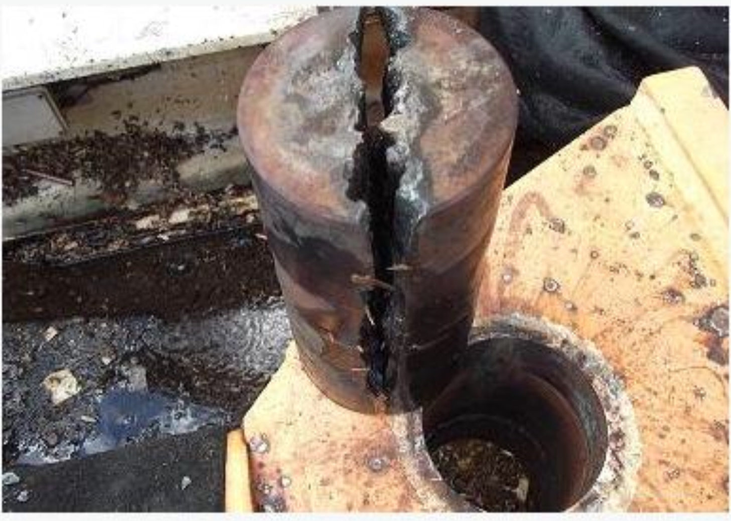

Replacing bucket, every pin came out easy except the main pivot pin on the bucket. I tried hammering the **** out of it, putting a pipe wrench on it and then push it with the hydraulics but it won't move. I put a pulley puller on it and turned it in, put heat on it, nothing. I'm running out of ideas.

I had one like that when I got my hoe and could not take off the bucket. Tried heat and stuff and looking at the price of a new pin from Kubota, decided to saws-all it through. Actually easier than I thought with a cordless Dewalt that had been given to me. Quite impressed! Anyway, then getting out the three pieces was easy without damaging the hoe.

The problem is not a Ridge on the pin, if that were the case the pin would rotate. The pin is seized in the center bushing. You are fooling yourself with the boy sized propane bottle, just wasting oxygen. You need a LOT of heat (think rosebud) across the length of the center bushing. Heat it red hot and quench. Rinse & repeat. If the end of the stick is boxed and the bushing is not accessible you will have to cut the pin on either side of the dipperstick with a saw and gouge out the center part of the pin.

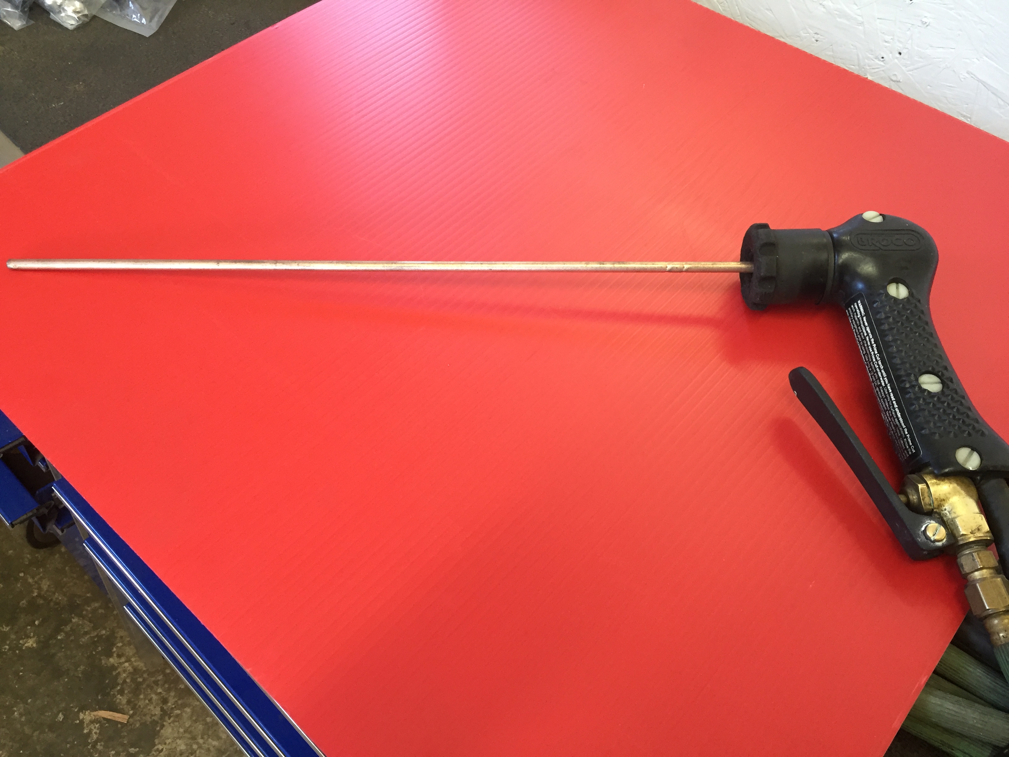

You may need to cut the pin out. Find someone with an exothermic lance.
