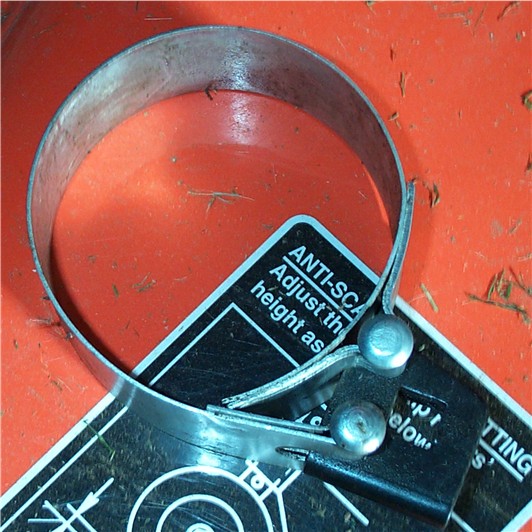

I use a band type filter wrench that accepts a 3/8 inch socket extender (I have 3 sizes). I have removed many filters with the wrenchs but only once on my BX2200. It was on very tight and took a fair amount of torque to break it free. When I reinstall, I do the same as Bird, I tighten it by hand and I have never had one leak.
Picture attached.
