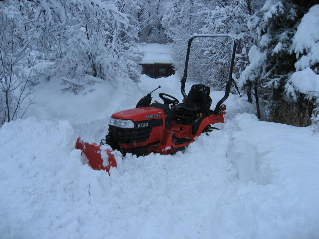

Heres a pic of my bx23 stuck. I was plowing downhill and had to shove some of the snow off the side to make room for more storage. I pushed the snow off the side and tried to back up and no go. I just spun the wheels and couldn't go anywhere. Even my f350 had a tough time pulling it out. I've got chains on order. You can get it stuck just like any other machine. I tried plowing up hill, so I can back out downhill and it works, but not as well as having gravity behind me. When the snow gets really deep, chains are needed in Colorado.

Gerford,
Great pic of what I had in mind when I started this thread.
Not sure chains would help out much in this situation.
In your honest opinion, is this a result of the tractor or the operator? :)
Thanks again for sharing your adventure.

It must be the tractor.
The problem I have is that behind the tractor the drive gets really narrow where it crosses the ditch so the snow has to be pushed down the drive and then off to the side. There is no room to just push it to the side. I tried pushing the snow uphill above the ditch, but the tractor won't do it. The tractor pushes really well downhill, so thats what I was doing. The problem arose when I tried to back uphill after pushing the snow to the side. The back end slid downhill and I was stuck sideways. We had some warm weather earlier and then it got cold, so there is a layer of ice underneath the snow pack. The tires do like to spin, especially when plowing uphill. I finished the job by pushing the snow straight down the drive, and then pushing it off to the side from the downhill side. There were a few more times when I thought I was stuck, but managed to get it free.
I started another thread about having more weight on the backend by mounting the backhoe, but somebody mentioned filling the rear tires. I may try that.

I would say it's the tractor. My tractor wouldn't be much use if I had to stay
on the driveway in order to avoid getting stuck. I need to be able to move snow
and access some trails. I can drive through two feet of snow when I need to with chains on the rear tires.
