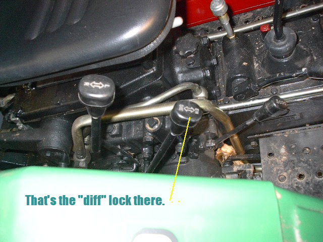

Yes, the middle lever. Don't feel bad, they aren't labled very well, and you cant really see anyghing happen, until you need it. Remember to push down, not pull up as you can break the small casting, (not expensive or hard to replace).
   / Stuck on a hill #22
yep thats it, just remember that is has a pretty LONG through, sorta like on old floor mounted truck shifter, only don't get so rough wiht it! lol... takes very little actual pressure to move it. and once resistance is met push slightly while it is moving, (one wheel slipping SLOWLY if running full speed do not engauge it.) also NEVER engauge it on HARD surface that the tires can get a GOOD bite in it and turn the wheel, it CAN and MAY and MIGHT lock the dogs into the hole plate resulting in a locked up rear end which will have to have one wheel raised and a crow bar under the seat cover operation if it gets too solidly locked! (This has happened many times in the past and was a well read subject back in the day but I have not heard anything that way in over a year or so... they may have changed the design some on the newier ones.?

Touched up your photo so there's no doubt as to which is the differential lock.
This lever has a VERY long stroke and will go nearly to the floor boards when engaged. You usually have to gently spin a tire in soft ground (be stuck) to engage it. I've only used mine once, but it's very handy going striaght. Never keep it engaged for anything but a straight push/pull situation.
