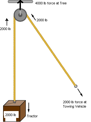

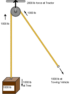

Sorry Roy, moot or not, I think this might clear things up a little.
Using a single pulley all depends on where the pulley is placed.
1. If pulley is placed on tree, then yes, it will take the same amount of force to move the tractor. The tree will experience twice the amount of force, but the tractor and towing vehicle will experience the same amount of force. If tractor weighs 2000 lb, then the tree would exert 4,000 lb of force while the tractor and towing vehicle would exert 2000 lb.
2. If pulley is placed on tractor, then it will take half the amount of force to move it. The tractor will exert its 2000lb force, but the tree and towing vehicle would only need to exert 1000 lb of force.
The force at the pulley is divided into the lines coming out of it.
