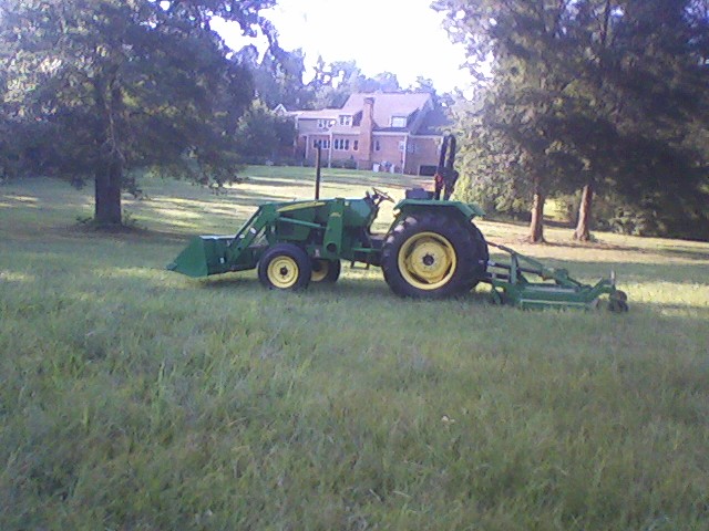

This is 5103 Fm. Rear AG 13.6-28 And they work really well also. Turf tires in Ga. are rare. High dollar place 38 acres! :cool:

No 4wd. on any of my tractors in Ga.. The Ford has AG. rear also. Anti freeze for weight and they don't bother my yard. My profile pic. is the front yard. Loader on it. Cold weather WV. Mtns. where I'm from Org. I would have it for the Mtn's and snow season no doubt!
