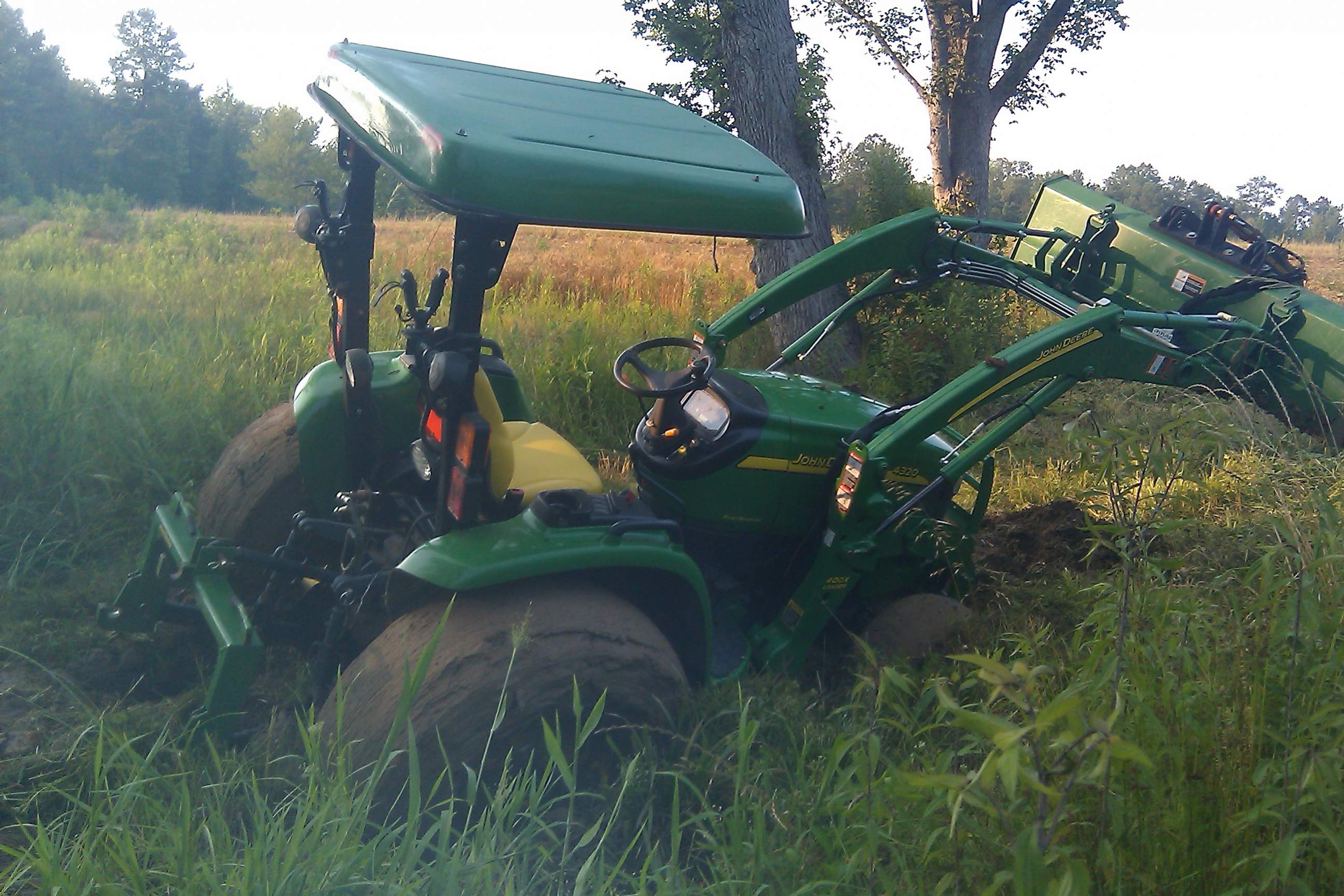

Does this qualify as stuck? I had one heck of a time getting it out. I used the "chain around the tire and tied to a tree" method. I managed to pull the front right tire off the rim in the process..... :ashamed:

being on an incline like that you were probably puckered up to begin with but did you try walking your self backward with the bucket before you spun your self too deep?

It's a little unfair to say "stupid" or "uneducated" when you don't know the facts or terrain. The fact is that someone hand dug a small ditch in an otherwise dry area and didn't tell me about it. We haven't had any rain here in about 3-4 weeks and the area is about as dry as it gets. The situation was further complicated by the fact that the grass was 6+ feet tall and the ditch was shallow and very narrow (more of a swell). Therefore, there was virtually no visible change in the tops of the vegitation. I was slowly backing into the area when the rear tire felt like it hit quicksand with no warning.
/ Stuck?
Yes, Dan. I tried walking myself backwards. The FEL just pushed me further into the ditch.

I feel certain the result would have been the same regardless of the tires (unless they were about 2-3x taller). I was in gear A-1. As soon as I felt the rear wheel start to sink, I immediately stopped the tractor and lifted the bush hog to its highest level. All this did was allow the rear wheel to sink further and the bush hog stayed on ground level. :confused: Within a couple seconds, the frame was on the ground. Then, I tried to use the FEL to walk backwards. All this did was cause me to slide sideways into the ditch and allow the front tire to sink :mad: A 4wd truck tried to pull me forward, but the tractor wouldn't budge! :(

Yes, 'stuck'. Maybe even 'stuck good'. Anychance of a blow by blow of how you got out? I've read on here about this 'chain around the tire' trick but can't get a visual.
1. Rear tire, right?
2. Attachment point/method on the tire?
3. Method of keeping the chain centered on tire as it rotates?
This is a 2 person job, right?

Ok Nelson, I'll give it a shot.
After failing to unstick the tractor with the FEL and 4wd truck, I tied a chain through the rear left tire and wheel. I hooked the end of the chain onto itself on the front of the tire, near the ground, and the "knot" was as tight as I could get it. Then, I tied additional chains to a tree in front of the tractor approximately 40 ft away. After the chains were in a straight line and connected, I drove forward in A-1 until the rear tire began to drive up onto the chain. However, because the rear left tire was at a slight angle to the tree, the tractor was pulled more sideways than forward. This is when the front right tire was pulled off the rim.
Realizing that wouldn't work, and after much swearing, I was able to unhook the bush hog from the tractor so that we could attempt to pull backwards to a different tree that would give me a straight line to pull from. Then, we pulled the bush hog away from the tractor using chains, cable, and a 4wd truck. That worked really well.
Then, I unhooked the chains from the previous tree and tied them to a tree about 50-60 feet away that was behind the tractor. Also, this time I used the rear right tire and it was fairly "square" to the tree. I believe this was the major factor because I was able to keep the chain centered onto the tire and it pulled itself in a straight line. I started to drive in reverse in A-1, and as the tire began to climb onto the chain, I lowered the FEL and placed the flat bottom of the bucket to the ground as far as it would go to help get the front right tire out of the hole and to allow the front end to "slide" better. I had to adjust the chain a time or two as I drove backwards, but this worked like a charm!! It crawled right out of the hole! I had my old man helping me. It could be done with one man, but two certainly made it easier.

That is the first time I have tried the tire and chain method. It worked well as long as the tire was square to the tree your chain is attached to. I hope y'all were able to understand my description. I encourage y'all to keep it in your toolbag of tricks if you ever find yourself in a situation where it might be useful. Just make sure you have plenty of chain!!
