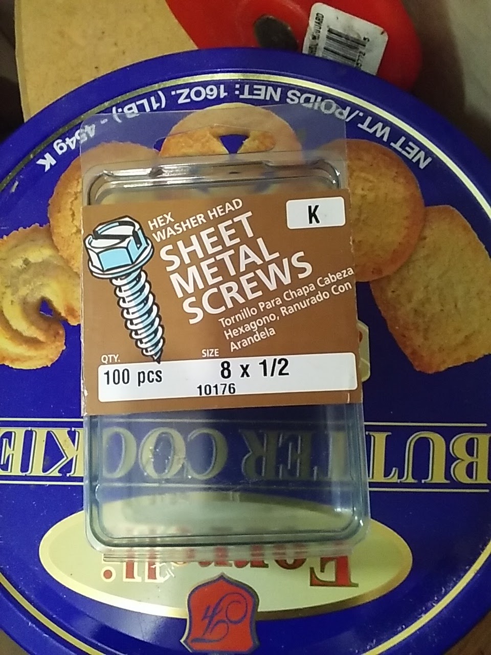

The shorter screws will probably tear out easier than longer ones. I would get the longest ones you can fit without puncturing the tire.
/ Studding tires #23
My thoughts are that given the thickness of the lugs on tractor tires a guy could use some darn long threaded studs, like in many cases almost 2" long!
Think hardened screws that U use to attach metal roofing.
Any self tapping lag type screw by design would be hardened and some are 1/4" and even 3/8" diam.
The longer the grip the less chance of coming out.

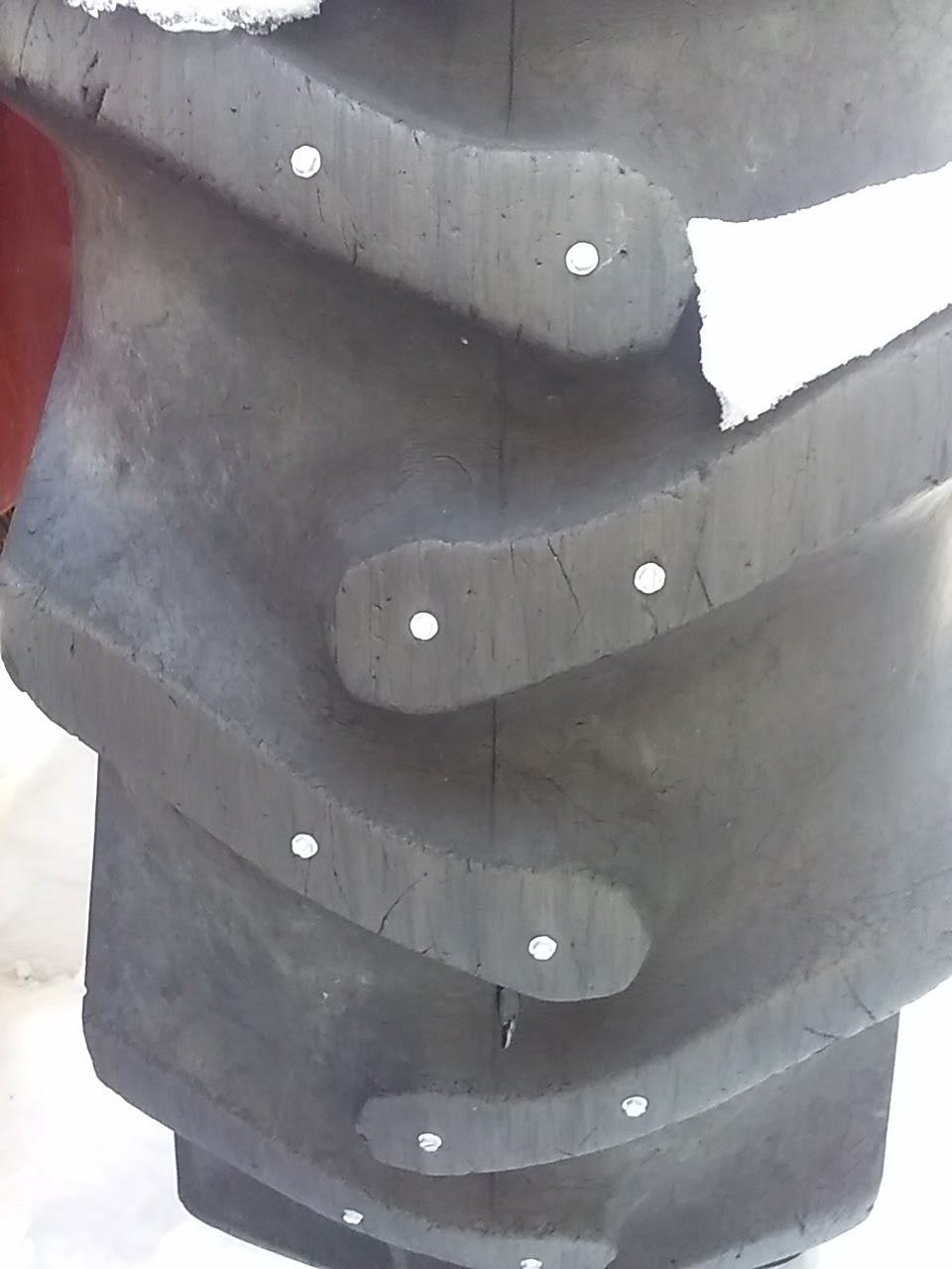

I've used 3/4" hex head screws a couple years now. They stay in pretty well, but its best to put them in with the tire warm so you get a nice dimple. I had a few come loose in the front tires when I was constantly sliding them sideways due to the rear blade trying to rotate the tractor, but now if the snow is that heavy I plow backwards. They don't wear too much as I don't run roads with them and really plowing is only 15-20hrs a winter so I'm still on the first set and probably they will go 10 seasons at this wear rate. I think you could tear them out spinning on tree roots or something like that, but on ice and gravel they seem fine.

Now that we are finally starting to get some thawing weather, I thought I'd follow up. Of the ~150 screws I put in, exactly zero(0) fell out over the winter. I'll be removing them in a few weeks, but keeping them handy in a tub for next winter.

We can assume the self studding helped with traction performance?
Absolutely. It didn't turn my 2WD tractor into 4wd performance, but made it possible to push snow around on icy driveways with the loader and 3pt blade, where before I would just spin if I had either the loader or blade down.
