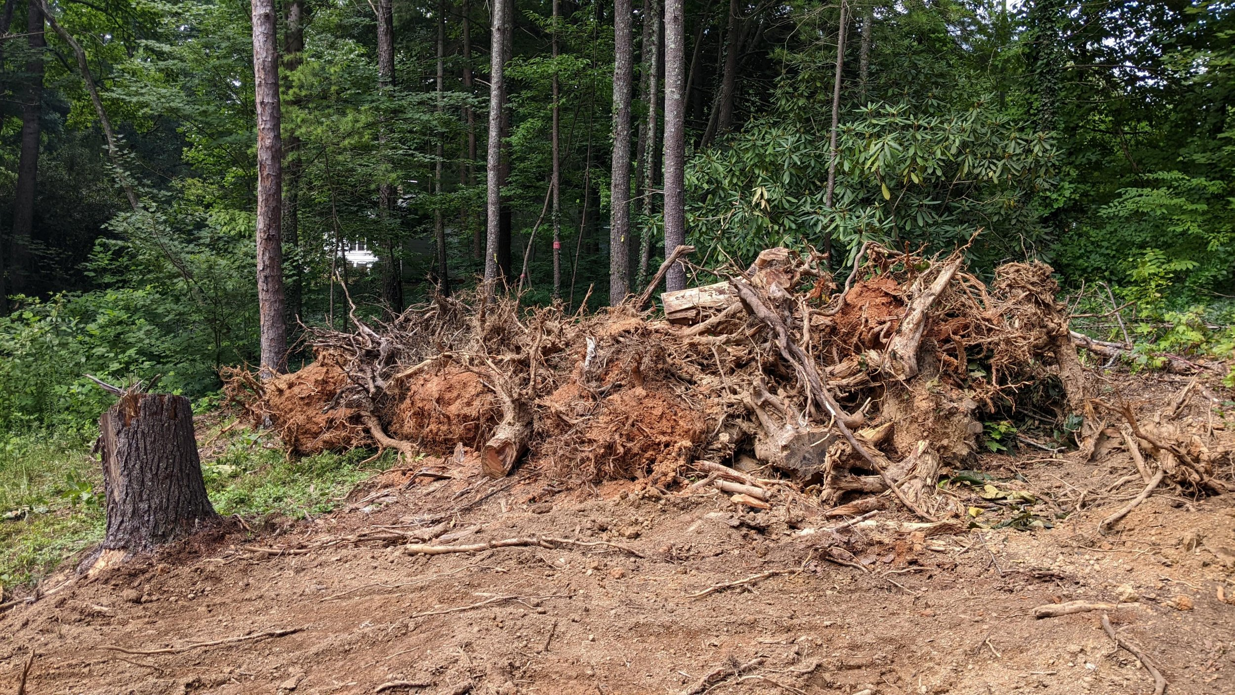

I have a similar stump bucket (All States) for my 40HP in use for 3 months now, but it's been only part of how I go about clearing stumps (mostly lateral roots like loblolly and poplar). The largest stump I'm removed so far is about 20" in diameter (80yo loblolly).
My process is to:
  1. use the stump bucket like a backhoe, meaning, I don't go directly at the stump but work it to expose the root system;
  2. manually with mattock, clean up the exposed root system;
  3. using cheap 8ten semi-chisel on my Stihl MS250, cut the "toes" of the root system fairly close to the stump. I do 2 deep/plunge cuts per root an inch or two apart and eventually extract a biscuit, which leaves wiggle room all around when it's time to pull. I obviously don't get more than 1 good cut at a time with dirty wood, but the 8ten suffers it pretty good, and chisels up sharp enough for the next go.
  4. using a cordless sawzall with 9" or 12" pruning blades, do cleanup and sucker roots;
  5. back to the stump bucket. Without going all yahoo with it, I'll drive into, around and under the stump, until it gives a little on all sides. This part doesn't take long, and I stay mindful of the limits of this machine's hydraulics and frame integrity;
  6. pull! Smaller stumps get the 3-point log skidder and chain treatment. Larger stumps need block'n'tackle for mechanical advantage to pop.
  7. switch out the stump bucket for a grapple, and carry my prize off to the "stump garden" (see pic). The larger ones come out looking a little too much like elephant's feet.
I can do a couple small stumps per day, or a couple days per larger stump. Don't mistake this for anything other than hobby farm level stuff. I'm semi-retired, so may only put a solid 2 hours in any given day. It's slow'n'steady going progress, but extremely satisfying.
For scale, the standing stump on the left is 4' tall and 21" in diameter.
