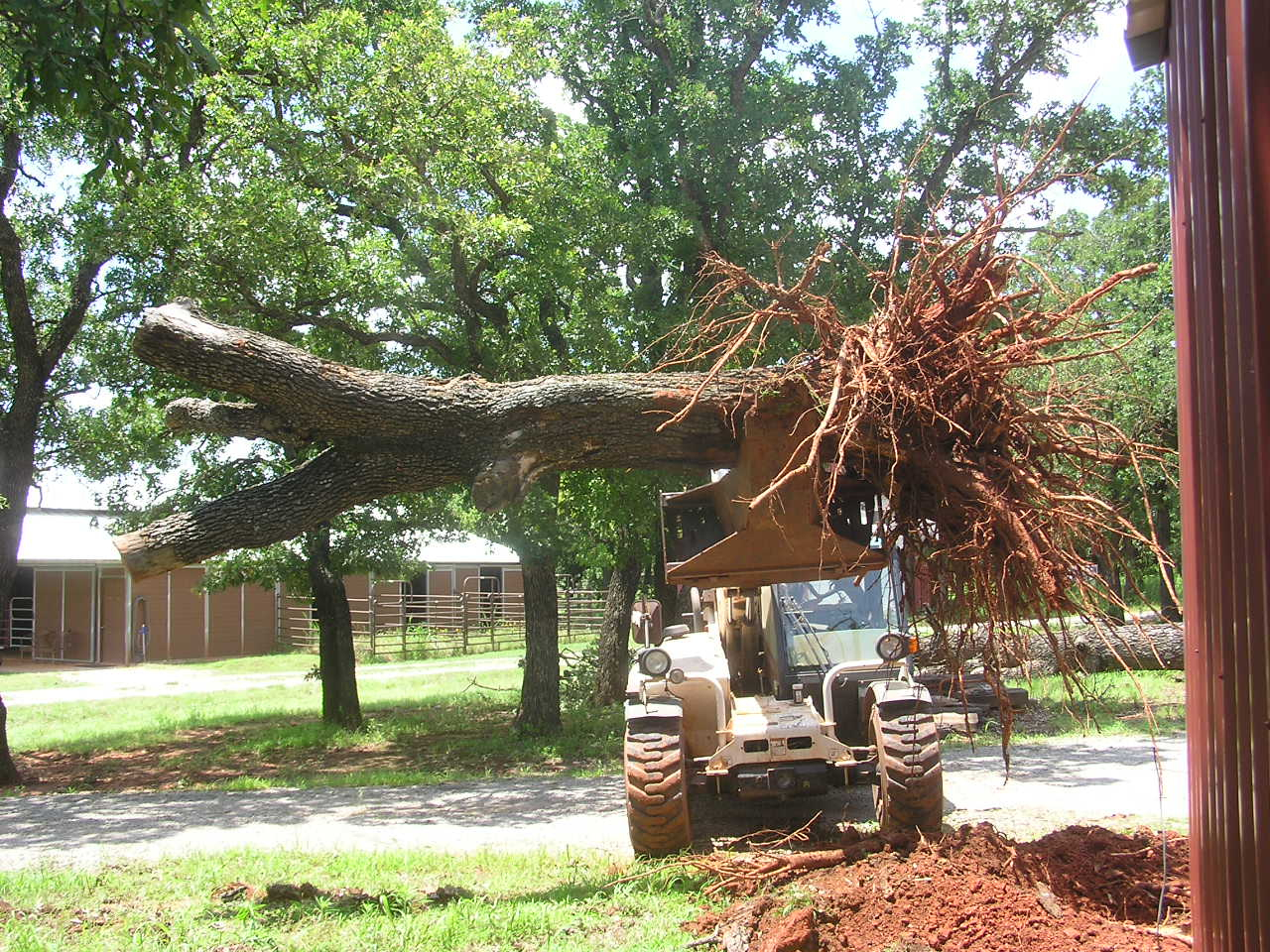

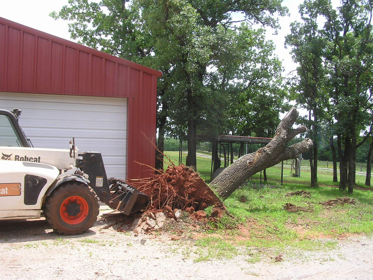

A compact telehandler with a stump bucket is very capable also, click this link to see the pictures: Compact telehandler
