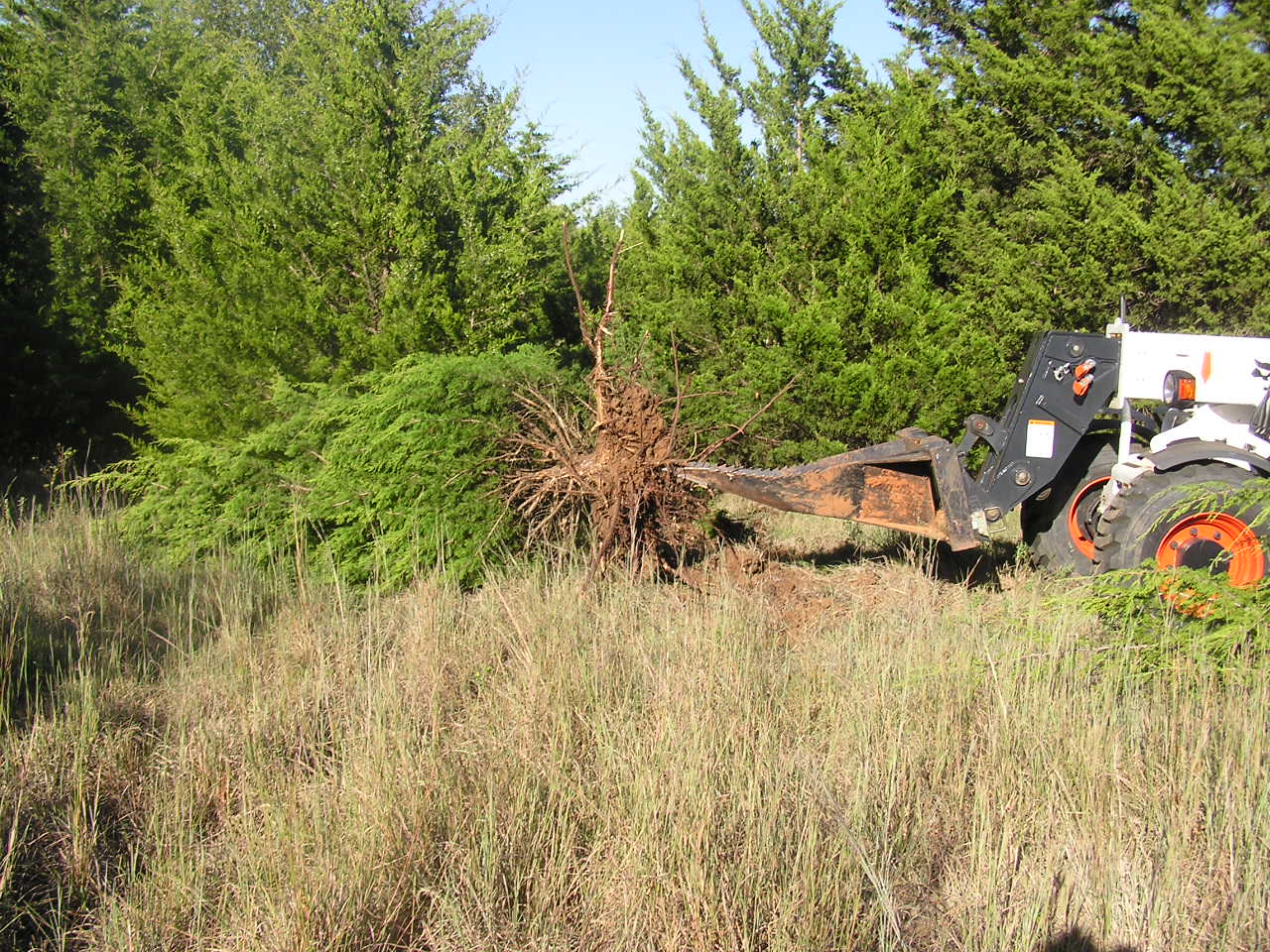

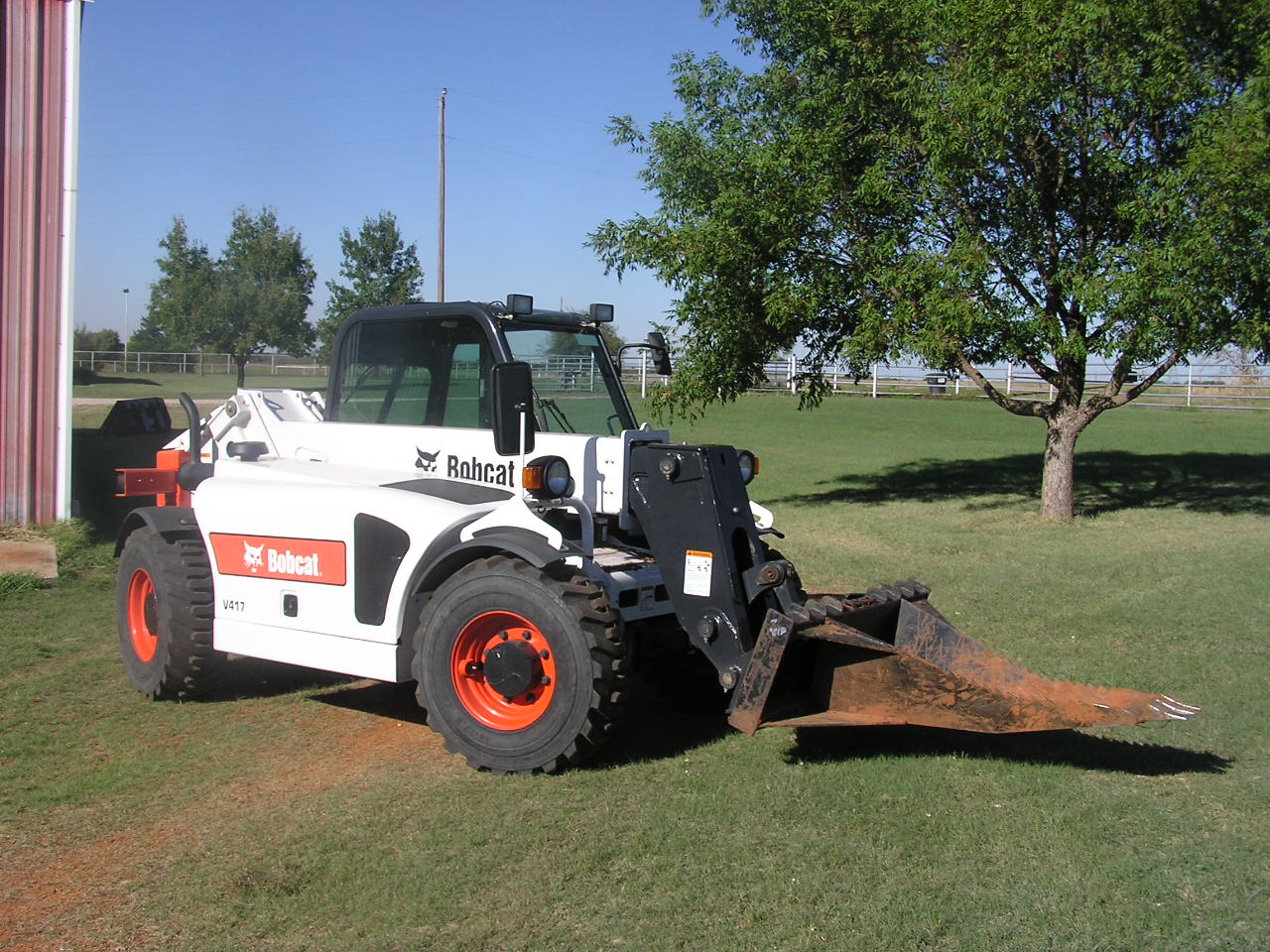

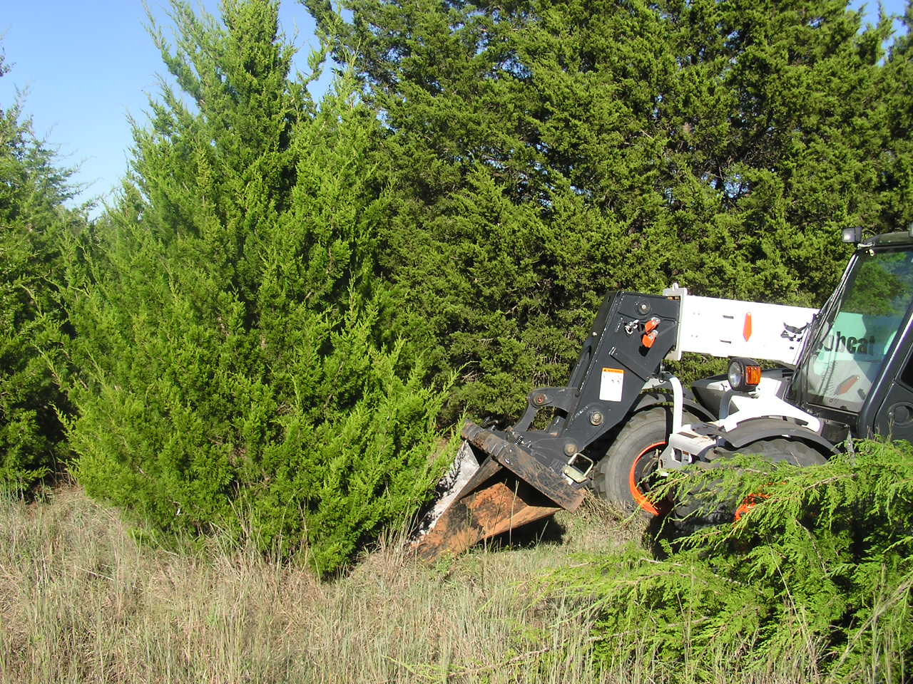

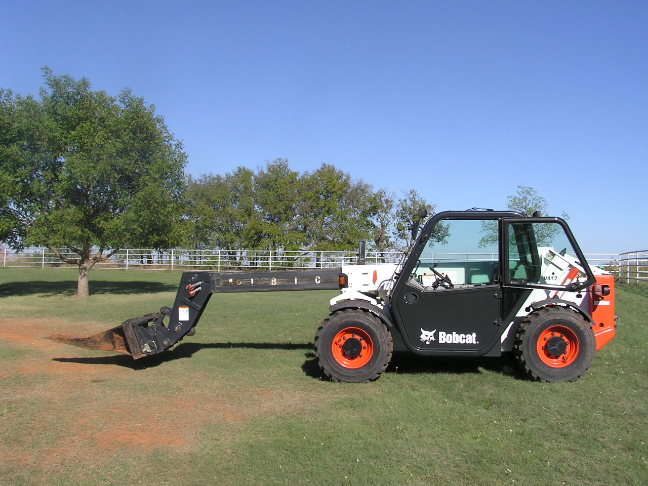

/ Stump Bucket #10
Yep, good design. I have the Blue Diamond version, looks very similar.
Easily pops out cedar trees. :thumbsup:
