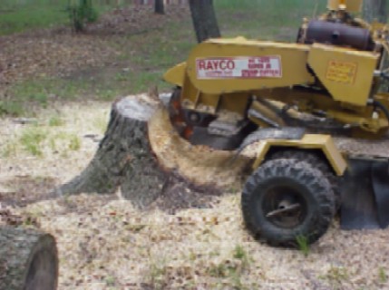

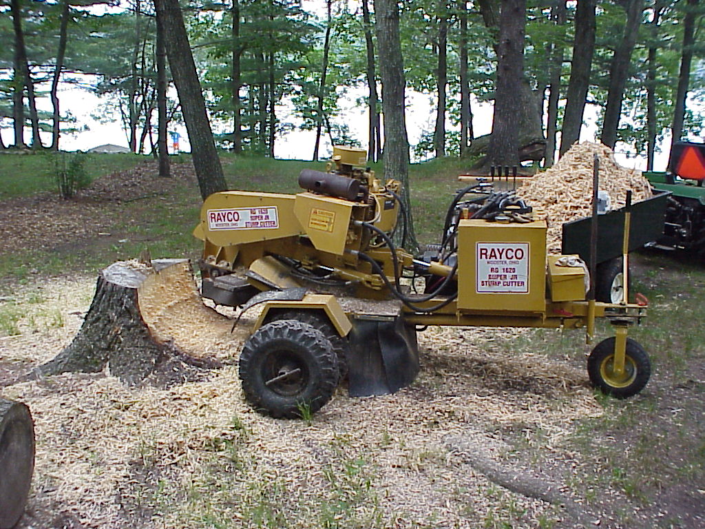

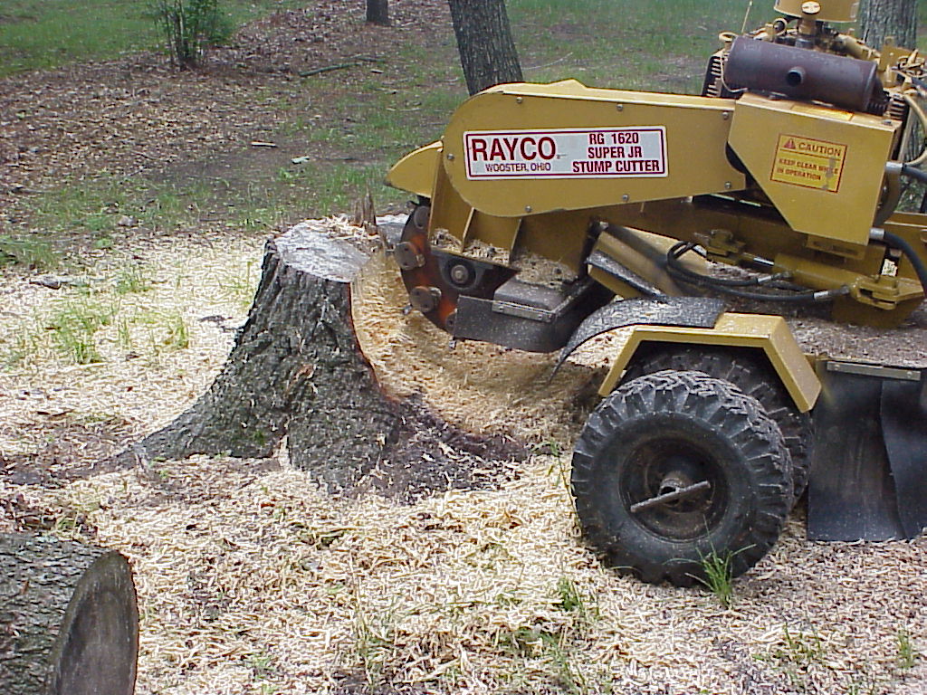

Here's a picture of mine.
Grinder cuts down on the stump. Or counter-clockwise as you are looking at it. Cutter wheel is about 20" in dia - 3/4" plate and has 9 sets of carbide teeth. John
