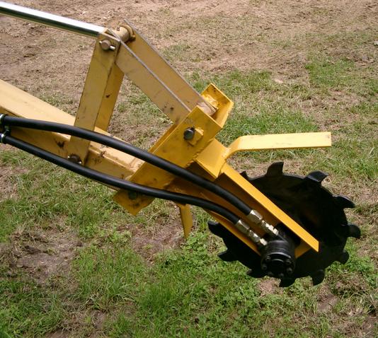

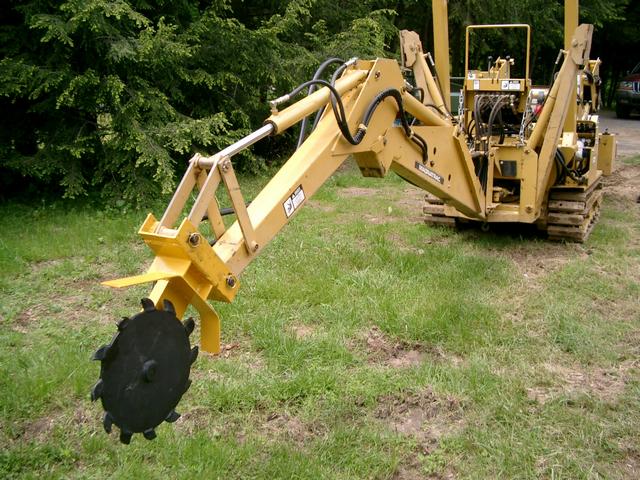

Here's some pix of a stump grinder that I put together for my Magnatrac. I bought the hydraulic motor and cutter wheel from Power Trac (one sized for the PT 425). I made up the bracket to fit on my backhoe in place of the bucket (used 5 inch channel, 3x3 and 2x2 angle). Its gonna take some time to master the technique of effectively (and safely) grinding with it, but maneuvering it with the backhoe controls seems to work good. /forums/images/graemlins/smile.gif
Its fair to say that this is one "implement o' destruction" /forums/images/graemlins/cool.gif

Another view

Closeup of cutter head

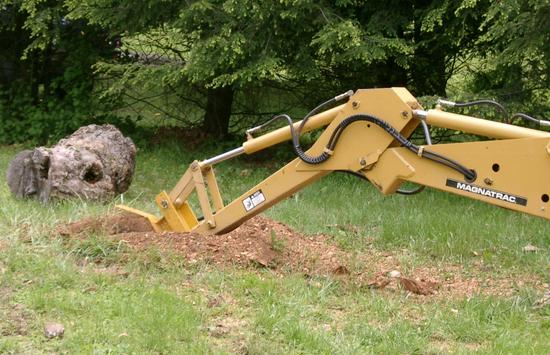

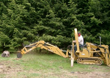

Here are some action shots of the first victim (a 24 inch apple tree stump).

A check after a few minutes to see the progress and to see if everything holding together /forums/images/graemlins/wink.gif So far so good /forums/images/graemlins/smile.gif

This shows the cutter way down below ground level (about 8 or 9 inches - wheel diameter is 18 inch)

They charged me $471 plus shipping. A fully assembled stump cutter attachment was going for $800 at the time. I spent about another $120 on hoses and fittings and about $30 on steel as I used scrap pieces that I had laying around. All total, I built the assembly for less than what PT was charging for their complete assembly.

Excellent! After seeing those chips fly, I understand why you have the cutter extended so far away from the seat. Just out of curiosity, can you reverse the hydraulic connection and blade so that the chips are thrown away from you? Seems if this were possible you could get closer to the stump for better visibility.
   / Stump Grinder #13
<font color="blue"> can you reverse the hydraulic connection and blade so that the chips are thrown away from you? </font>
We've discussed this on the Power Trac forum a few times.
With it rotating over the top away from you, it throws the chips right at you, but also tries to climp up the stump, away from you.
If you reverse the blade and direction of rotation, the blade will try to walk down the stump towards you and down into the ground.
Some sort of screen would be desirable to prevent the chips from coming at you.

I thought about mounting the blade differently so that chips would not come back at the operator. My original thought was to mount it so blade would spin horizontally and chips would go out to the side. I figured that this config would put too much of a side load on the backhoe so I kept the blade rotation in the same plane as the backhoe normally digs. I didn't really consider making it rotate up. The blade hub is not drilled all the way through, so you can't (at least not easily) mount it on the shaft the other way around and making the motor spin the other way. The easiest way to make it spin the opposite way would be by mounting the whole thing upside down so that the motor is on the left side of the unit and spinning in the normal direction. This would require grinding out a couple of welds on my bracket as one end is made to be narrower than the other end (with spacers welded on inside). I wonder why Power Trac wouldn't have done the same thing to keep the chips from flying toward the operator?
I haven't ever used a PT stump grinder, but I would guess that the dynamics would be somewhat different because of the shorter distance between the cutter and the attachment to the main tractor (on the PT). Although I was initially concerned that putting the grinder way out there with the backhoe arm at full extension would cause it to really be unstable, but it wasn't all that bad. I'm going to have to experiment lots more to get the technique perfected, but what I found works really well and protects the operator the most is to open the bucket curl almost all the way (this brings the blade guard pretty much vertical). Then, I move the cutter into contact with the stump using the boom raise/lower and dipper in/out controls. Then, curling the cutter down into the stump really plunges the cutter in. This grinds a slot like using a circular saw. What was a little tough was to make a series of slots with the amount of wood left in between thin enough to knock/grind off with side to side motion. The cutter kept falling off back into an adjacent slot. I'm thinking about a modification to add a indexing pin or plate that would go into a slot already ground and hold the cutter steady so that it could plunge another slot in the wood right next to it. The index could be adjustable so that the wood left in between slots could be varied as needed so that it could be easily knocked off. Sort of like making a half of a lap joint in a 2 x 4 by making a bunch of cuts across with the circular saw and then knocking the thin remains off with a chisel.
