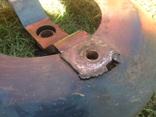

flip it over and weld the backside . i would use 1/8 6011 for all or at least first pass then 7018 .no need to drill if its welded right.
   / Stump jumper welding
#32
I welded the other side after cleaning up real well and I cut another 'v' drilled holes at end of cracks and welded with new box of 6011, I tried to download some pics but I am doing it from my phone and it is not working at the moment it keeps cutting off part way thru the loading process.
Anyway I stitched it in and let it cool slowly, and I put it back together with out the blades on it and ran it at 540 rpm and it ran smooth as silk. I was glad to have no balance issues, then I bolted on new blades with new bolts and nuts spun it again and it was still smooth.
I will keep a eye on it as I touch up the blades on a regular basis being I mow several hours a week and it is a lot of Bahia which is very tough grass.
Thanks for the info and the imput

Well I have been using the cutter again for about three weeks in some pretty tough conditions and so far the welds are holding up real well, I check it after each job and so far so good

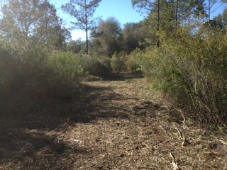

I just wanted to do an update, the stump jumper finally gave up the ghost. It has been 2 years and 3 months since I welded it and I have gave it **** with some of the stuff I cut. I found a jumper on line complete w/ blades and bolts w/ nuts sold as a whole assembly sent directly from Landpride thru a company in Indiana for $318.00 plus $28 for shipping! I was amazed at the good deal because buying it locally was $420 plus tax and shipping which would put it close to $500 with no blades or bolts.
Thank god for the Internet and some research!! I put a pic of the stump jumper and some of the stuff I have cut with it. I am sure when cutting large stuff,3" or so that when the material gets hung up between the top of the stump jumper and the bottom of the mowing deck, that is what tears up the jumper. I have made a lot of money with that Landpride cutter and will be happy to put on another stump jumper especially at such a good price. I look toward to getting another few years service from it.

In a day I only owned AC welder 1987 I bought a worn out Bush Hog 105, the stump jumper was cracked open and opened up a good 5/16" gap at each end of the blade holder. 26 years later after a life of alarming abuse, and perhaps 10 grind it out, gap it and weld it with 7018 I finally decided it was getting to be sufficiently dangerous, and enough stumps have been removed. I used acetylene torch to remove the stump jumper entirely. It works as well as ever. These things are scary, blades are heavy enough to take your head off, and they sometimes fly off at full speed. I once lost one, along with any portions of the bolt that held it. 20 years later, I've never found any of it. It is either underground, or hundreds of feet away.
