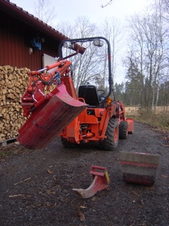

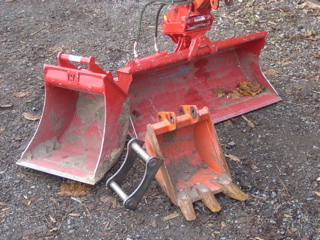

good post so far. I am wonddering how long does it take to actually swap the bucket to ripper and back ? is it hard/easy or just time consuming ?
Heres a quick coupler for my BX24
More pics on the "best modification on your bota"
/Sam
