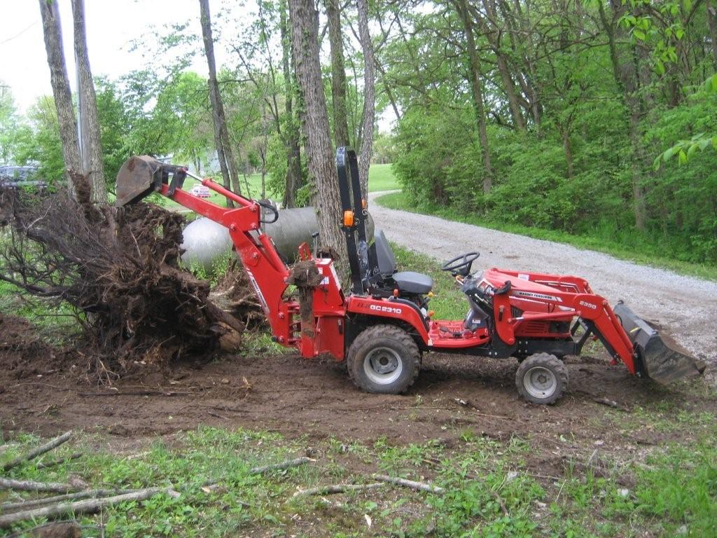

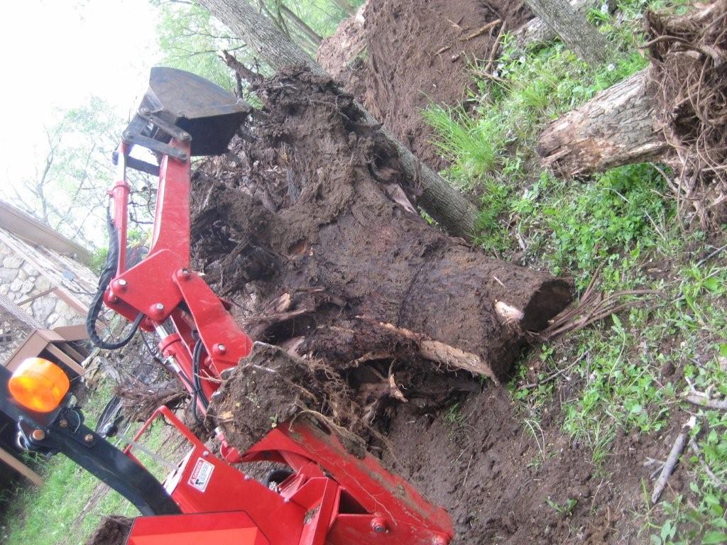

Haven't you guys heard. Size does not matter, it's how you use it. I have a little MF2310 and have become quite skilled at removing stumps and ones far larger than the one in your photo. First is digging deep, at least 4'. I typically go to 5' if it is 12" or larger. This enables you to loosen the tap root. Other trick is to tear the roots with the bucket in small bites. I typically point the tooth of the bucket down on top of the root, press down to put as much weight on the root and then curl the bucket and it tears the root. In addition, keep your stumps long if you can. This helps with leverage when trying to pop that tap root out.

Depends very much on type of tree and ground. My oaks have root taps that go much deeper than the stump you got the picture of, including the stump. I've dug 5 foot and not even gotten to the base of the stump where the tap begins, much less being able to break the tap. Took a 25000lb machine to have the power to lift the stump out of the hole once freed. There was no way my 7.5 foot hoe could've gotten to the tap much less break the tap, I've not hit roots I haven't been able to adventually break, but the tap is another story all together.
Also, after 3-4 hours of continuous digging with little progress, was much easier to get the larger machine and do what I couldn't have done period with my machine, done in 10 minutes.
As I've said in the past, I don't think there is anything tougher to work with than hardwood stumps.

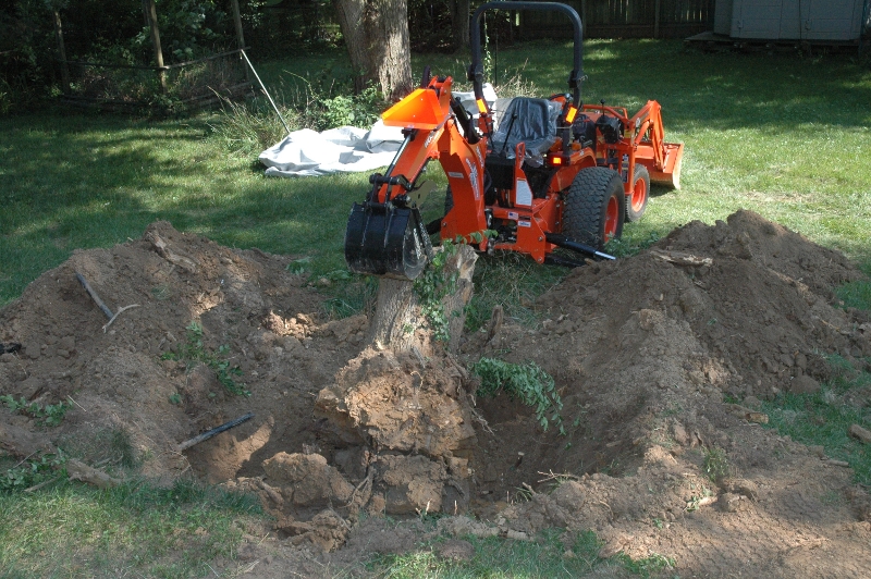

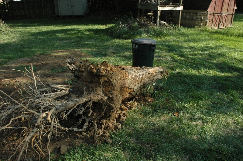

If you've got a true tap root I THINK the best thing would to dig as deep as your BH could go, angle in and call in Stihl.
I was just about ready to do that until with a lot of wiggling I broke off my little one.
