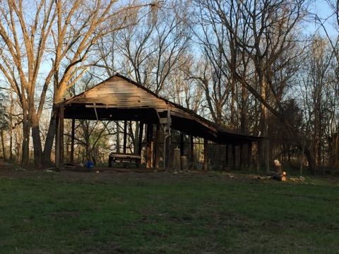

I have a barn that I am redoing that had grown up pretty bad with trees around it.. Just trying to clean up around the barn and make travel around it easier..
