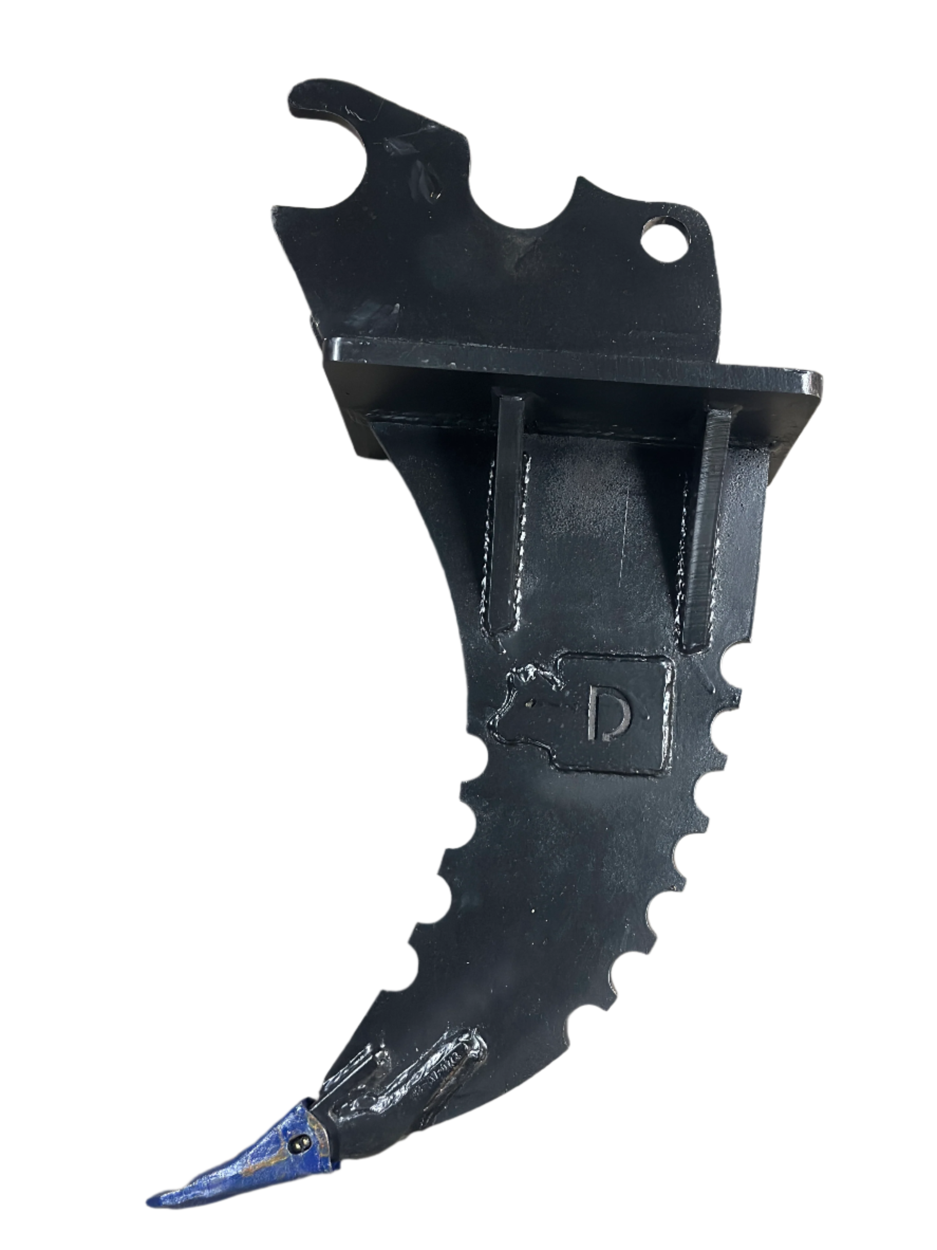

I have a KX71-3 compact excavator. I see a ripper like this but seems not ideal for stumps.
I see this but seems like cutting a root at 2 spots isn't ideal. (Yes I know it is not for my model, I assume they could make one though)
I kind of like this one although it is a huge thing made from 1" steel where most are 3/4" or less. I can't cut >3/8" steel but I can weld on teeth.
This looks good but dang $1500.
What are your experiences removing stumps w/ similar excavators?

I have the USA ripper with the smooth body. Based on previous experience with a skid steer stump bucket that was serrated I feel like the serrated edge was better. I’d buy a ripper with a serrated edge if I was buying again.

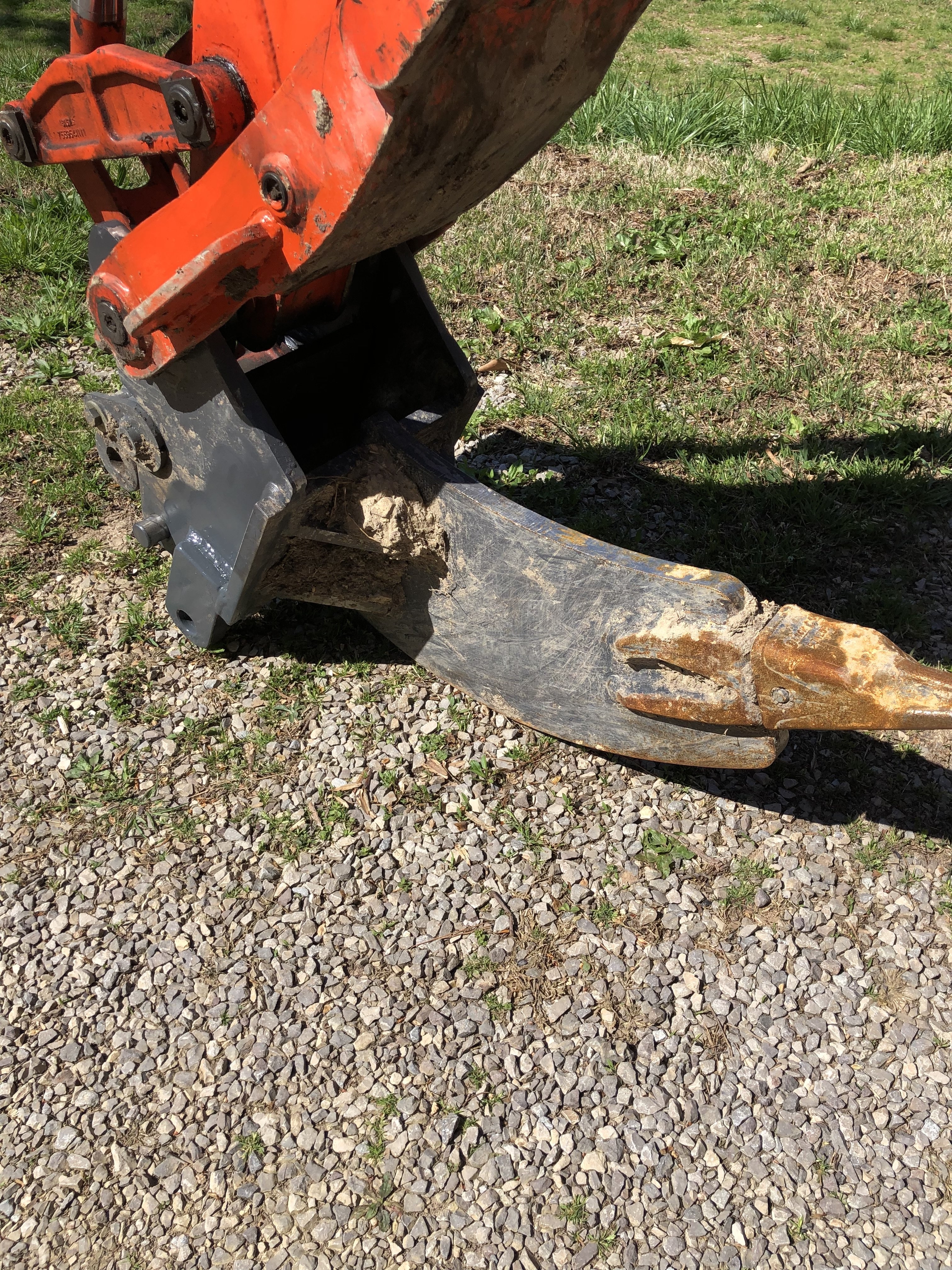

Single tooth works better on roots than a narrow bucket for smaller machines

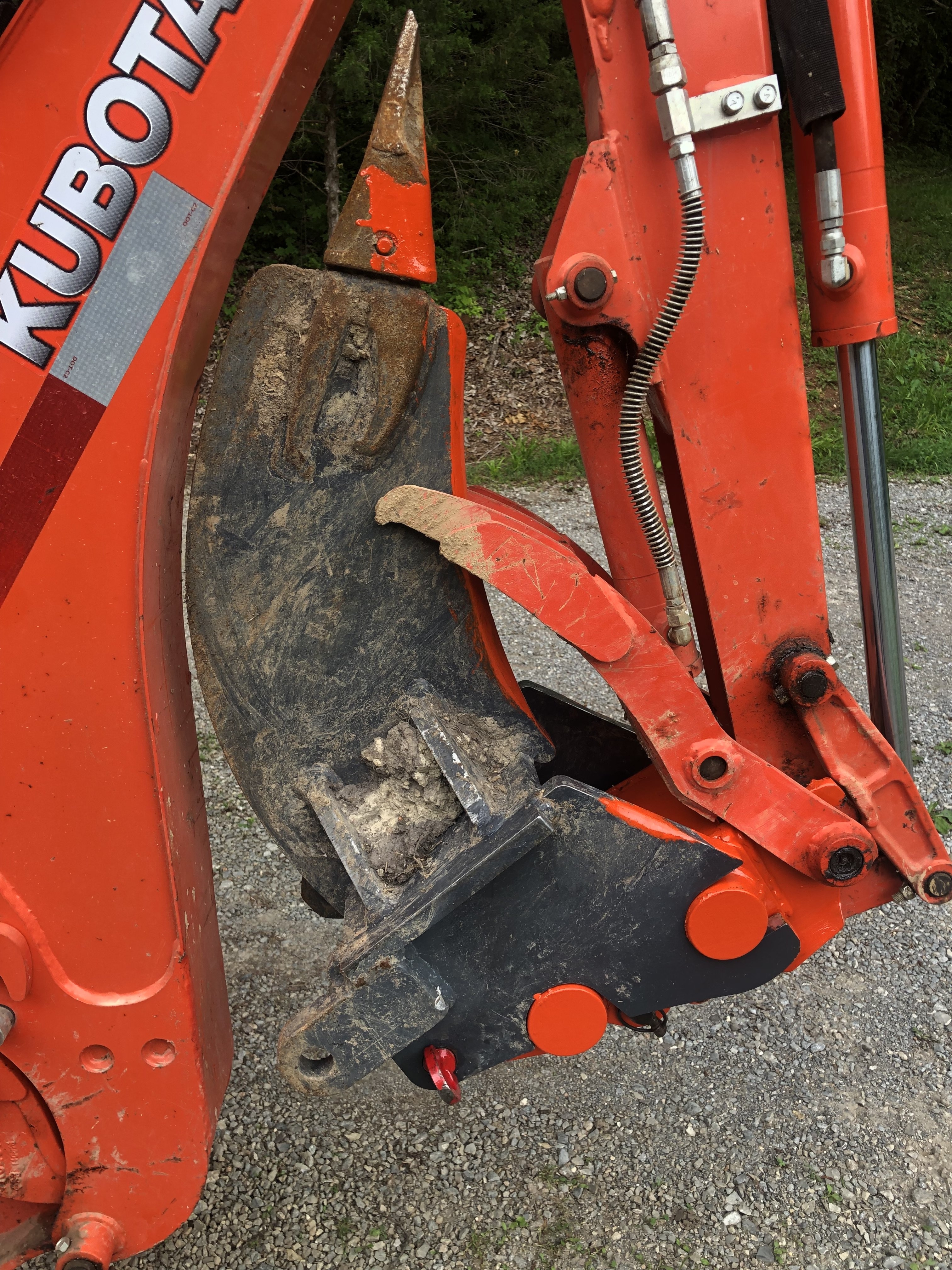

Here's a link to the one I fabbed up for my M59
/ Stump removing help #6
Have a kx excavator ripper from USA attachments on Kubota M59. It cuts roots better than a narrow bucket. Don’t have the power to cut big roots. Easier to probe thru soil without excavating. For big stumps it helps find large lateral roots out from stumps. Use the roots length as a leverage to break them off near the stumps is better than just cutting them. Ripper does save time removing stumps and trees. Much rather dig a tree out than a stump.

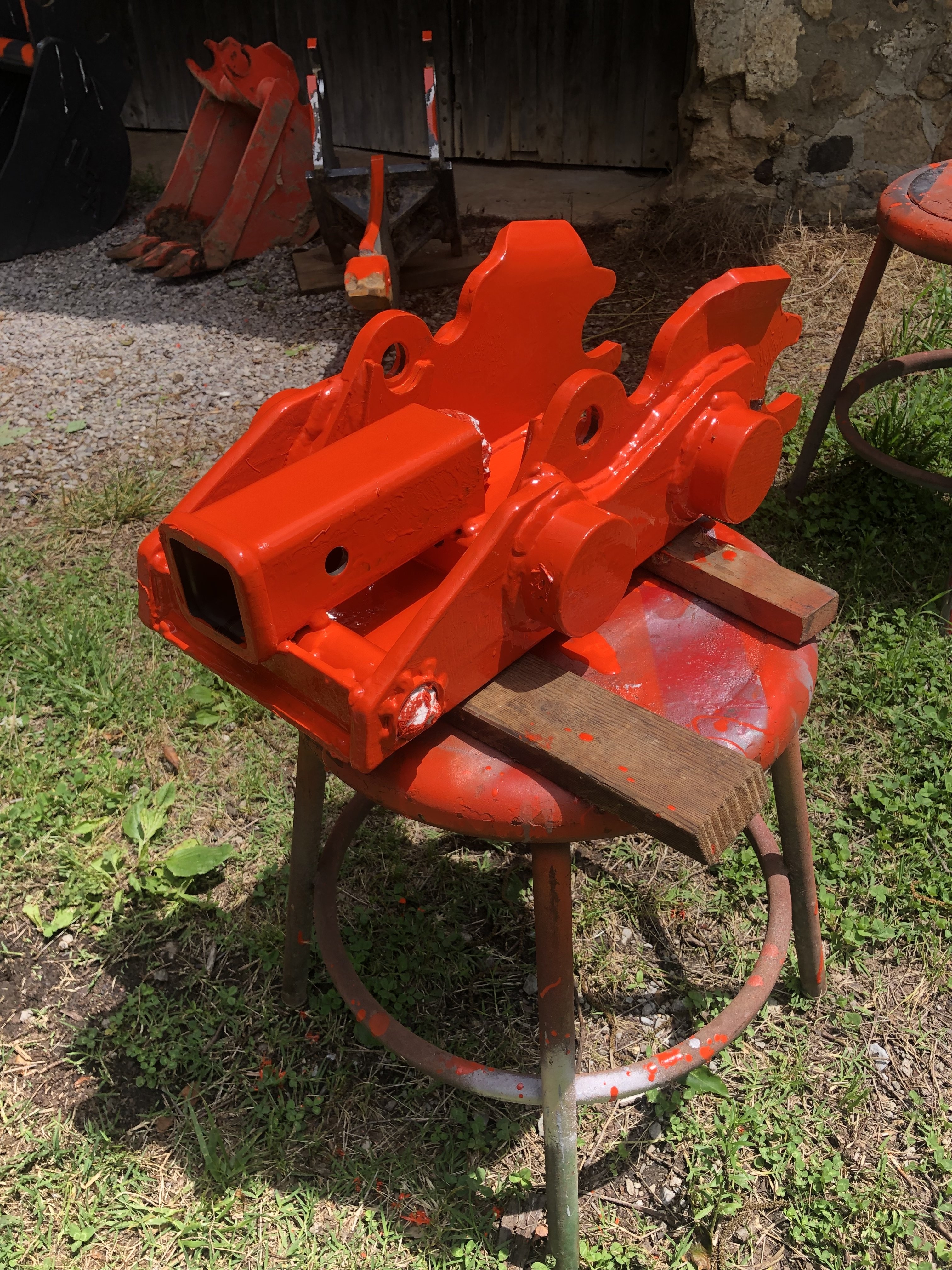

Did weld some ears to the back of the ripper in order not to have pick up or block under to use the quick attach. Also handy chain attachment points. Made adapter to share ripper with smaller B26. Did bevel the leading edge and sharpen tooth.

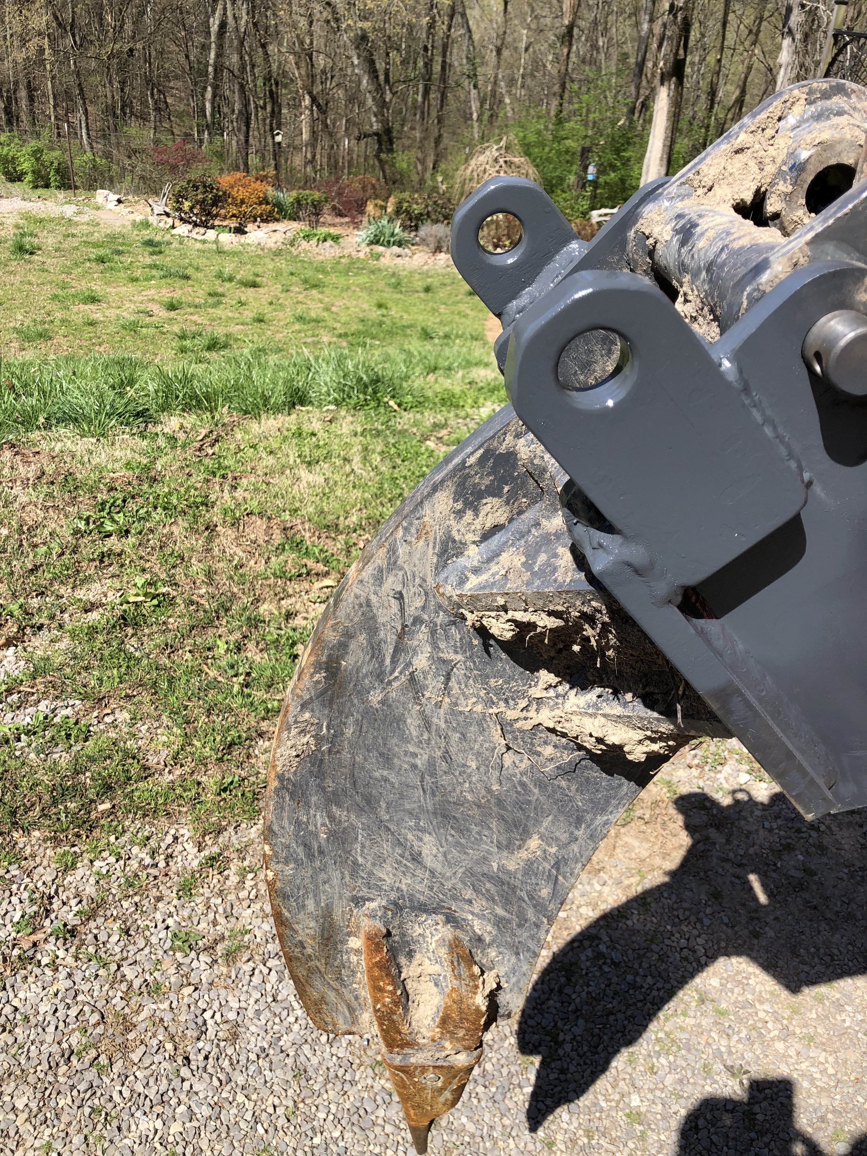

I ended up getting this 8" toothed bucket in the version that fits my machine.
Had it now for about 3 weeks. It is much better than my 22" bucket. I make a smaller moat around the stump. I seems to rip up snapping a root more easily since it is pulling a lot closer to all in one spot. I can see that a ripper would be better still but it is kind of a one use tool. I've tried but haven't worked out how to make good use of the teeth yet. They may be doing something but I think I may need to grind them as they are made from 1/2" steel plate. So a sharp point looking from the side but looking on the edge the point is 1/2" wide.

While a smaller bucket helps with stump removal, it’s still different than a ripper. Used a small bucket on several different backhoes decades before trying a ripper. It traces out lateral roots better to remove them. In short gets more wood out of the ground with less excavation and collateral damage. Large stumps about half the time vs small bucket. Takes a while to recoup investment.

Yep my 8" bucket is plugged as I type. Not as good as a ripper probably but way better than 22" bucket.
