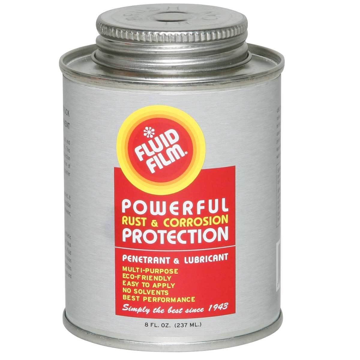

Received my tractor back from the recall work. They said when they received it the bucket was very hard to get off. He had to hit the pins from underneath to pop them loose. After that he didn't have trouble with them. Of course I never had trouble getting the bucket off right after I put it on, but yesterday and I did some work with the ratchet rake on the bucket and when I got done I decided why not try and get the pins up. I pulled and it took some effort but I was able to do it by hand. He did grease the pins and bent the handles back closer to where they should have been. Gives me optimism about fluid film working for me. Hope to try this weekend when i get rid of this stomach bug. Thanks for all the feedback! I'll update how the fluid film does.

How long does Fluid Film seem to last on pins and such? Does it wash off or wear off? I bought a couple of cans to try but haven't had a chance to use it yet.
   / stupid question - bucket removal #68
I expect fluid film will need to be reapplied about once a month with moderate use. I keep a can in the cup holder on my tractor to spray everything that moves that doesn’t have a grease zerk. I like that it pretty much goes where you want and stays there. It’s doesn’t just run off like light oils.
   / stupid question - bucket removal #69
Thanks Dave. Does it appear to creep well and get in to all the nooks and crannies? I just can't believe a lanolin based product with no solvents can work miracles. I want to believe because I hate corrosion.
   / stupid question - bucket removal #70
I put some on a rusty bolt and nut, a couple of days ago, and when first applied, it bubbled a bit then just soaked in. They came apart easily yesterday.

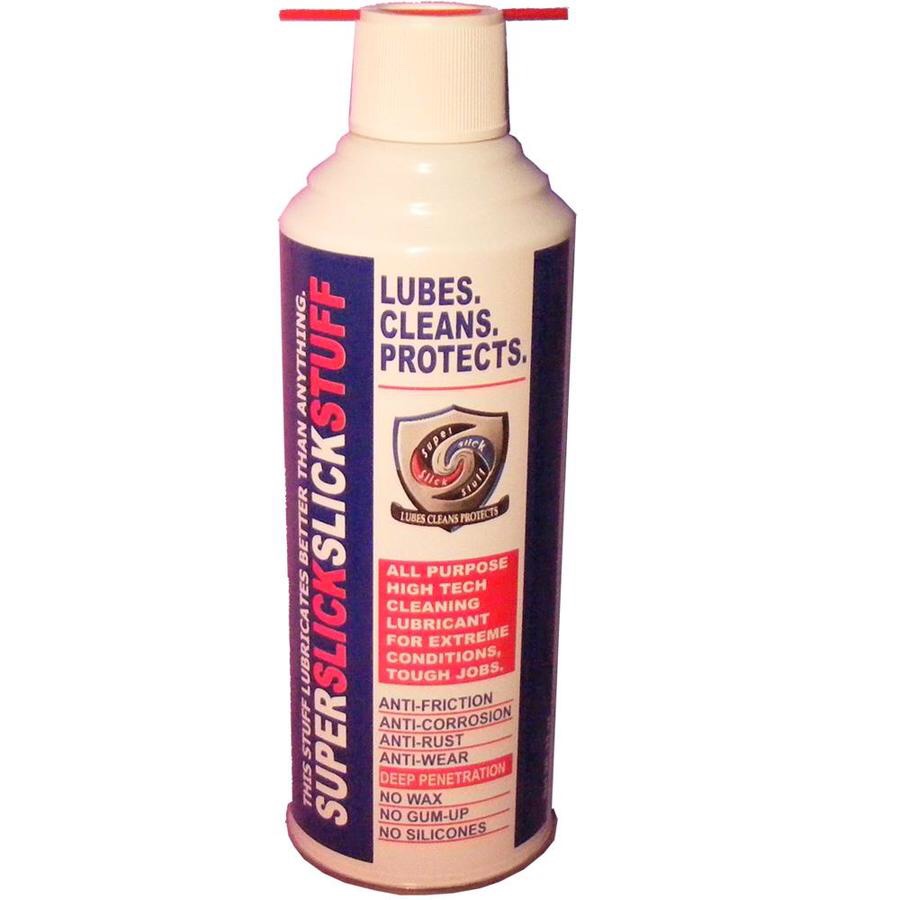

Another product called “Slick Stuff” was suggested, on another thread so I grabbed a can at Lowe’s the other day. Haven’t had a chance to use it yet. Looking for something to do a side by side test against Fluid Film. FWIW the Slick Stuff is about same price as Fluid Film, at Lowe’s.
Edit: You can also get Fluid Film in a gel form with brush applicator can.
