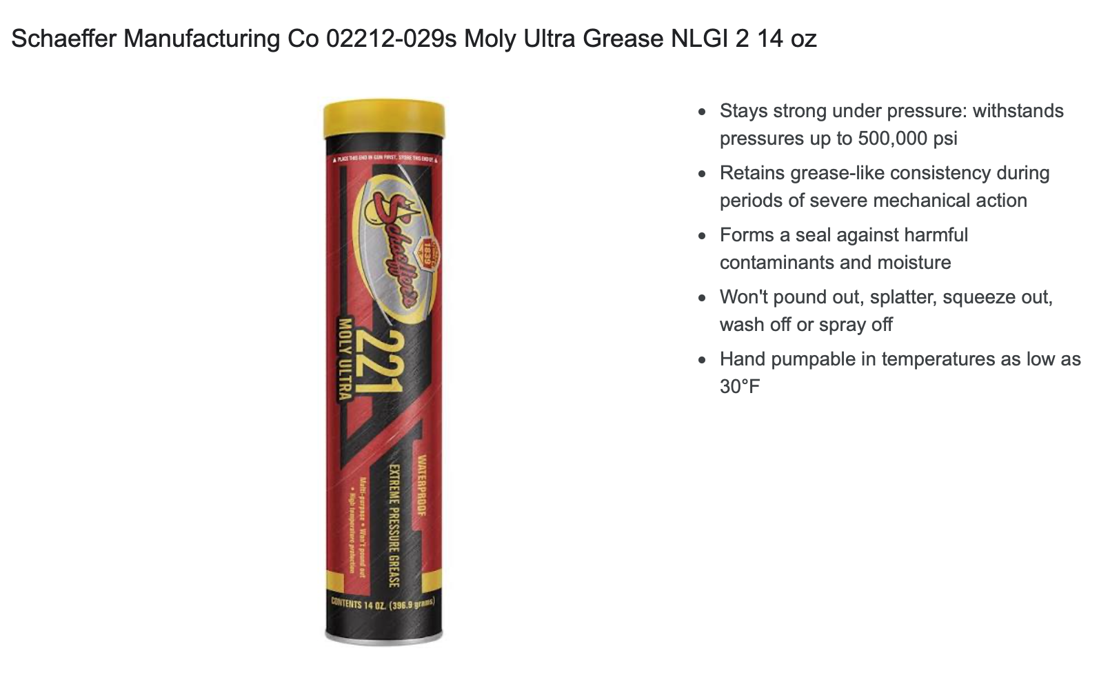

The reason the previous owner gummed up the grease ports (when he did grease it which was obviously infrequently is, he used cheap clay based grease that hardens after a while. Use a good synthetic grease about every 10 operating hours and you'll be fine.
I use this stuff:

That will work. Just stay away from the cheap Tractor Supply bargain grease. It's all clay based.
