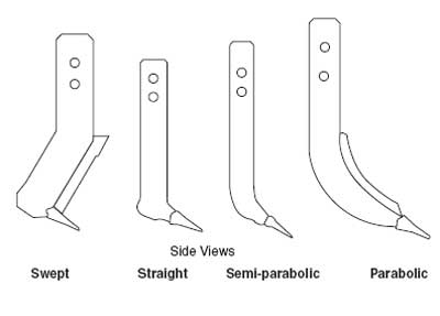

I use a Hay King brand and it can run 10-12" deep. It has an adjustable coulter in front of the blade for ripping at the surface and the blade is long and sharpened. The shank isn't.
Mine has 2 bolts per shank, a main retention (pivotal) bolt and a much smaller sacrificial bolt whose purpose is to be the sacrificial lamb on things such as you mention.
If I had a root problem then yes, I'd sharpen the cutter blades more and sharpen the shank........why not? Can't hurt anything and who knows might help you through a potential breakdown situation where you'd at least have to stop and reset the shank and rebolt it.

To cut through trash, the sharpened, swept-back shanks are often recommended, if not using a coulter to cut through.

I got a 1x6" chunk of AR400 today for my sub soiler shank and now the question is whether or not to bevel the leading edge above the tooth or leave it flat?
Does it make any difference?
We sell the Fred Cain and Dirt Dog subsoilers and both come with the leading edge beveled. They will pull a little easier this way. Ken Sweet
I can't give you a comparison, but I do have an old homemade SS with the shank made of 1" hard steel, beveled. With my little L3400 it will cut through smaller roots (1"-3"), but when I hit the big guys - that's a show stopper.
My WAG is that you won't hurt anything by beveling the leading edge, but you're not going to make a grown-up tractor out of a garden tractor either.
