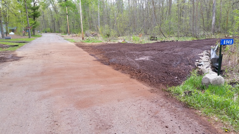

I'm not subsoiling in the ROW. I nuke it with roundup to kill everything since my neighbor's across the street whined about the grass I planted to out-compete the thistle and then the town mowed it and the thistle came back in full force. So now they can look at dirt. Since there's nothing but dirt there anyway, I decided to dump my stumps across the street from their driveway too. I hope they like the view they got - my grass was 7' tall by the 4th of July and all seeded out. It was pretty and the deer loved to bed in it while chewing cud between sorties on their gardens. :D
I own the right side of the street all the way to beyond where the garbage can is at the end. The road is a 45 degree angle to the lot lines (which are N/S/E/W) and my NW corner is about 20' to the left of that can.
