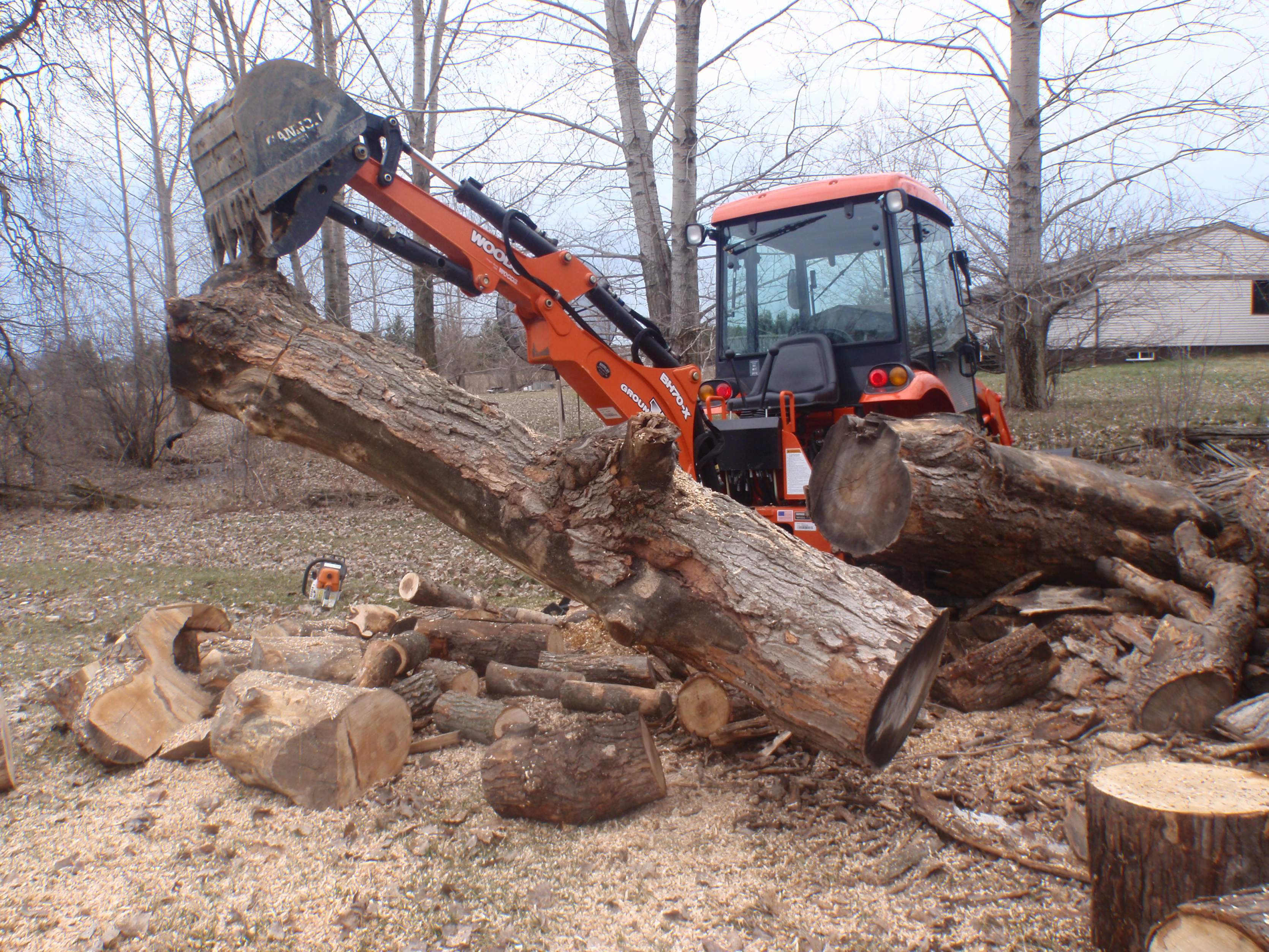

Until a couple weeks ago, I had a Kioti CK30 with Woods BH-70x backhoe with thumb. The Kioti is a heavy tractor for it's size, the tires were loaded and the rig worked very well. the bh was incredibly powerful and could still move the tractor around if you weren't careful, although it couldn't clear lift the rear end off the ground. Weight is a good thing for a TBL.
