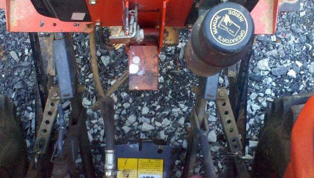

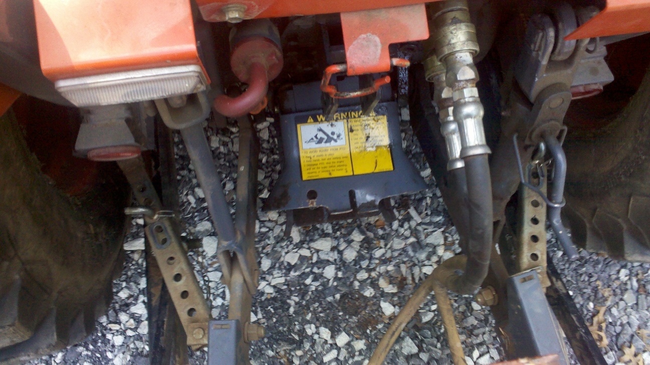

A member requested photos of my 3PH arms left on with the backhoe. I thought I'd post for all to see.
My backhoe is a Rhino. So mounting style is surely different by mfr. Note the pins for the stablizers are behind the sliding member. This lets them float in as far as they want/need, but only out so far. Also note they are inside the backhoe frame.
Not sure these are helpful, and it's hard to get a good view.
While Kioti let's you do this, and it's nice to be able to leave in place, you do have to be carefull that mindful of where they are when putting the hoe and taking it off or you can bend the stablizers (I know first hand :( )
BTW, you do have to remove the toplink.
