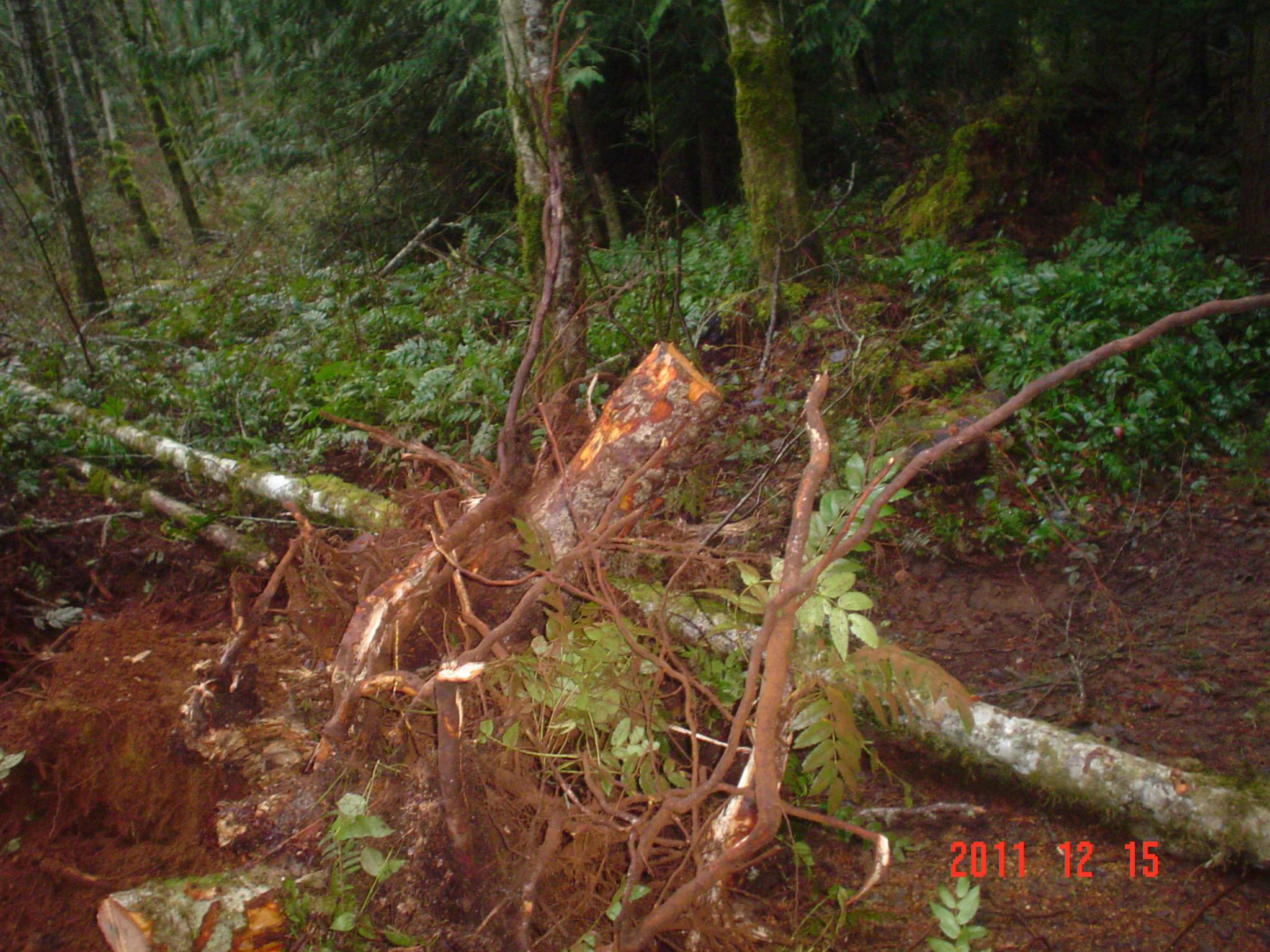

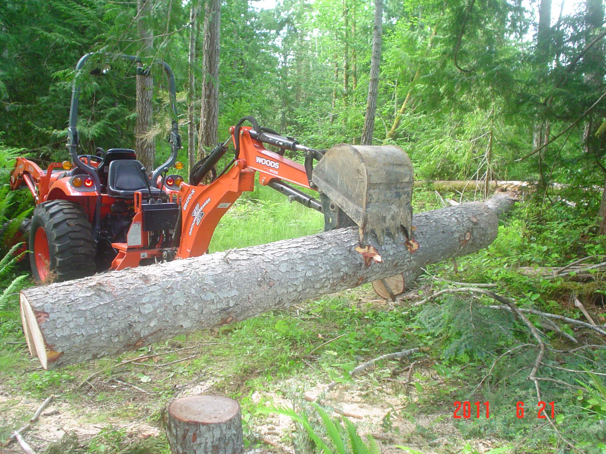

Have a Kioti CK35 HST with a Woods BH-70X backhoe complete with thumb.
Most of my property is treed and having the thumb was a must for me.
Great setup and really happy with it. :)
