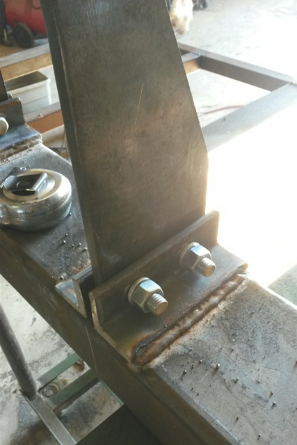

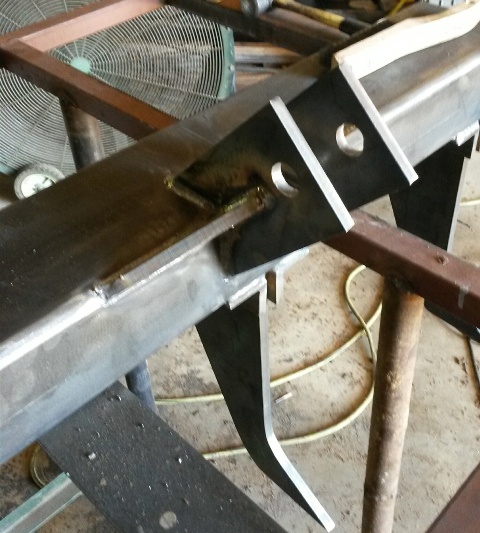

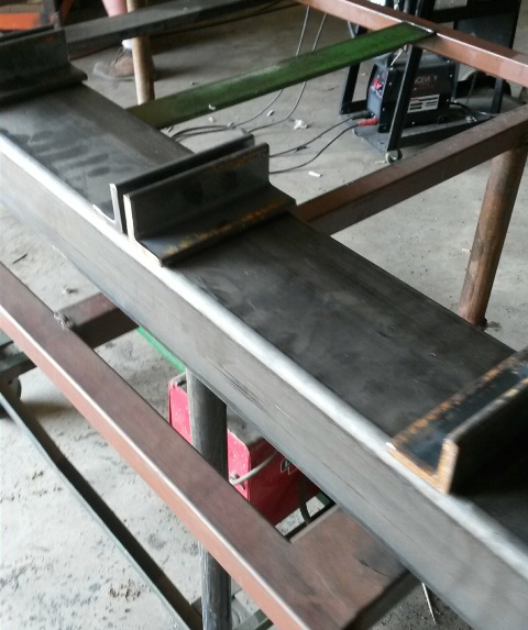

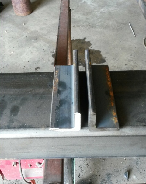

Just thought I'd share some pictures ... got a start on a subsoiler.

Looking good man! I'd run full seam welds on the front's and rears of the tine mount brackets. I would also make wider swathes, and get that super hot penetration into both weldments. Looking great though. Keep it up! Still totally jealous of your plas abilities!!!!
   / Subsoiler build
Oh yes great advise ... I always in situations like this give it a second run HOTTER and WIDER ... I'll keep pictures coming!!!

Smart man! I figured it might be a little too early to call that out. What's your soil like?
   / Subsoiler build
Sandy Loam then that hard red clay

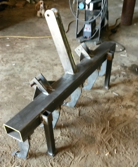

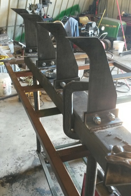

A little more progress ... lacking braces on the top link and paint!!
NO ITS NOT A DIRT FLOOR ... had to suck up some oil!!!
   / Subsoiler build #7
You & your plas. table are really starting to piss me off:laughing:
Looks real nice:thumbsup:
ha ha .... better to be pissed off than pissed on!!!
