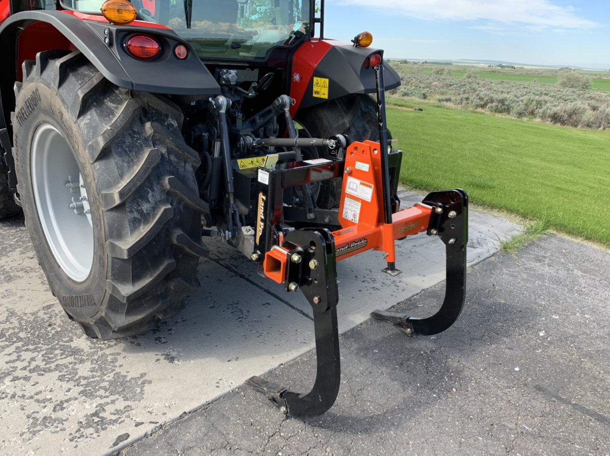

I ended up ordering a small, reversible subsoiler. If it will lift a 300-pound rock up to where I can get it with the loader, it will be better than gold.

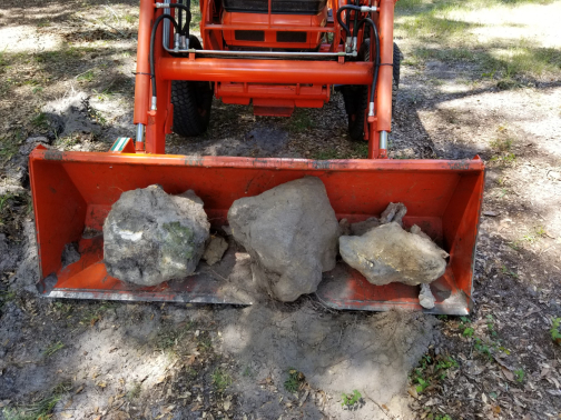

I ordered a subsoiler, and I picked it up a couple of days ago. I put it on the tractor and hooked up on the rock. It would not budge. It was probably hung up on a root and whatever rocks were down there with it. I turned the tractor 90 degrees and tried again, and the rock came right out.
Fortunately, I had two large guys here with me. They rolled the tractor into the bucket, and now it's part of my collection of big landscaping rocks. The bucket groaned a bit. Heavy rock.
I would say it's about 30" wide and 20" across.
I didn't turn the subsoiler around to face forward because I was lazy. This made it harder to disengage once the rock was out.

Interesting fact about the subsoiler: the shear bolt appears to be metric. I busted it on a stump, and when I compared it to imperial bolts, it was somewhere between 7/8" and 1/2".
   / Subsoiler for Yanking Rocks? #26
What are the markings on the head of the bolt?

The bolt head has these marks on it: "SC" and "BB."

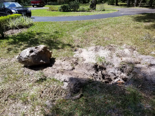

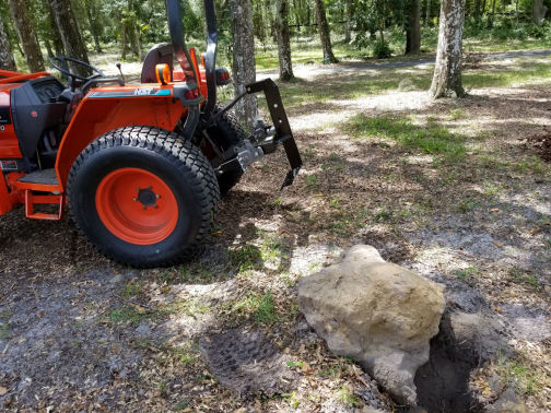

More rocks. This thing is a blast.
I recall having one with a 9/16" or 5/8" grade 2 shear bolt in it. That's what I think you have.
