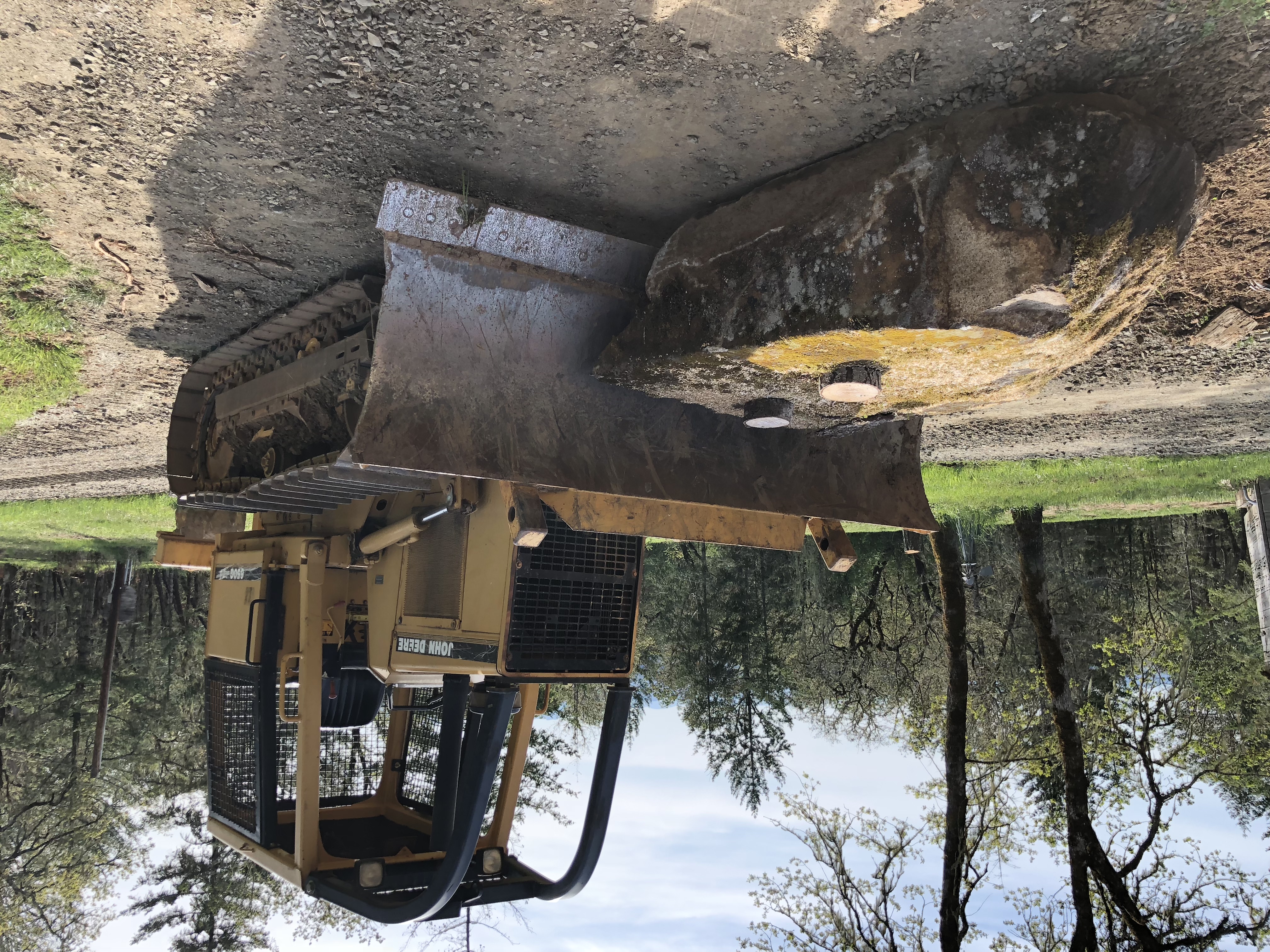

A subsoiler is what I essentially use to pull up rocks. Albeit it's mounted on the back of a dozer. ;)
My property is full of rocks as well. The best way to get them out of the ground is with an excavator, but the ripper works pretty well too.

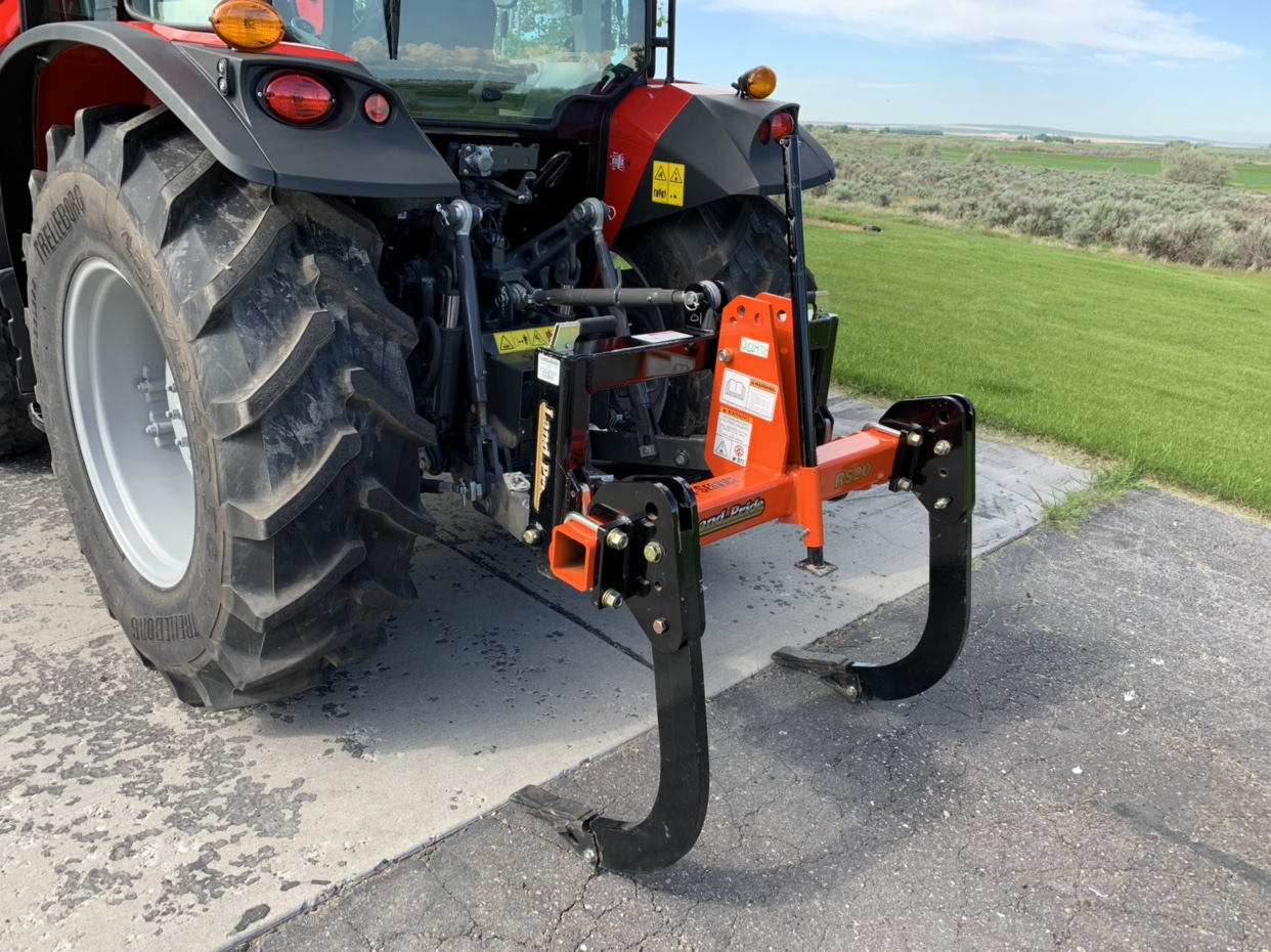

I know I am late to this post but wanted some advice. I am getting a 70 hp tractor and wanted to use a Subsoiler for pulling rocks. I am considering either of these:
RS15 Series Ripper Shanks | Land Pride
Or I getting a heavy hitch draw bar receiver and adding this
Ripper / Middle Buster Plow / Subsoiler Plow / Potato Plow
Does anyone have an experience with either of these or can provide some advice?
A 70hp tractor will destroy that heavy hitch impliment. It's a cat0 or Cat1 impliment designed for something topping out at 45hp or so. What Category 3 Point Hitch Do I Have? hook anything at all with a Cat1 impliment on a 70hp tractor that has weight & traction you'd expect from a 70hp machine & it will twist things into a pretzel or snap it off.

The land pride ripper is rated for 35 to 80 hp. Do you think that won’t work either?
