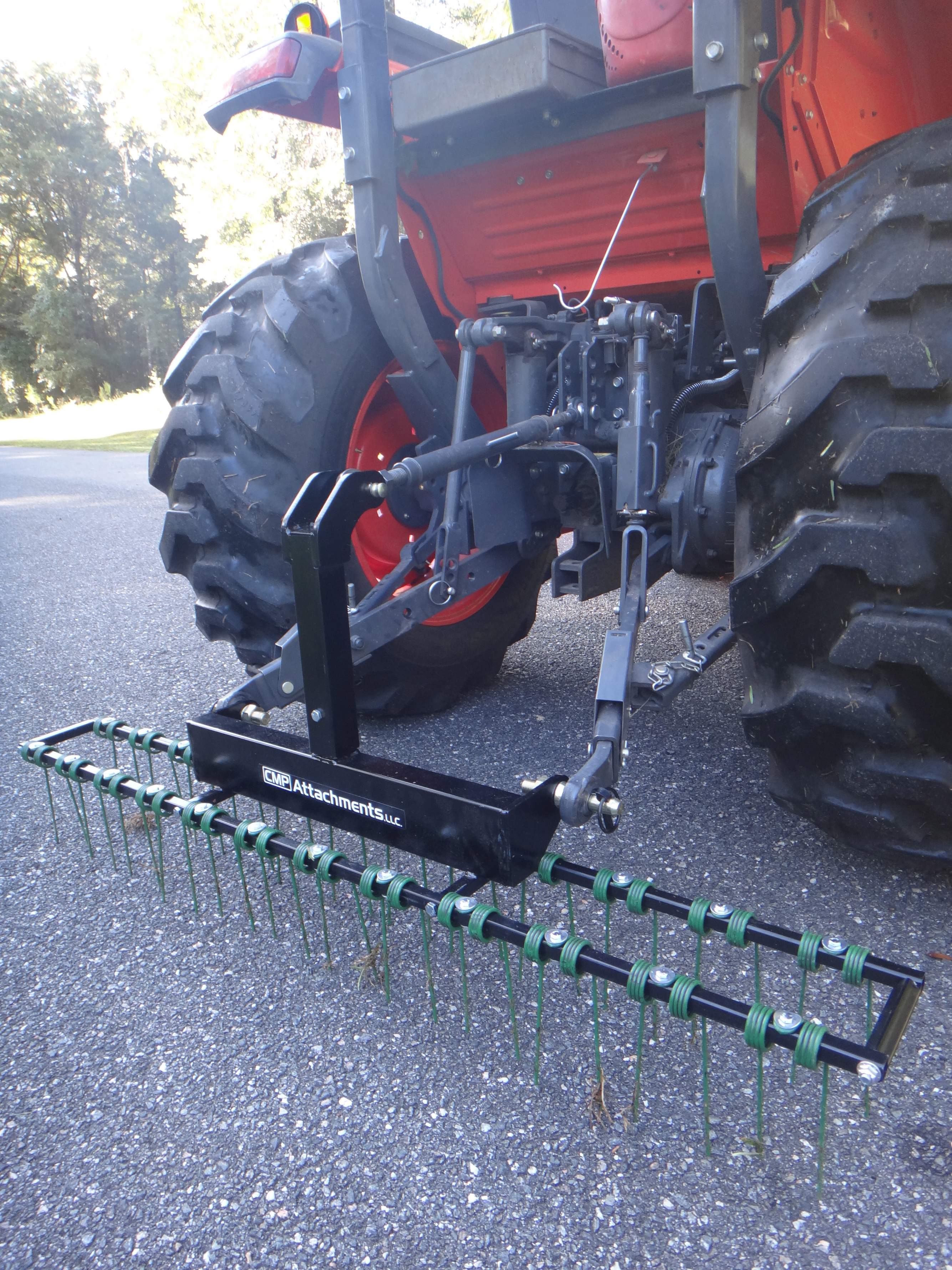

The Lower Links on your Three Point Hitch are raised and lowered by Lifting Rods on the right and left sides.
At the bottom of each Lifting Rod there is a stirrup, which has two adjusting holes on the right stirrup and three adjusting holes on the left stirrup.
See if the lower hole has been selected which allows your subsoiler to start deeper in its default position. This is a pin adjustment. Changing holes will make about 4" difference to subsoiler penetration.
Photo: Pins/Ring Cotters secure stirrups in lowest position to allow Dethatcher max down pressure.
Great advice jeff.
We've ran into this plenty of times, most often with post hole diggers.
The lift arms/rods are frequently sent from the factory in the uppermost or lowermost positions.

Which of your tractors has the Three Point Hitch in the photo? What year of production?
Obviously, no stirrups on the Lifting Rods.
