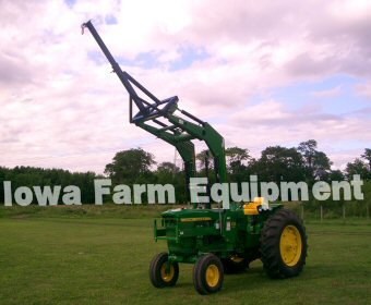

How high to you have to lift the trusses? Could you use a boom on a FEL or backhoe?
Iowa Farm Equipment -- MDS Skid Steer & Front End Loader Telescopic Boom

The barn will be two stories so the peak of the trusses will be about 28', which means the lift has to be at least 30' to accomodate a sling. I made a boom for my FEL that I used to lift trusses on my last building but it isn't high enough.
