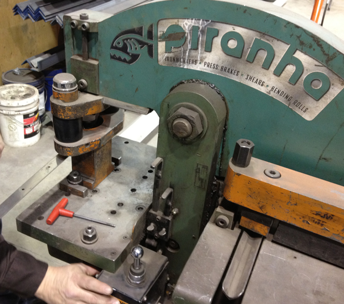

Here's something interesting. It's punching small holes in a stainless strip in this pic that I used for holding the plastic fender skirts on my cab. Pretty sure the guy in the shop said it'll do 1" holes in 1/2" steel. Other parts of the machine can chomp off large angle and flatbar. There's even a jaw at the other end that can act like a big nibbler.
