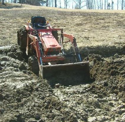

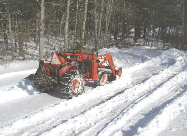

Chains all around on a Kubota B7100 with turf tires. They worked well in snow and mud. :D:D
