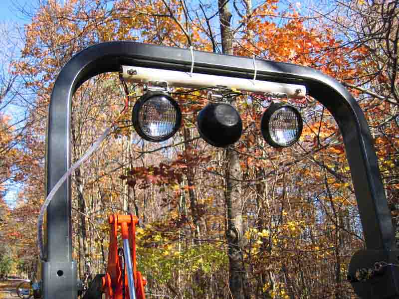

I used Av8r2230's post for my project guidelines.Work Lights
I used round Speaker brand 35Watt lights with built in switches ($26ea). Mounted two forward and one rear facing. Used a 30A auto relay to tie into the headlight switch, yet I have the option of selecting individually which lights burn.
Some of the wiring was not as neat as I would have liked, but in the short run I was unable to loacte the appropriate multi-pin connectors, so everywhere I spliced in, I created a Y-connection which added to the bulk. They make splice connectors, but they are not weather protective. I used insulated connectors and heat shrink tubing at every joint.
All in all though, it is relatively neat. I am attaching some photos (may require multiple posts). Take a look and see what you think.
Regarding tapping into the ROPS, I am a mechanical enginneer (20+ yrs) and agree that it will not negatively impact the structural integrity or safety.

Close up frontal shot.

Rear view - bracket and wiring.

Lower wire feed.
