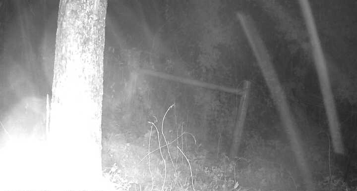

Did you catch the action on the trail cam?
Haha, not really. It's pretty low. We were trying to see what was digging under the fence. We did see deer fairly regularly.
Here's what was probably the break or close to it.

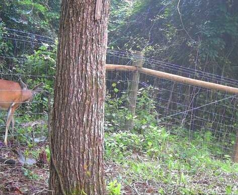

Deer from about a week earlier.
