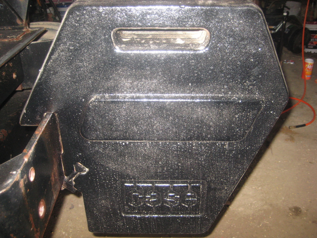

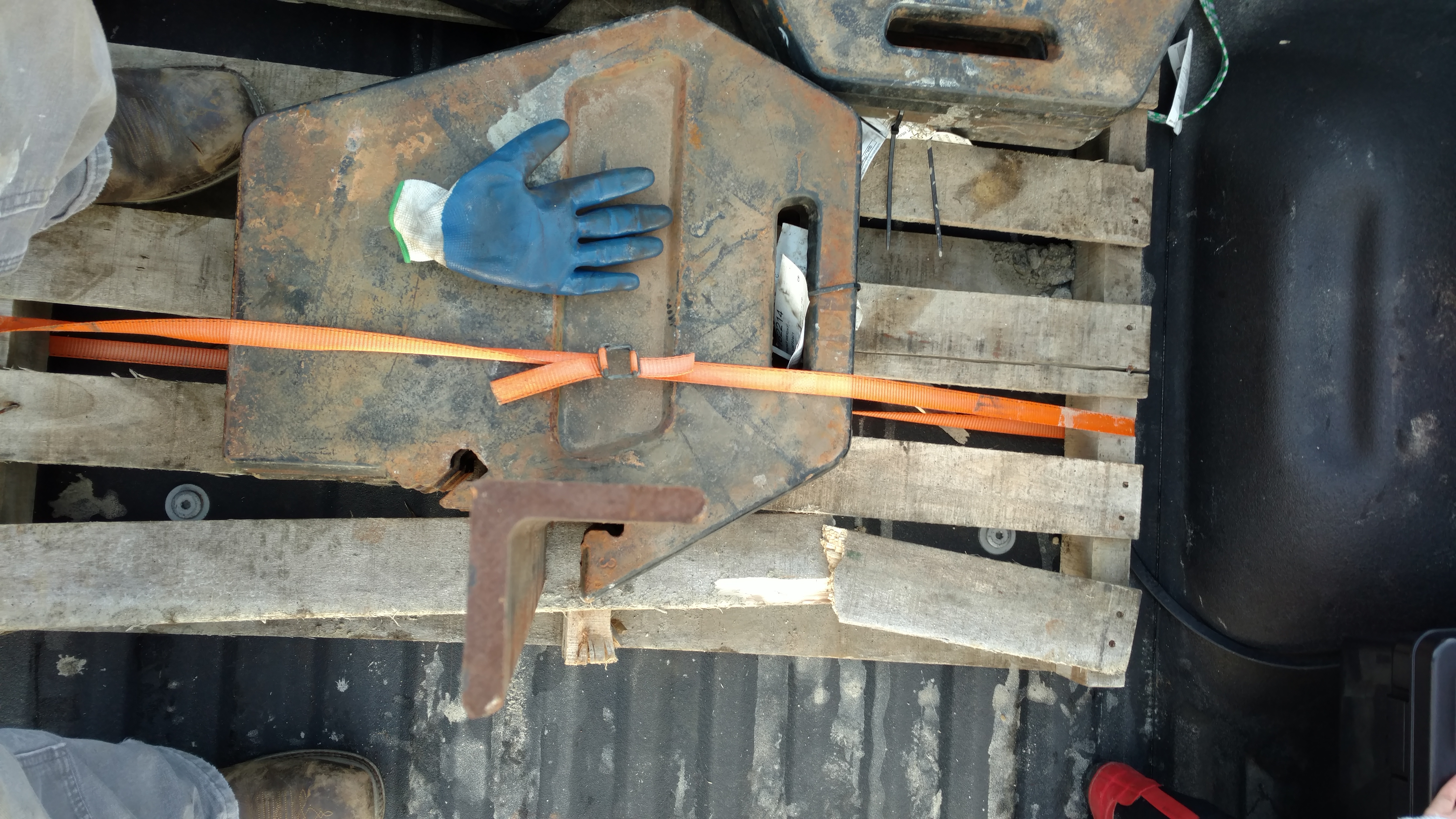

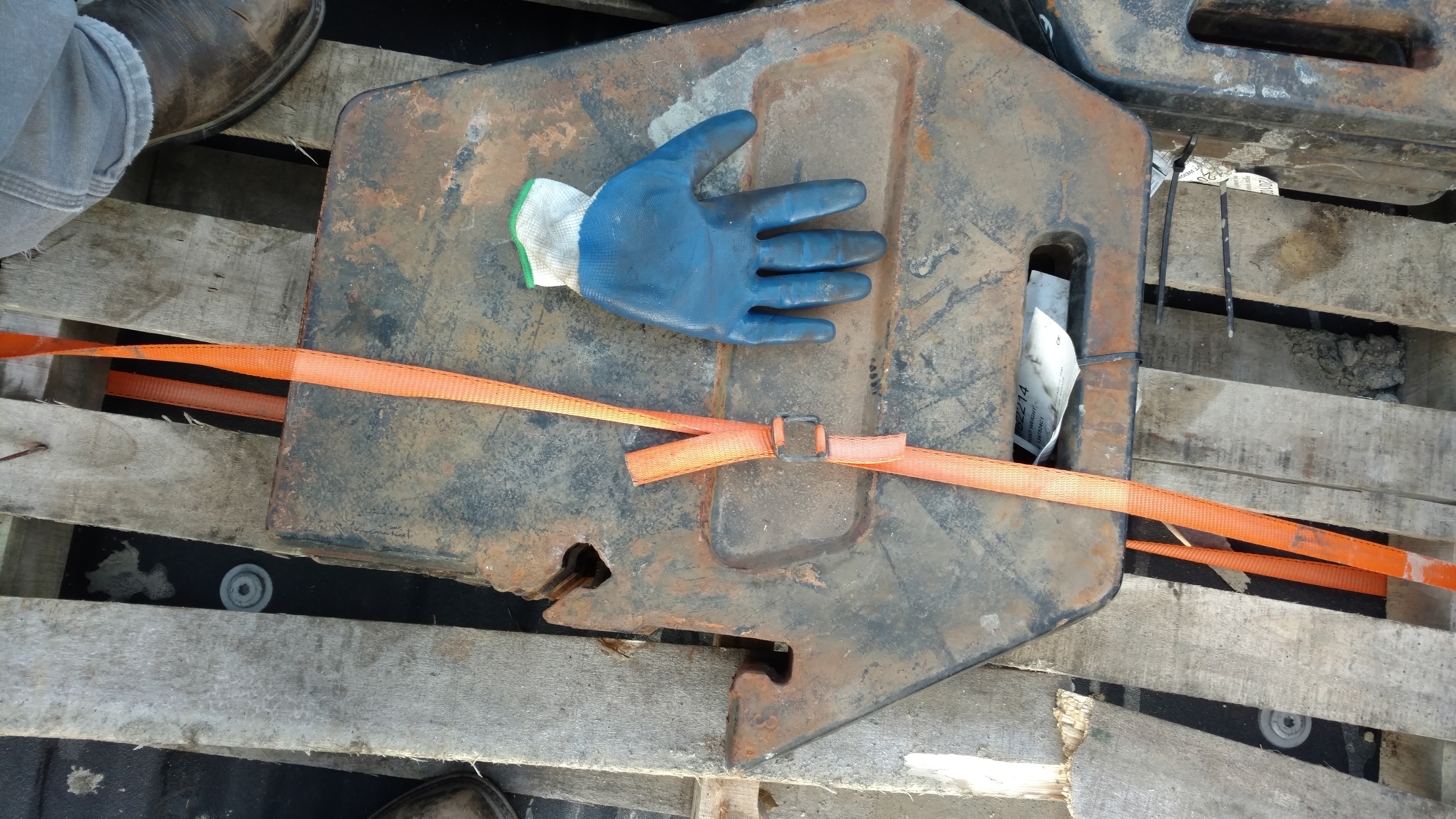

I scored some Case suitcase weights today and want to build a rack for them.
Is it really ok to hang them from some angle iron?
Does not seem like much cast iron holding that weigh while bouncing up and down.

Figure out what they go to and see how they were mounted. All of the weight isn't borne by the angle iron (it could also be a casting) but by pivoting against the bottom of the weight bracket and mostly just retained by the angle iron (or casting). See what the weights were on by searching "tractor weights in Texas" and comparing pics. There is a company there that sells knock off weights and has pictures of most weights. After you find out what they are off of, search the net for pics of weights on that model tractor and the mounting will be displayed. It's OK to hang from angle iron if they can also rest against something.

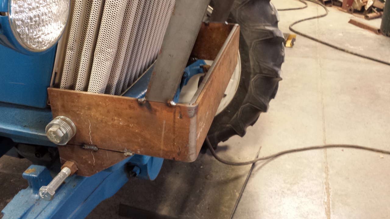

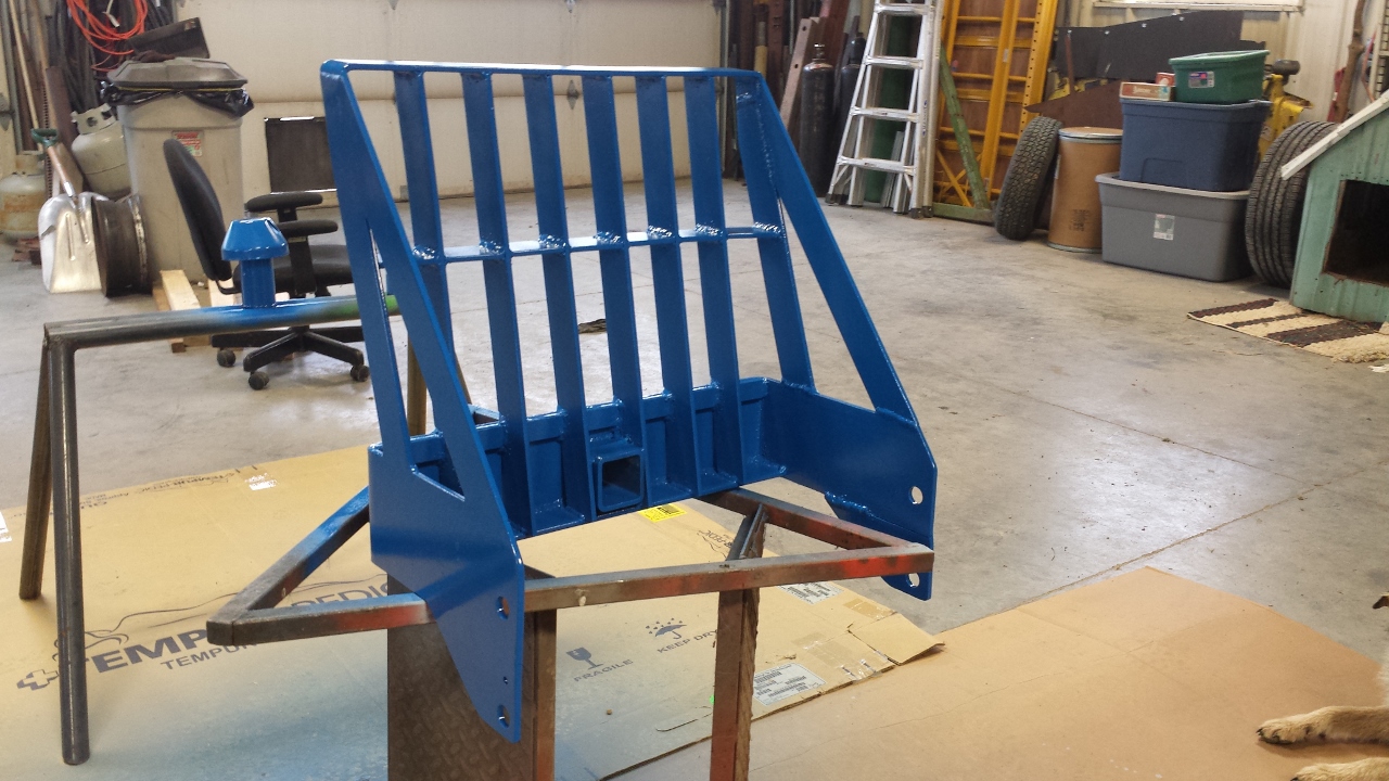

We've always kept suitcase weights whenever we sold a tractor. Here's a bracket I had to fab up up for the front of a Ford.
1/2"x6" flat bar was used. The weights are 120 pounds each IIRC.

The one that Big Barn just showed is how it's done. Just like that.

Make a bracket that looks like the one above and it will hold it just fine.

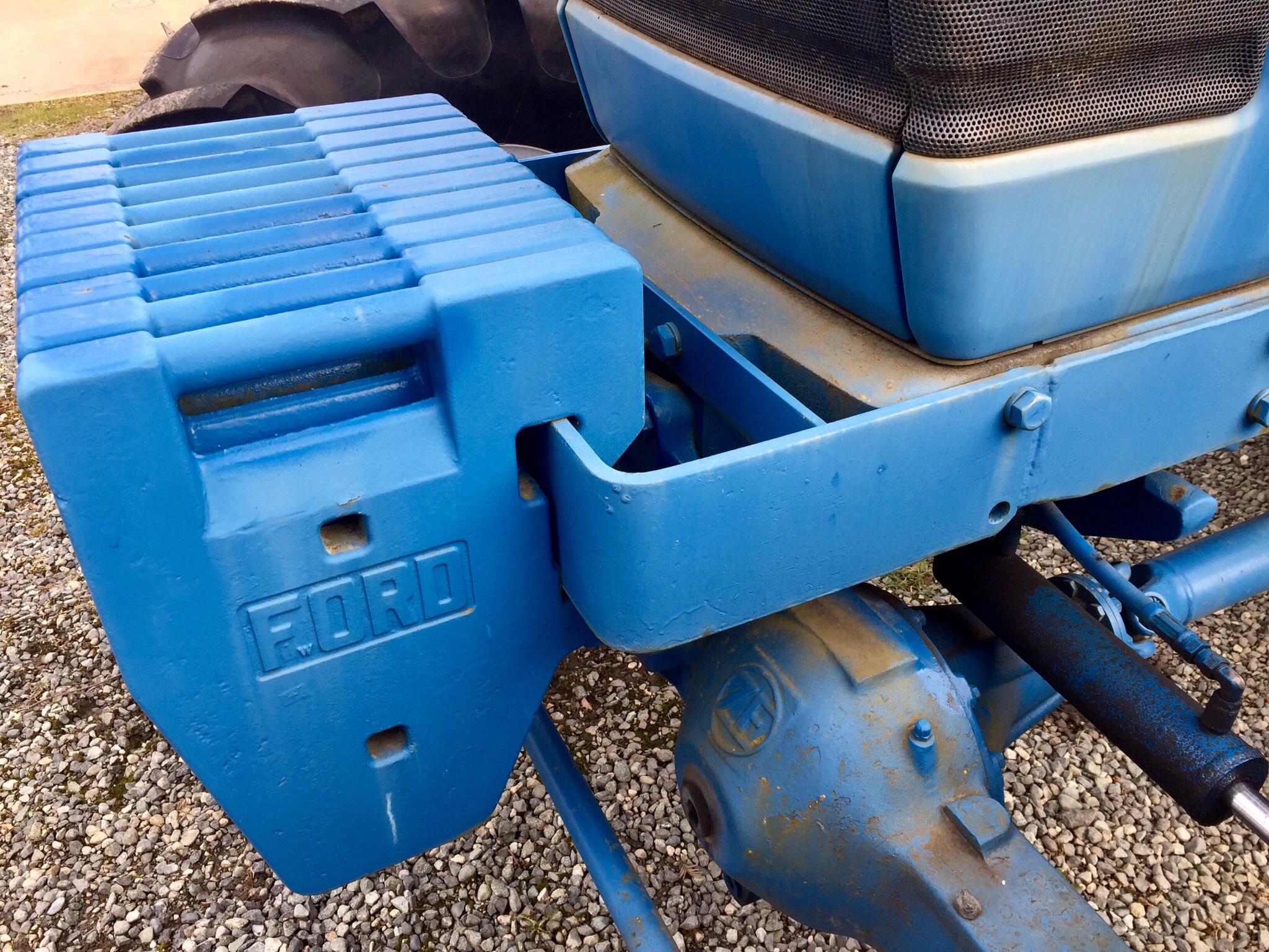

Here's a better picture of the weight on a bracket. It looks like there is a secondary clamp in the bottom angled slot.
Tractor Accessories - BAAH Farm Repair
Very nice find and excellent photo.
That shows a bolt pulling the weight and holding to the bracket. Sometimes there is a solid piece of metal with holes in it and it is long enough to go through all the weights and sometimes it a washer kind of thing that you use individually. Sometimes I don't bolt/clamp them down and I have never had one come off.

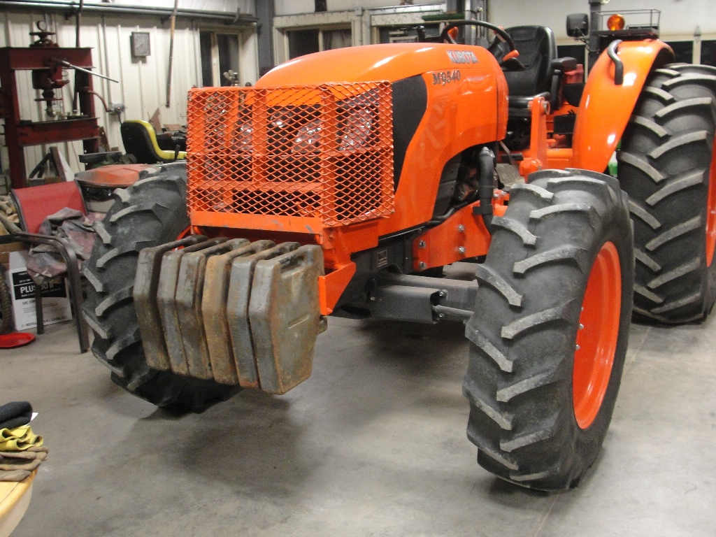

Great example right there!!! That's how I built my weight racks as well. I don't use any bolt mechanism to hold them in place. If you were running your tractor over very rough ground with speed you might want something. Even if just a strong tarp strap making them swing as one.
I incorporated my rack into the factory grill guard base on the Kubota.

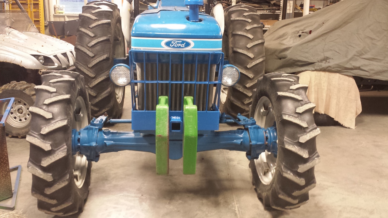

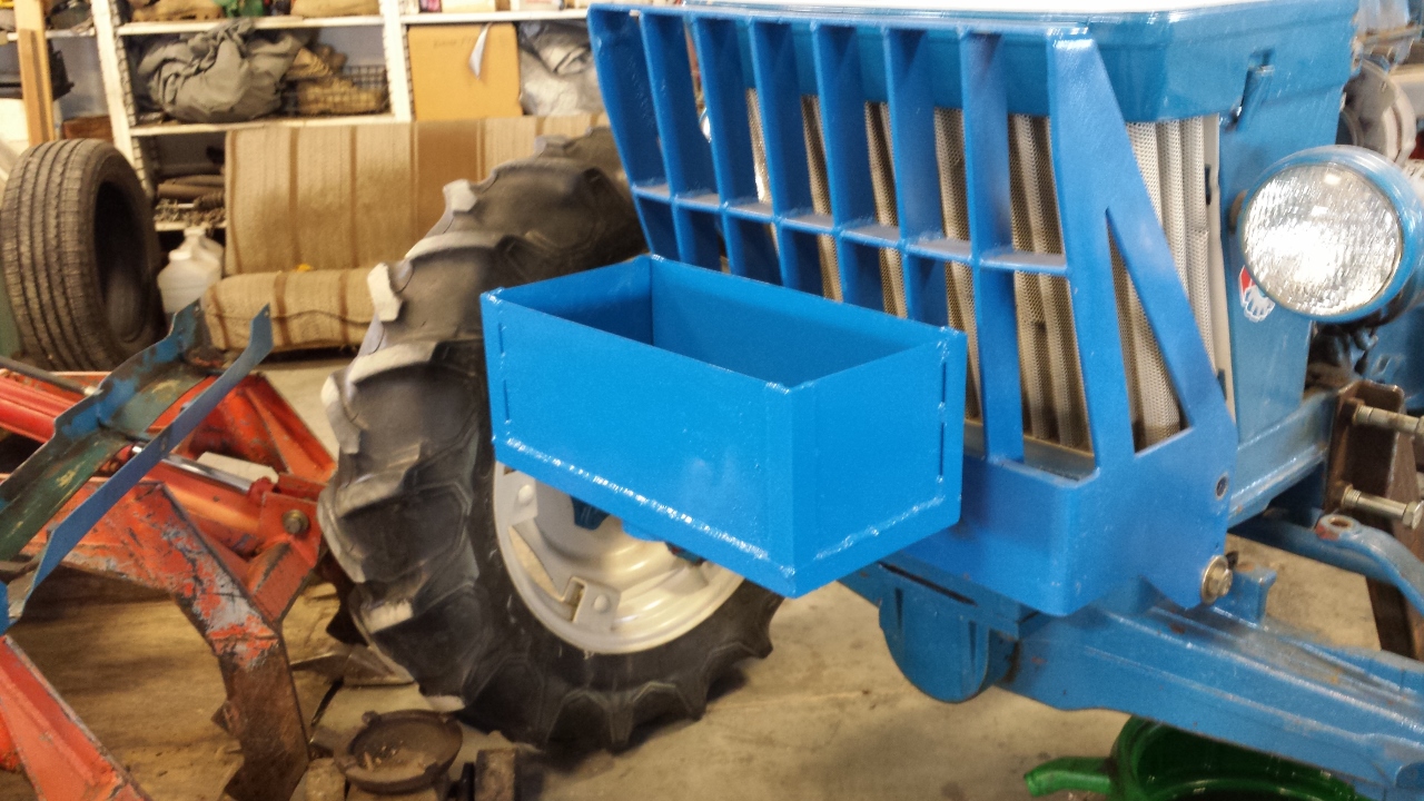

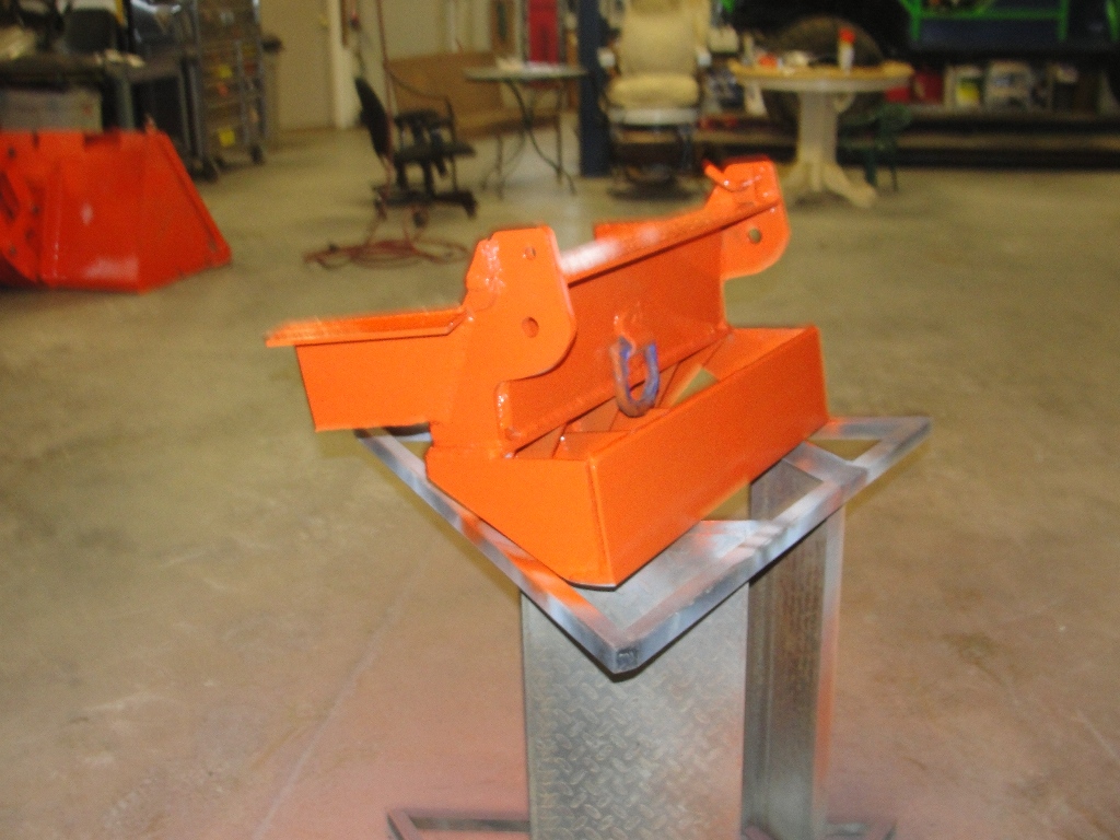

On the Ford I had to build the entire grill guard assembly so incorporated a weight rack at the same time. Didn't have any 1/2" thick so used 1/4" and added an additional 1/4x1" flat bar at the top.
Made the slots between the guard uprights the right distance apart to accept weights.
While I was at it I added a hitch receiver. Then built a chain box to fit in the receiver when I'm not carrying a full rack of weights. With the box in place I can still carry two weights if needed.
